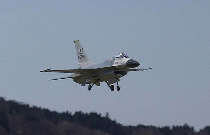

I have been flying with a whip antenna in my F-16, and never had a glitch while airborne...
However, it would look much cooler with the antenna inside the plane - there is not a lot of carbon
in the nose of my plane, and I was thinking about routing the antenna all the way forward....
Anyone had any experience with this? I fly all my other planes with internal antennas, but the jet has more
metallic components, so I don't know if it's a good idea?
Take a look at the pictures - it does look better without the whip, right??

I really hate the whip antennas. You spend hundreds, sometimes thousands of hours perfecting details, and then you have that big old ugly antenna coming out that makes everything look like a toy from Toys'R'Us (just look at Wolfgang Klührs MiG.......perfect, except.......).
I had my sabre with an internal antenna without any range problems, and it looked great. My F-15 will have it internally as well, running up inside the stab.
Just get it away and clear of carbon components, they severely shield off any signals that are coming in. Another thing that really helps: make sure you can "see" about 50% of the antenna no matter what angle you are looking at it. That way you will get consistent range from all angles without "dead spots" and "unlimited range spots". (My main worry with whip antennas is that when looking straight from the top you get almost 0 projected antenna area, thus least range.....yet you usually have exactly that attitude when you are furthest away, turning back inbound!!! Range checks on the ground hardly ever feature "top view").

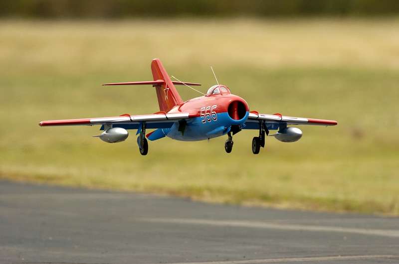

As usual, seems like everyone has his view and is willing to stick to it...
I think it would be crazy not to have an aerial if there is carbon fiber in the plane.
High gain antenna is not even a solution for me.
The best I've seen so far is the two antenna on the Mig15...
How are they hooked up on the receiver ?

I would not dare to run my antenna backwards to the rudder because of the steel pipe blocking the signal all the way to the rear of the plane!
I guess after losing my last F-16 to an unexplainable radio (?) error I will take the safe way and go with the whip...
T
