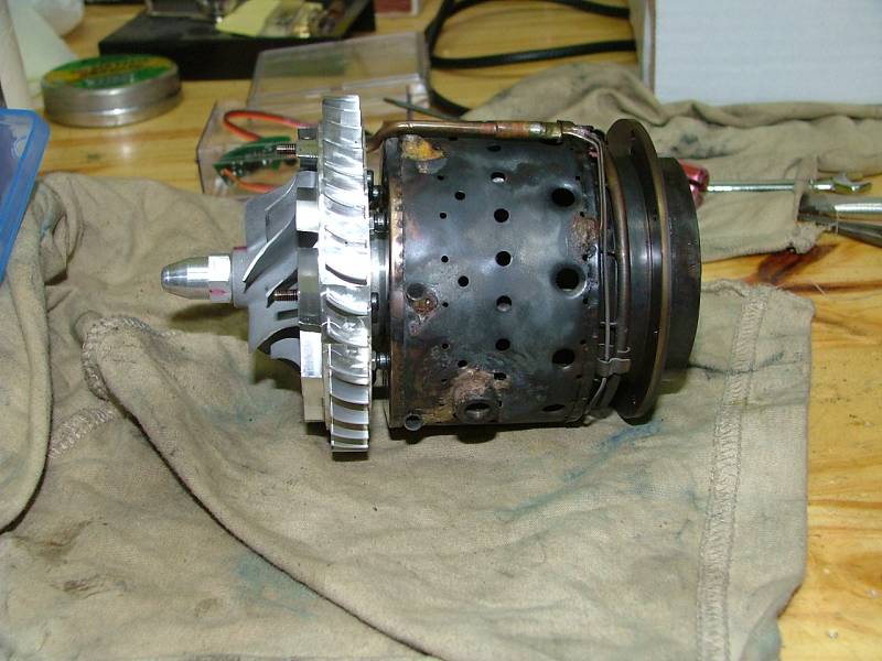

#1083

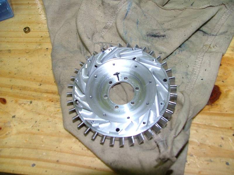

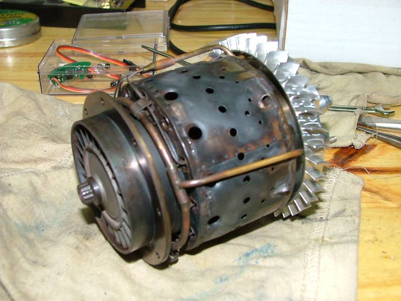

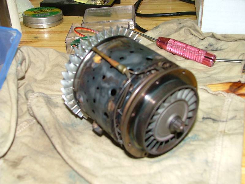

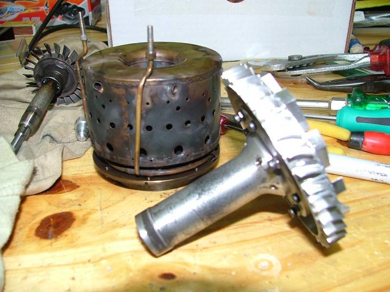

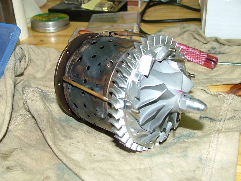

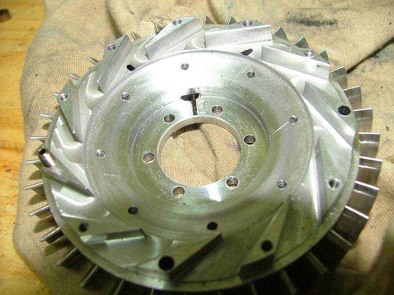

My Feedback: (51)
Guys,
Since sending it across the world back and forth is an option i would like to avoid (if i can), with the help of a few of my turbine knowledeable buddies, we decided to give this a shot. we decided that if this engine is sold as a kit, we can do it too.
This is where im so far with the tear apart, havent taken out any of the really interesting parts though. Anyone care to give some instructions from this point on ?

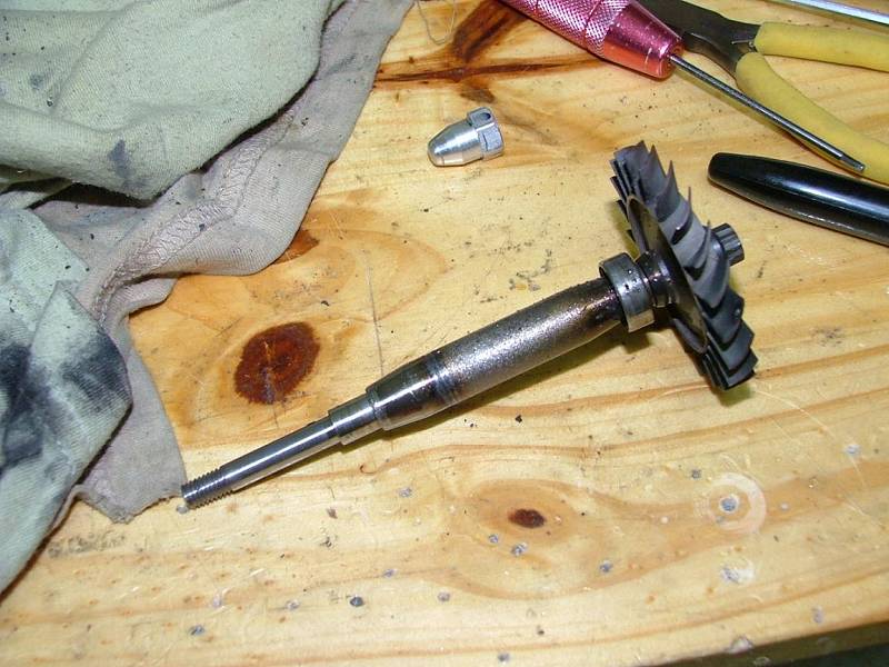

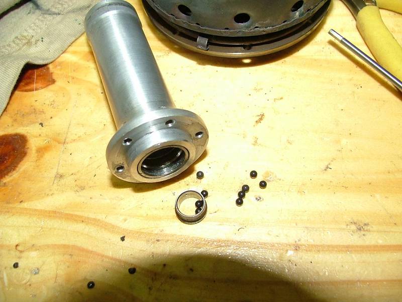

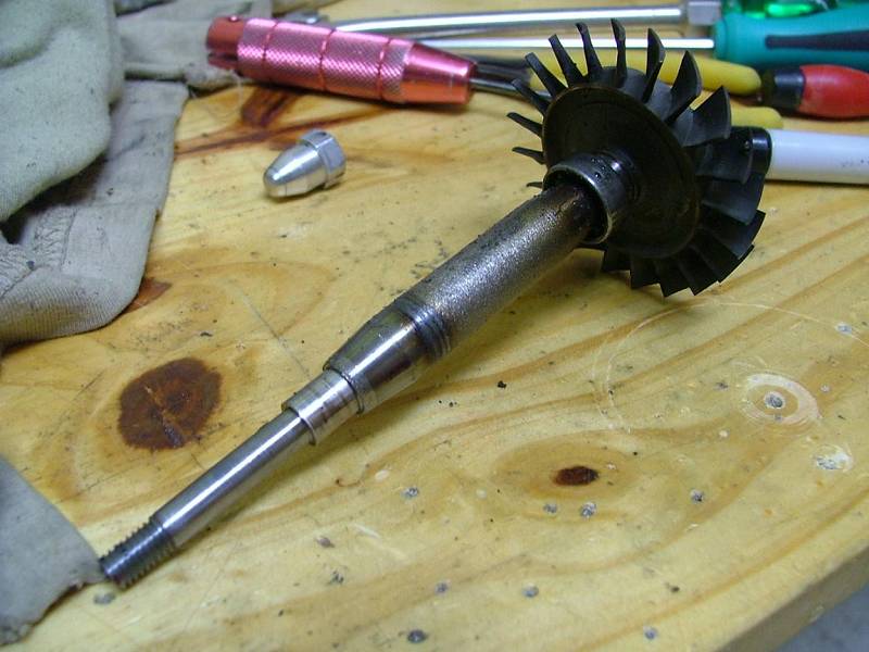

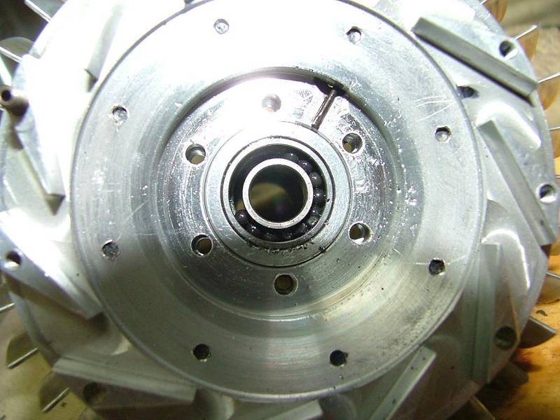

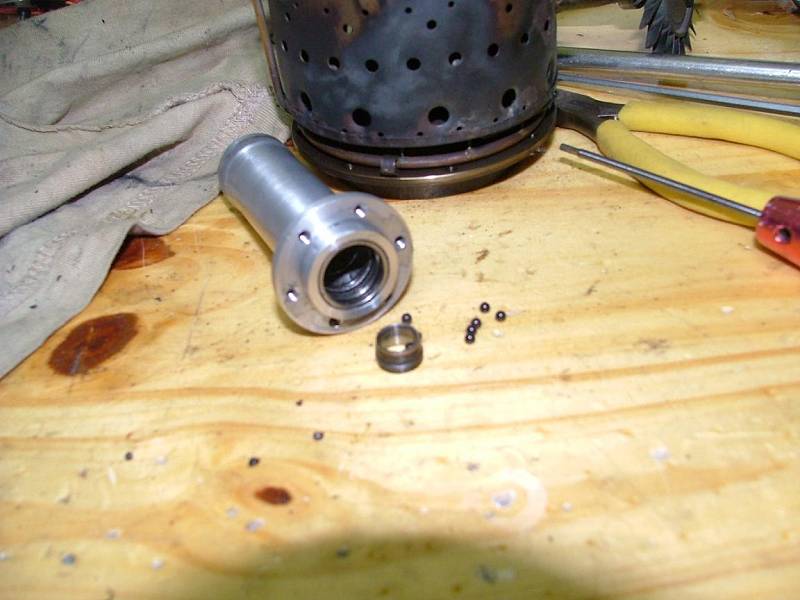

#1091
My Feedback: (51)
Well guys, patience is a virtue, but so is basic engine technical skills.. Hehehe
Honesty.. disassembly was easy enough.
Anyway, i got the turbine apart very safely (marked all the parts positions before i did) and i found the culprit !! the front bearing is messed up so bad that all the balls were loose in its cage and with the slightest touch of my hand completely crumbled and fell out. it also made a nice notch on the shaft, and threw shavings all inside the engine.
Watch the pictures and behold in amazement. im sending JJ these pics as well for them to asses the damage and advise of a fix.
Honesty.. disassembly was easy enough.Anyway, i got the turbine apart very safely (marked all the parts positions before i did) and i found the culprit !! the front bearing is messed up so bad that all the balls were loose in its cage and with the slightest touch of my hand completely crumbled and fell out. it also made a nice notch on the shaft, and threw shavings all inside the engine.

The rear bearing of the JJ-1400 is GRW, but the front bearing is a different brand (information from Joe). I have a JJ-1400 that has just done the same thing, although I have not taken it apart yet to see what the problem is.
#1098
I3DM,
I agree with Hendrix. It is best to send it back and have JetJoe 'service' the engine. I had teething problems with my JJ1400. So, I contacted JetJoe and they advised to send it in. I did, and it runs like a top now. They had some teethig problems that they worked out. When they sevice the engine, they corrected as many as possible. Hence, I ended up with an engine with all the latest improvements. It was well work the cost of postage.
DW_Crash
DW_Crash
#1100
My Feedback: (51)
Yes i am sending it all back to Gabe for service, Gabe has already seen the pictures and advised that a new motor is in order in this case, since all internal parts are damaged to some degree from the bearing letting go at 160K RPM.
Now how is this for service ? i give Gabe a huge two thumbs up yet again - this guy is unbelieveable !! [8D]
