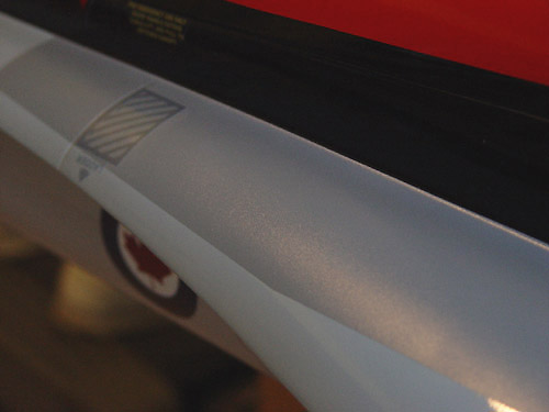

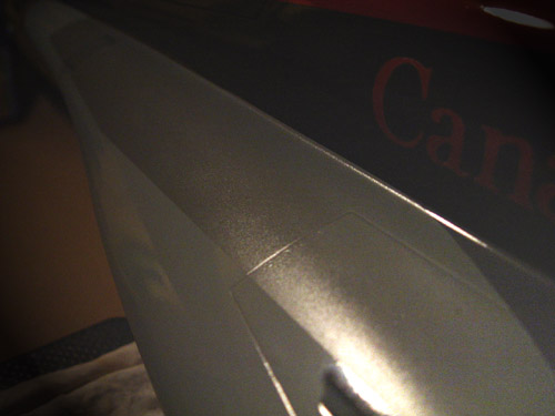

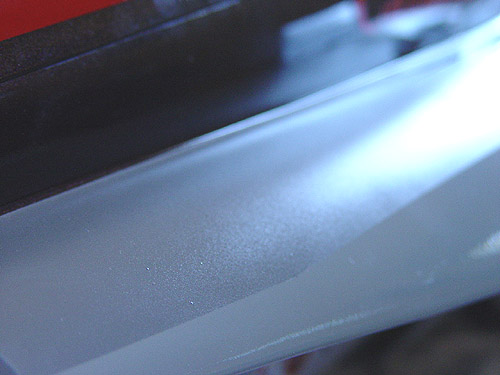

To the best of my knowledge full size walkways are usually non slip paint, so I use paint also.... easy to reproduce! best method I have found is use higher airbrush pressure and less paint mixed a little thicker then apply paint in light coats until desired effect build up is achieved. You will end up with a dry orange peel looking effect, sort of oppisite of what you want when painting a model
just remember to experiment with varing degrees of air pressure until paint is going on near dry....
heres a couple of pics I just took of the walkways on my CF-18 applied using this method. Sorry about pic quality as flash tends to washout the detail but pic without the camera flash on you can see the texture much better and I think you can get the idea.
just remember to experiment with varing degrees of air pressure until paint is going on near dry....heres a couple of pics I just took of the walkways on my CF-18 applied using this method. Sorry about pic quality as flash tends to washout the detail but pic without the camera flash on you can see the texture much better and I think you can get the idea.
Heres a couple more pics of my CF-18 walkways with better lighting... You can see the texture contrast much better in these pics I think. Another good reason to use the paint method is you can customize walkway colours of course, but the best reason to do it this way is its scale

so I tried the paint sprayed towards the dry side of normal method, came out well not too rough just right
So thanks Marty

Hi Ian glad you found the painted walkway suggestion worked ok for you.... Do you have any pics of how they turned out?
Iam just about to start painting my Fiber Classics Mig 15 and will use this method again for this particular model...I also use Humbrol paints a lot for detail work and weathering, they are great to work with and have great coverage (high pigmentation).
Another good reason why I like this painted process for doing my walkways is I can lay a silver (aluminium) base coat colour down in the masked off walkway area prior to colour top coats and buff through using 1000 grit wet and dry paper later on to reveal some worn areas this finishing method for walkways is also ideal for many WW2 aircraft and of course the Mig 15
