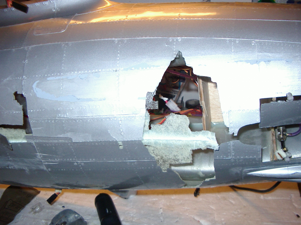

Default RE: COMPOSITE ARF MIG15 FIRST FLIGHT

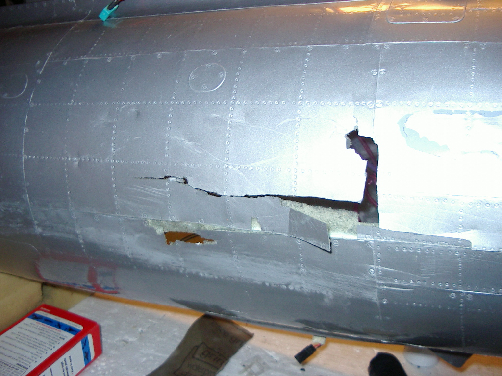

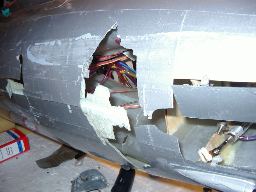

can you help me for info how to best repair a fuselage of mig.....
is very light thikness..
Old 06-14-2005 | 11:17 AM
JET FX's Avatar
Posts: 1,998
From: Sydney, , AUSTRALIA

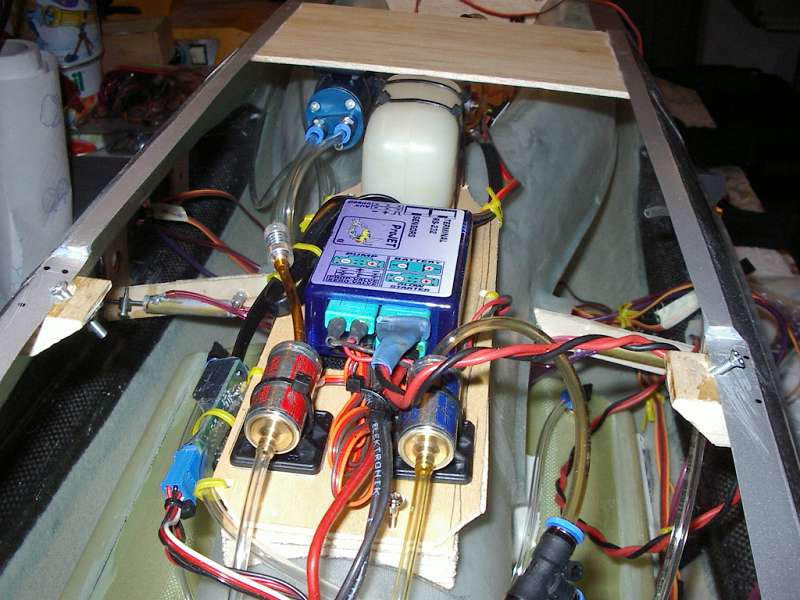

Christian, I will gladly send you paper template tracings of wing fences to address you posted as I do not have access to CAD myself. My Migs CG is as manufacturer suggested @ 50mm in front of rear spar and seems just fine as is... Just curios as to how much nose ballast you had to add to get CG with TT-66, with the Super Sport I added 700grams of lead shot to achieve balance. Also how did you set up outer gear door linkages? any pics, just to compare methods
What sort of repair?? do you have any pics?

Hello...I added 1kg of ballast in the nose!!! but i have not a complete cockpit and other parts...
but for me 50mm is not right, maybe 40mm...i will try
Today i send you a pics of "damage"
thank's for drawings..
ciao
Christian
Old 06-15-2005 | 06:23 AM
Joined: Mar 2004
Posts: 1,567
From: ferrara, ITALY
VARIOUS PHOTO

Old 06-15-2005 | 08:05 AM
Joined: Mar 2004
Posts: 1,567
damage photo!!

Old 06-16-2005 | 04:41 PM
My Feedback: (31)
Posts: 663
From: Bowling Green , KY
What Happened?? Looked like a beutiful airplane. There was a thread on the net last fall about problems with the gear retracting properly. Have any of you encountered this. I really have liked this plane especially since they dropped the price. Russ

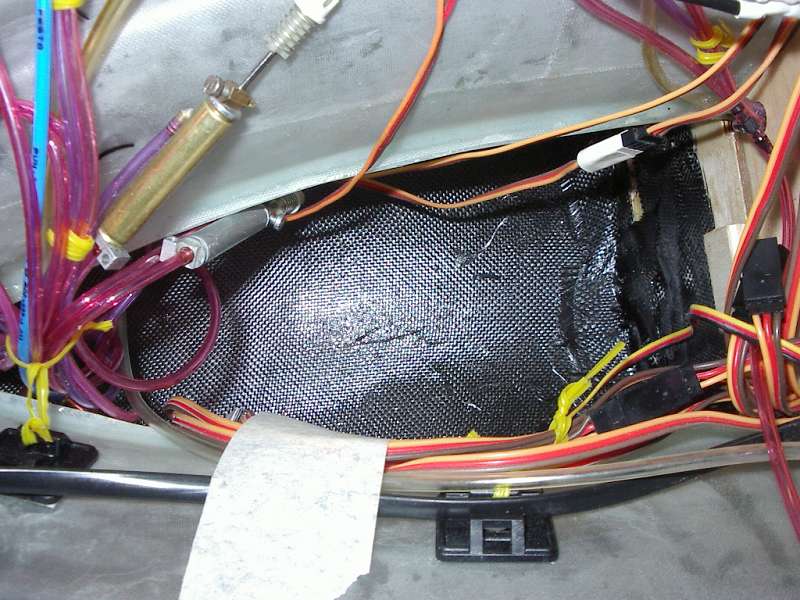

Old 06-16-2005 | 05:09 PM
JET FX's Avatar
Posts: 1,998
Christain, re damage repair method? I would use thin plastic sheet sections carefully and well waxed (Turtle wax on inside surface) then place sections of plastic over open structured area held down and firmly in place with small dabs of Zap etc. also then wide masking tape as well. Then lay new glass cloth/epoxy from inside once cured remove plastic and ad new rivet and panel line detail. Hardest part will be removing internal gear to fully access repair area....
Re- gear never had any problems with the gear on my Mig?? works like a charm.... that said my one is an early Fiber Classics not Comp ARF. The early Comp ARF stock wheels are usless as they do not fit at all into wheel wells??? You can either fix that by just using BVM Mig wheels or even replace with the new Intairco wheels or complete landing gear system....
Andrew Coholic took this cool pic last weekend of my Mig 15 in action at 'Bay of Quinte' its definetely my new favorite jet to fly
Old 06-17-2005 | 01:14 AM
Joined: Mar 2004
Posts: 1,567
the damage is a result of my error in final landing..!! (sigh!!)
the speed was too slow an model stall...my mistake because
I believed tha model was very fast in landing approach but the wind in front and
air-brakes STOPPED the mig..!!
was not a gear problem...
thank's for your info..
christian
Old 06-20-2005 | 09:02 AM
Joined: Mar 2004
Posts: 1,567
damage repair

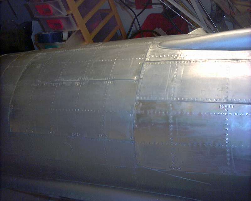

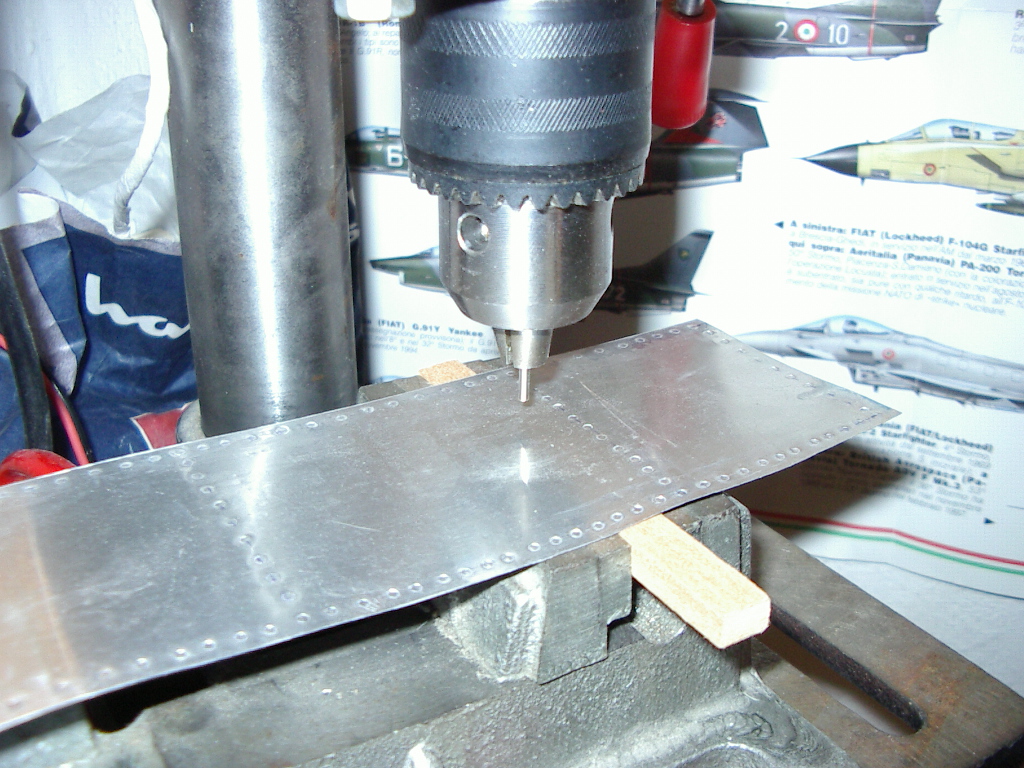

Old 06-24-2005 | 01:13 AM
Joined: Mar 2004
Posts: 1,567
DAMAGE REPAIR PART.2
Panel and rivets!

Old 06-26-2005 | 11:59 PM
Joined: Mar 2004
Posts: 1,567
panerand rivets END WORKING

Old 06-27-2005 | 05:45 AM
schroedm's Avatar
Posts: 5,193
From: SevenoaksKent, UNITED KINGDOM
Great repair job Christian!
