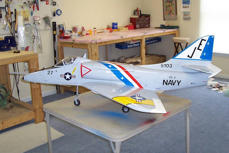

Finally got it painted and almost ready to fly. Only trouble is I have to go overseas for at least a year. Oh well, I have something to look forward to...........

Very nice, whats in her for power?

gotta love a NICE looking scooter. good job.
hope she flies as nice as she looks.

I would love a workshop like that. Yours looks brilliant

Thanks for the comments guys. It is powered by OS 91 and dynamax fan. After this one a turbine will be next.....

which kit is that???? i recently aquired a Trim A-4 second hand for $1000Au dead cheap with everything in it incl. Rx!!! just need to find the location of the CoG n surface travels...

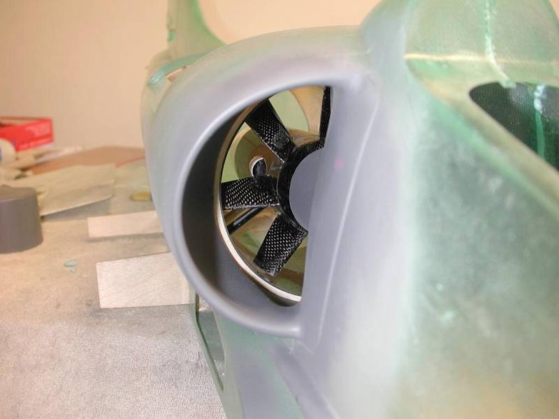

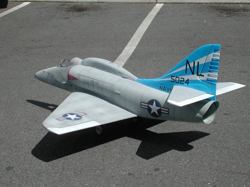

Here are a couple photos of my Yellow A-4 I just finished building. It's all decked out with rivets, weathering, and painted on markings. It is converted to electric. The fan and motor combo produces 14 pounds of thrust and the AUW is 11 pounds ready to fly. I am waiting on a heat sink for the motor so I can get it maidened.

What fan and elec motor combo would that be??

Hey Tomcat,,,the A4 is a Yellow Aircraft kit. ...

The fan is the 5 inch carbon fiber WeMoTec HW-750 and the motor is a Lehner 2250 13 turn. The batteries are the new Thunder Power Pro-Lite series. I am using two 5S4P packs connected in series to get 10S4P and 8000mAh. Electronic speed control is the Hacker 90A. The numbers from the watt meter are 88A and 2580 watts. The fan is turning approximately 31,000 rpm.
