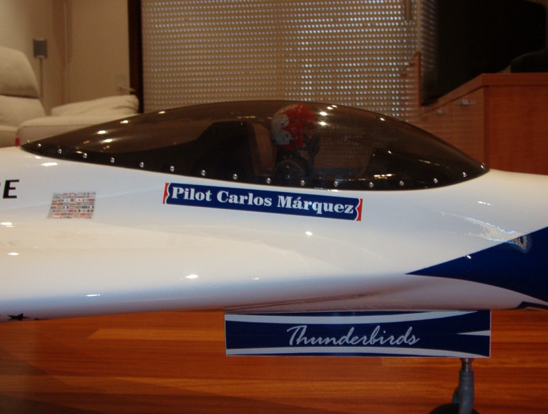

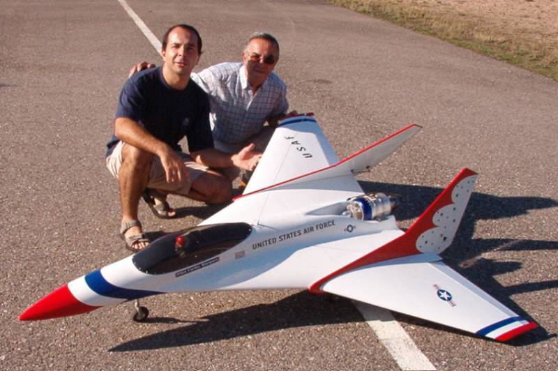

Hello:
I my last Hotspot I am installer the Skymaster gears, intairco struts (Robart would be best and Eurokit wheel brakes with rubers of JetPower. Perfet set.
The landing gear of Eurokit is only for the very best landings. No is strong enought.
I send you a photo of my Hotspot in Tuhnderbirds finish.

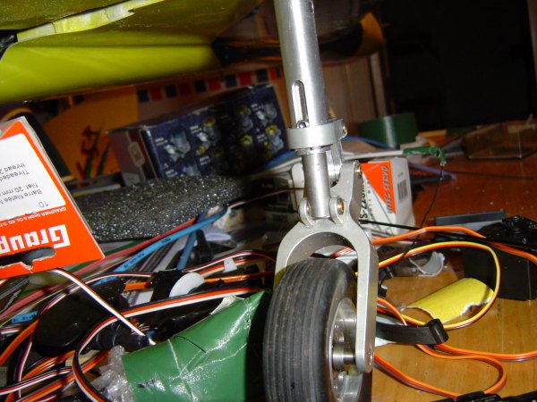

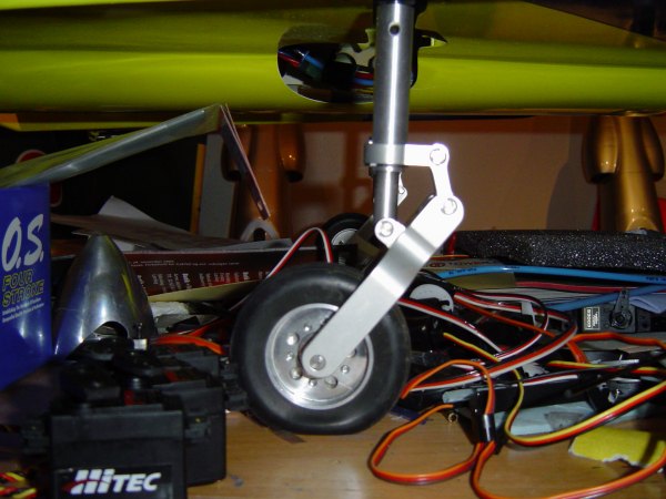

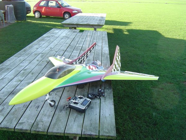

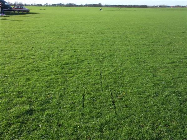

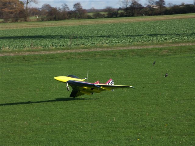

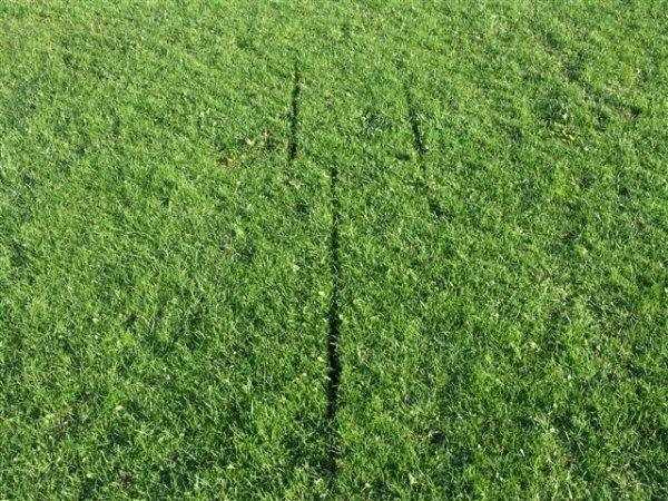

hehe, I guess Im the only one with good experiance with these retracts.
I flew my hotspot of grass fields, and have made some very bad landings where the 6mm hardened steel joiner pins just snap clean off.
Even the plastic housings held up to this.
I think my succes with these is contributed in that I used Behotec trailing leg struts.
These are VERY tough. 10 times better than the eurokit struts.
I have hovered/stalled the hotspot abot 80cm off the field, and then it free fell directly onlt the field onto all 3 gears, and there was no damage.
I have run off the runways, and into corn fields a few times at high speed, with only the nose strut bending a little aft.
In the pics below, you can see the silver behotec struts. The black eurokit struts are of very bad quality. As you can see in the pics of my too fast landing, they snaped into bits
The retract units never took any damage.

cmjets, that's got to be one of the best looking HotSpots I've seen, very nice work.

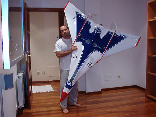

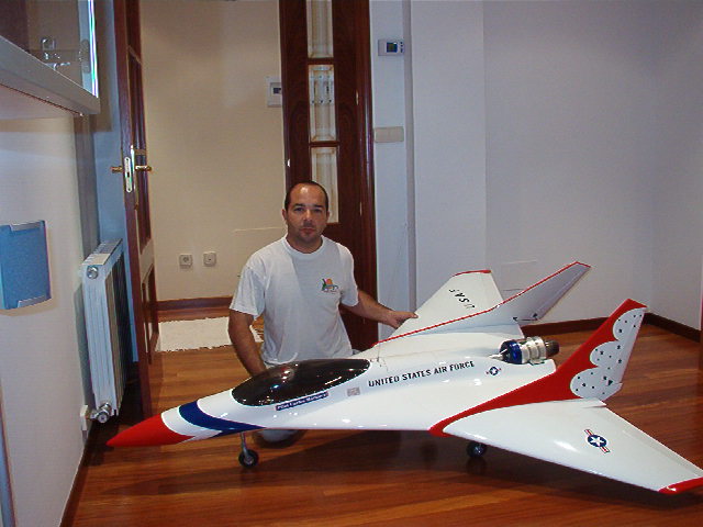

Hello:
Hola:
Thank you very much for yours words.
Muchas gracias por tus palabras
Own desing, adesive vinilo.
DiseƱo propio, vinilo adhesivo.
I put another photos.
Pongo otras fotos.

cmjets, I have a hotspot on the way and If you don't mind I'm going to copy the paint job. Did you paint it? and does it have a clear coat paint on it.
any Iformation would be great.

Hello Angus:
My name is Carlos. The fuselage is painted for get a color more white, but in my last Hotspot I not paint it,(there are a little diferent of colors, but no is important for fly). The wings and vertical fins are covered with Oravover. The rest is vinilo. If you know a place where working the vinilo, I can send you the file in Corel Draw for cut it.

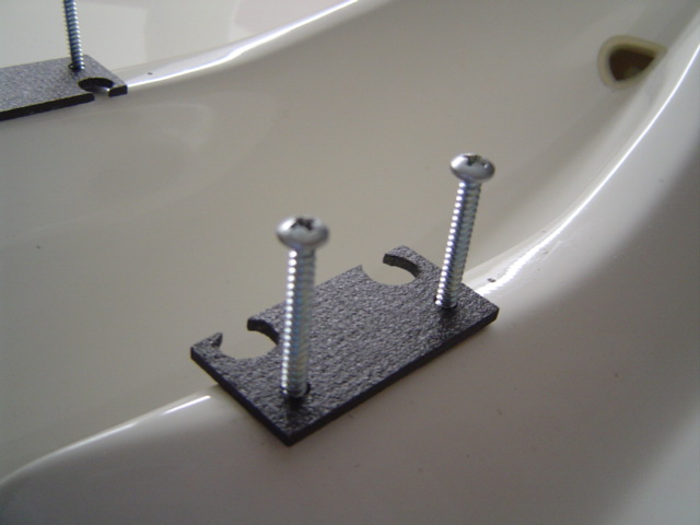

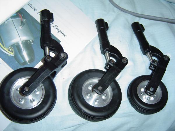

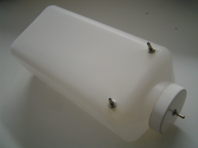

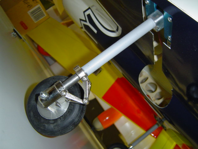

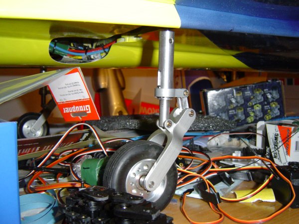

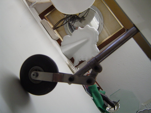

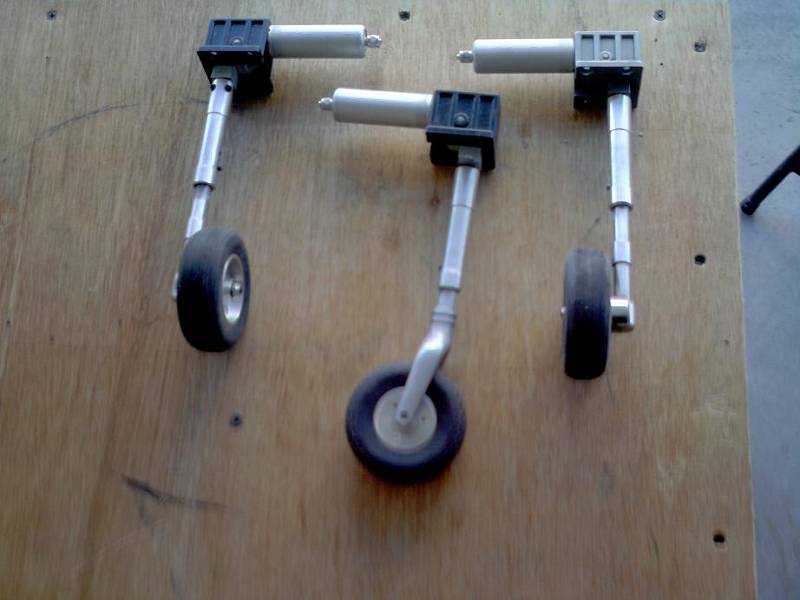

Hello again:
My landing gears, 2.6L tank and the items that I use for mount the turbine, because without this things the turbine no seat fine.
