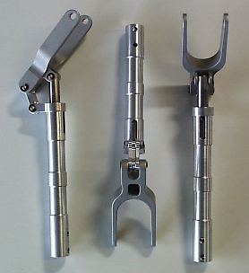

Carlos: have you seen this leg units? they work great.... that is the same to me to say that a lot
of flights are accomplished without wasting time straightening struts.
Best regards, Enrique
(from www.behotec.de)

Very nice looking legs....mmmmmmm.
I will take a look.
Thank you Enrique.
