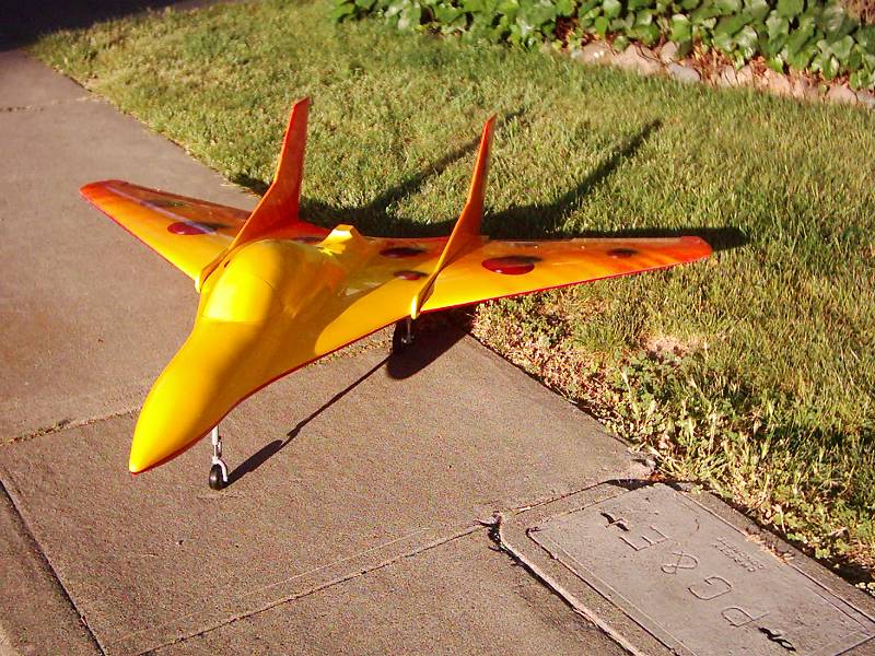

Just a shot of it for you.

This is my new Roo, yeap the one up there, a big thank you to you Mike, Hey man you did some nice work on it, I stopped by Mark's house to see it last Sunday, we made a list of the parts we are going to need to completed her and he is getting some of it and I'm getting the rest from Tam, the goal is to have it done before Fresno.
May be I'll get to see you on Friday, Friday is the pick up day.
Mike Thank you again for the good deal and don't forget, we get to fly her at W/D and did or are you going to take the deal from W/D to fly there for the rest of the year?

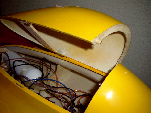

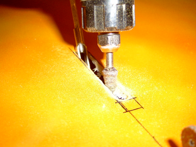

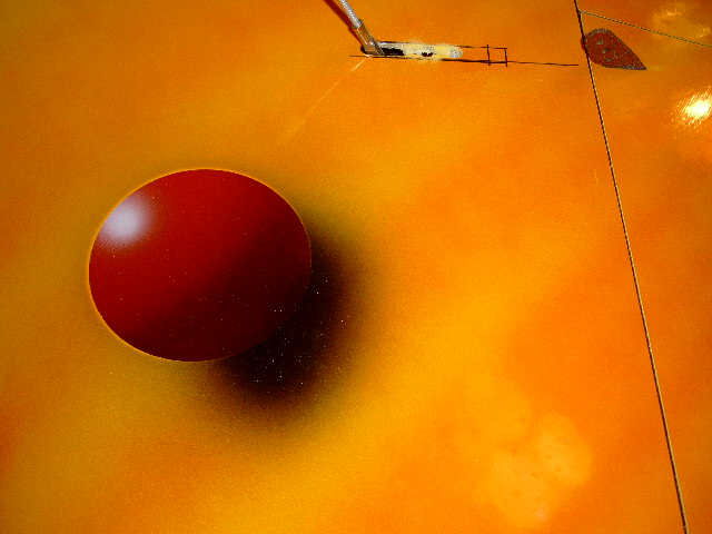

OK.

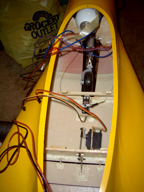

It's 2:50 Saturday in the morning, I finally got some work done on the Roo, wife and kids are in bed and I had a good 3 hrs. of work done, Ailerons are glued and also the gorilla glue is inside the leading edge, inspected the landing gear, not much but it's a start. Tomorrow I'll try to get at least 6 hrs of work, that should move it forward.

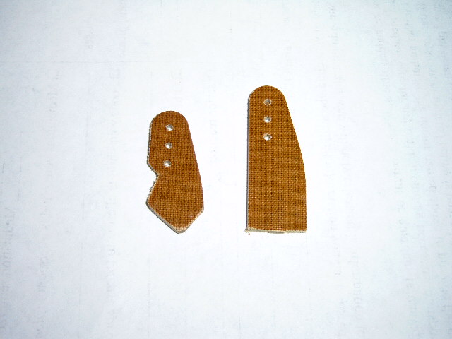

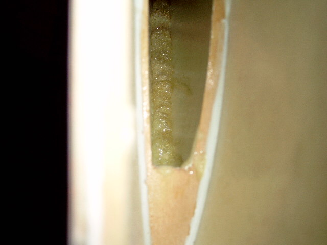

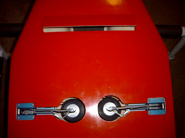

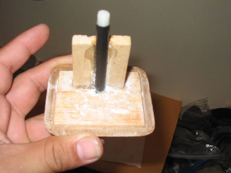

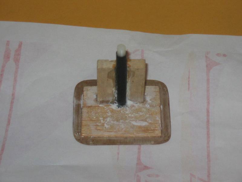

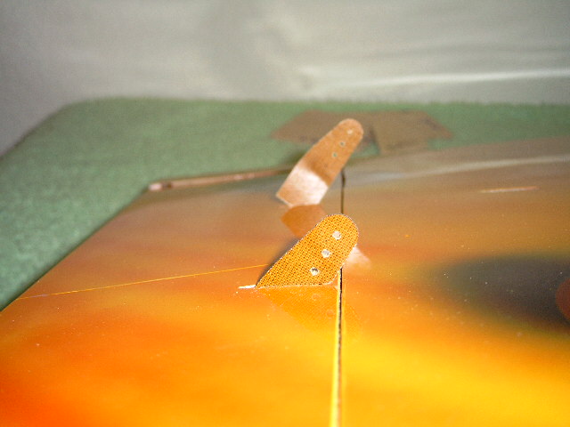

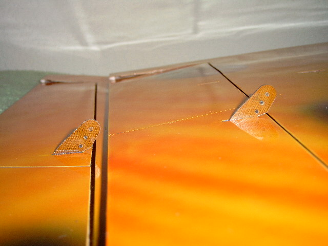

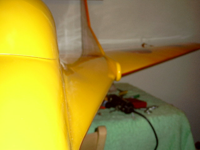

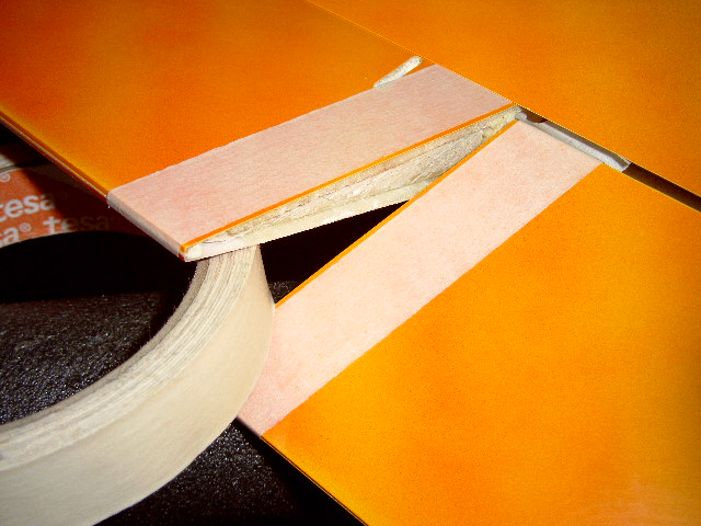

More pictures.
Take a look at how the gorilla glue expands when its drying, I added some in the leading edge 'cause I saw pictures before of delamination at that point, I was going to add glue to inside of the nose 'cause they used to delaminate there too but I notice that the factory added a strip of fiber glass at the join to prevent that from happening any more. Here is some of the cable clips that I'm going to use for my wire installation all came from radio shack.

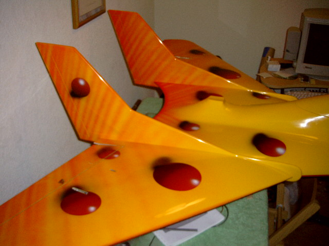

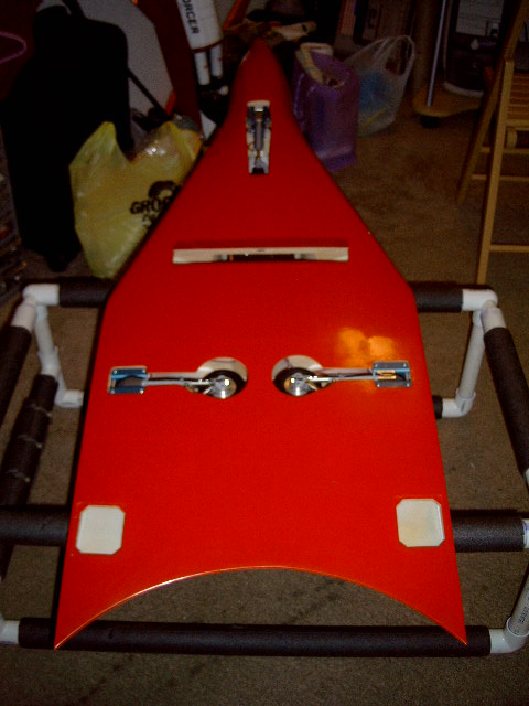

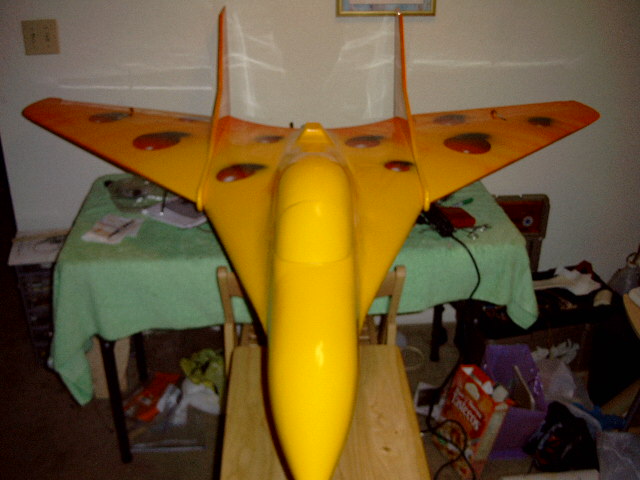

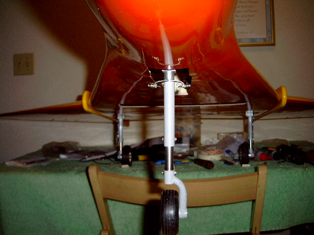

The wings are done, I just need to make 2 new push rods with real hardware, I was missing an alignment brass tube so I just cut one out of a piano wire rod that I have, fits fine, the canopy is nearly done, it only needs a spring loaded locking pin and some paint to make it stand out from the rest of the body.
I put it all together and took two steps back to dream of what's to come, and...ho man, this thing is big, the wing spand is huge and my place been so small, it takes all the living room which is also my building area.

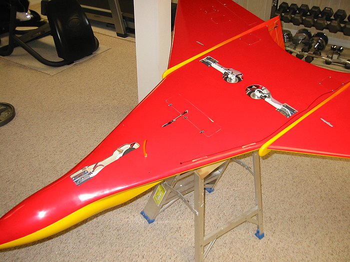

Looking good Cars II, Here is a pic of mine p-80 power, same color scheme.

Avicome
Thank you for the pictures, good help, I will also be using the Gery miller tank and for what I can see in the picture I will not have any problems with the air brake horn, can you tell me how do you hold the wings to the fuse and you can post a picture of it showing the installation of the screw, I'm debating on how to do it.
Are your battery packs in the back compartment?, and how big are they?, how about flight time?. Oh man all these question.
Thank you.
Carlos R.

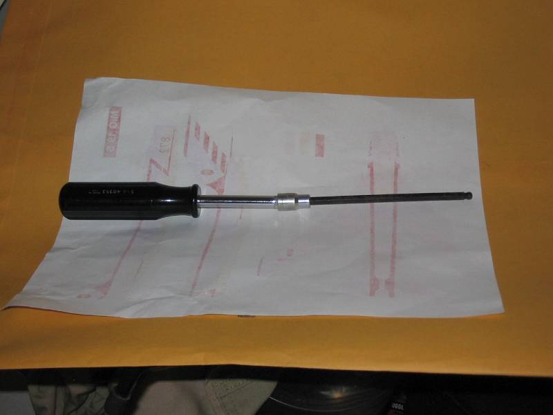

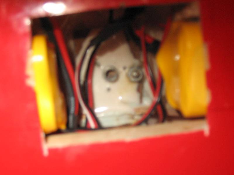

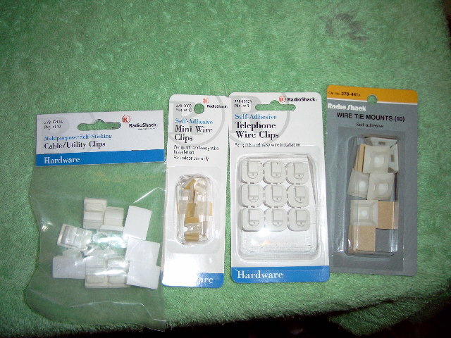

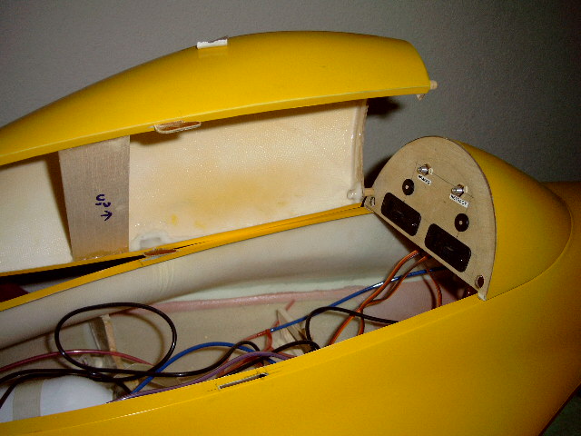

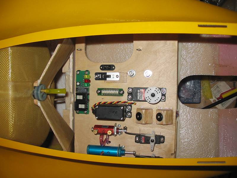

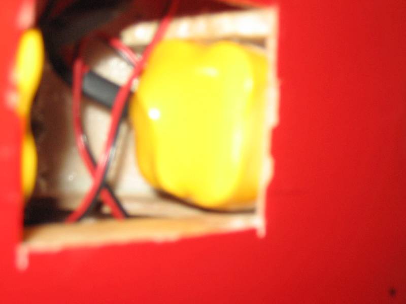

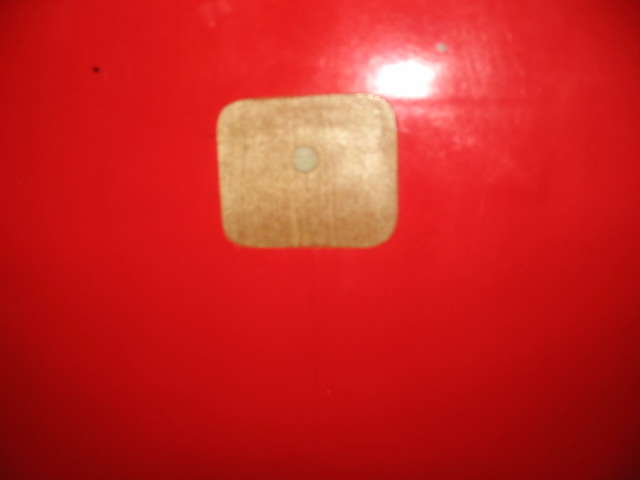

Cars II, for now I'm using a long 5mm ball end allen wrench. It's tedious inserting the wrench inside the wheels opening. My hand is not that big, but take me few minutes to catch the screws and titght them on. The better is to make an opening on the bottom of the fuse near the wing root when the bolt is. Look where is the screw and the ball link. That is the spot where to open the little channel. I still need to do it.
My battery packs are on the center of the pockets that the plane has. Look the pics. I made a access hatch for the batt. I am using tow 40000ma duralites one for ECU and one for RX. To secure the batterie hatch I install a blind nut in the underside of the turbine mounting block.
About flight time I am flying 7min about half throtle and still have more less half tank. If throtle is handle carefully you may get to the 10min flight. Hope this answer you questions.

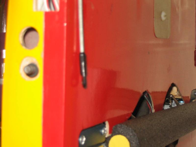

This one has the slot for the wing bolt on the wing panels. You can make like this or do the slots on the fuse as I told you in the previous post.
