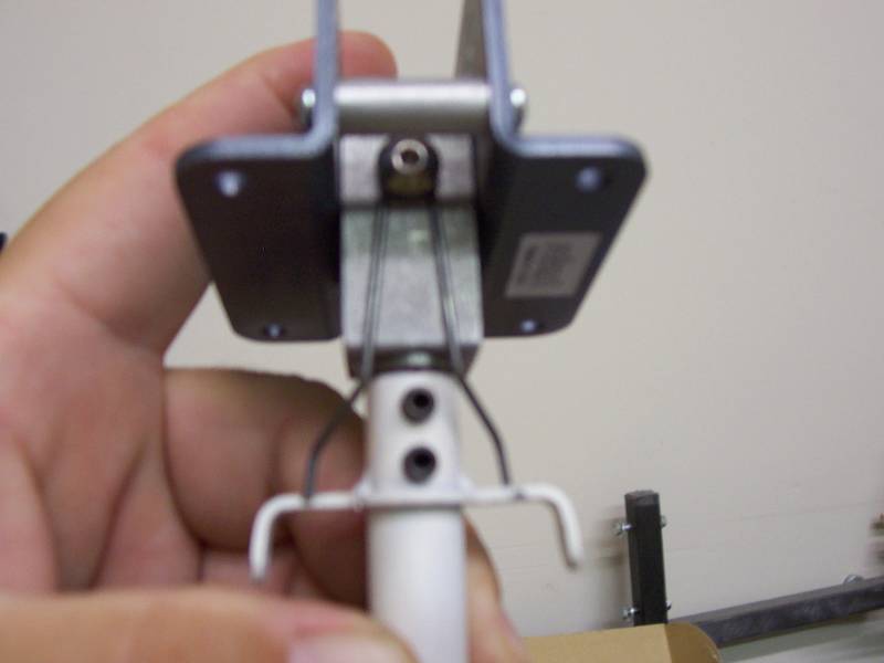

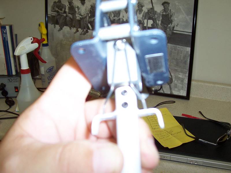

Robart 630 nose gear and strut, the centering wire is too short that came with it, what are some normal solutions?

Shape a new one with piano wire?

Can you post a clearer picture. One focused on the strut and not the wall behind it?

Is the wire definitely all the way down, under the retaining screw at the top ?
A temporary and non-perfect possibility ... if you bend both legs of the wire inwards sliightly, then they will effectively seem longer (Basic trig - assuming we measure the angle at the top - reduce theta, reduce the opposite, keep the hypoteneuse constant, then the adjacent must become longer).

Hey Gord, thanks for the options, all of which had been exhausted. I'm considering just tapping the screw a little lower, I hate drilling and tapping aluminum. Robart used to get everything Right, but this is just dumb.

OK - another temporary possibility if Todd can't get you the replacement wire as quick as you would like... how much clearance is there for the "arms" when the gear is in it's retracted position ? What I'm thinking of, is that if you can't get the wire longer, can you get the arms to be "higher" by e.g. C.A-ing a thin plywood tab on top of the arms ? With the right CA it should hold well enough until you get the replacement wire, and CA solvent can be used to clean the arms up afterwards when you remove the tabs.
Another "imperfect" and inelegant solution to be sure, but it might get you going in the short term. If you do try this though, please test that you have proper adhesion on the tabs, as you wouldn't want to lose ground steering due to an insufficient bond.
Along similar lines - could you "extend" the spring very slightly by crimping / soldering / whatever a thin brass tube over the ends of the wire ?

You the man Gordon, didn't think about soldering brass that would work, but would be fugly.

Todd, FYI, the length on this wire is 1.5 inches, needs to be more than that even if it's just an 1/8 of an inch.

Sean
Your problem is that the strut does not recess into the trunion as deep as it should.
Just bevel the edge of the top of the strut and recess it as deep as you could get it and you will be ok. The rotating part of the strut that tightens into the trunion should be flush with the opening and that is not the case in your picture

Ben, that helped, and got me close enough. Thanks.
