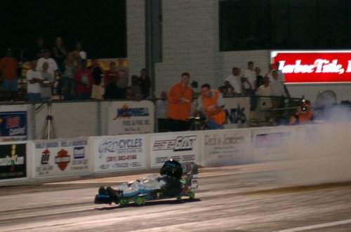

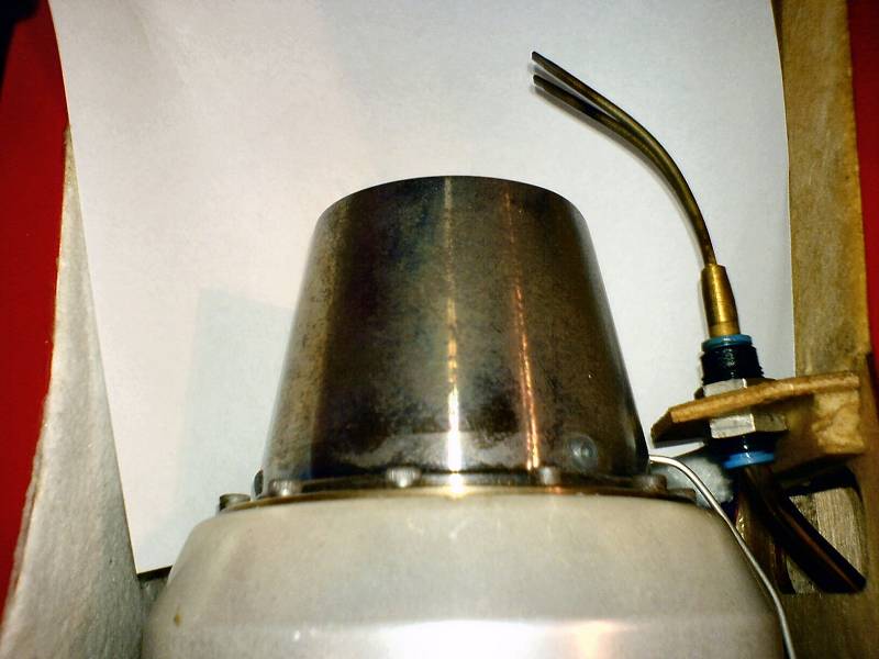

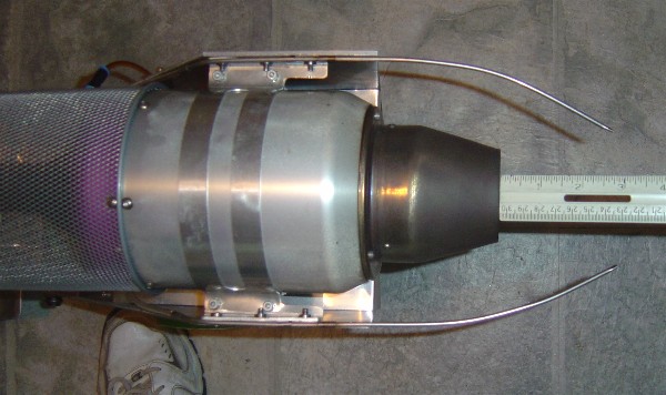

I rigged up a TamJets Smoke system to the Jet Luge this week, see the picts for the results... Lots o smoke. I got this to jack up the show a little on the dragstrip, even though I am running out of room to package anymore goodies in this design. For now I am using Super Dri for the fluid.

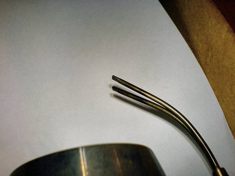

I do have one problem that I need help with. There is a fanned out residue pattern left on the asphalt after I use the smoke. It is kind of oily and I don't think they will be happy with anything slick at the start line. Any one have ideas on how to clean this up? Less fluid, different fluid, move the smoke tubes?
One more question. Does everyone have a delayed reaction turning on and off the pump? I was looking for an effect of quick pops of smoke (or flame) when I press the momentary switch. It seems to pump smoke for about 3 seconds after I let go of the switch. Any ideas on how to do this?
I will be running the Jet Luge at Maryland International Raceway for 3 days next weekend. It is the big IHRA Presidents Cup event and they are expecting near 20,000 spectators and Sunday will be televised on the Speed Channel... Who know what they will cut from the show, but I will be running in the show portion of the event with Bob Motz's Kenworth, and the Cool Bus
[link=http://www.mirdrag.com/schedule/event_listing/09-05/050925.htm]IHRA Presidents Cup[/link]
Any other ideas with the turbine to make a good show for the spectators would be appreciated.
Bob

Hi Bob, for a good clean smoke shut-off you could add something like the fuel valve used for your engine. This should go after the smoke pump for best effect.
I have the ends of the tube well into the exhaust efflux to pre-heat the fluid for max vapourisation, this might help with your residue problem.
Smoke system we use will do morse.

Bob, it seems to me that you can afford to put your tubes closer into the exaust. This will burn more of the fluid therefore leaving less of it on the ground. Its obvious that the residue being left on the ground is unburned fluid so there are only two solutions for that.
1) make sure to get all the fluid burned (it may be possible by simpy bending the tubes closer in to the exaust)
2) use less fluid (in return assuring that nothing is left unburned)

Well I have the smoke system finally figured out with what I have on hand. Sean I will try the Pressurized method with the start gas when I get a soleniod.
I now have tons of smoke, perhaps to much, on demand. With an O'scope and some experimenting I discovered how Tamjet Smoke pump's speed controller want to be sweet talked. It is no wonder I had a huge delay and intermittant pump action. The speed controller on the pump wants to see low end pulses when you turn it on (approximately 1msec wide). If you turn it on with a much wider pulse or "fast" the controller ignores the pulses and does nothing. If you get the pump running and then switch the pulses off, the pump will run for about 3 seconds (must be waiting for the next pulse and times out). SO instead of setting my speed and turning the pulse on and off, I had to put a 5k resistor on a momentary swtich to my PIC's servo controller. Switch off (1msec pulse) Switch on (1.9msec pulse). This gives me real quick bursts of Smoke... as fast as I can hit the switch and long when I hold it....
To bad the skeeters are all ready dead around here....lol
