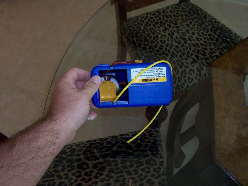

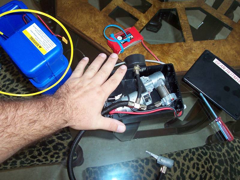

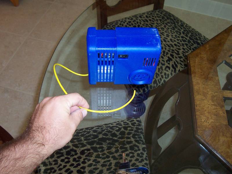

Look carefully at this picture
Old 10-03-2005 | 02:10 PM
seanreit's Avatar
My Feedback: (60)
Posts: 7,434
Received 7 Likes on 3 Posts
From: Cedar Park, TX
Default RE: Handheld aircompressor

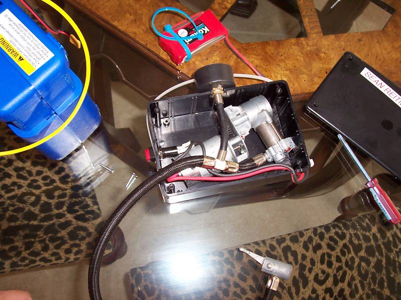

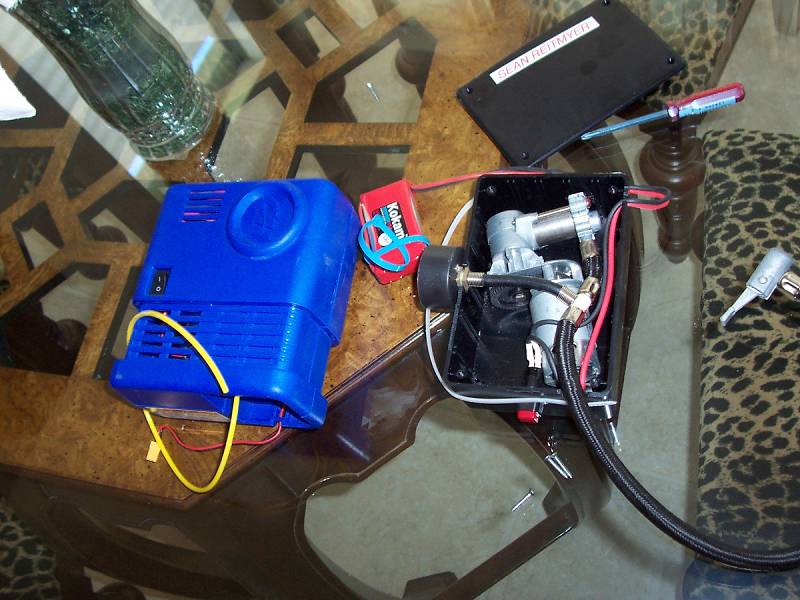

Take a 10 dollar walmart 12 volt air compressor and take it apart.
The compressor inside is very very small.
Now wire it to any of your spare batteries and a momentary switch that they sell at radio shack. And while you are there, get the big black box shown.
Alternative, walmart sells for 10 bucks a very very small compressor, no lights no guages, there is room in there to shove a battery.
You now have the "jersey modeler" of air compressors.
I've been using now for about 20 flights and I love it.
I just bought a pressure switch set at 90 psi that I'm testing an on board air compressor that always maintains pressure in my kingcat.
Very cool stuff. The compressor in side the "compressor" you get at walmart is so small you won't believe it.

I'm only using external battery to that black box because I like to switch out batteries rather than charge. Currently I'm using 11.1 volt lipo 1550 Mah, but I've used the jetcat 1200's that we all have lying around and I've used the 7.4 duralite and the troybuilt.
Of all I recommend the 7.4 troybuilt for the compressor. as it is 5400 mah and will last a very very long time for the compressor.

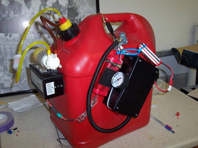

Hold on, I'll go get a pic of the latest one I built.
Old 10-03-2005 | 02:20 PM
seanreit's Avatar
My Feedback: (60)
Posts: 7,434
Who's your daddy??
The lead hanging out the blue one is the duralite charger lead

Sean,
You may want to put some cooling holes in your black box. Those little compressors can get pretty hot. Mine ran fine for a good while and then all of a sudden started blowing air hoses until I put some vents in the box. That's why they are usually installed in what appears to be a larger than needed case with plenty of ventilation holes.

Are you guys not worried about the lipos mounted to the fuel can? Seems like a recipe for something.
Old 10-03-2005 | 11:16 PM
JohnVH's Avatar
My Feedback: (38)
Posts: 16,179
Received 10 Likes on 8 Posts
From: Ferndale, WA
I wouldnt be.
