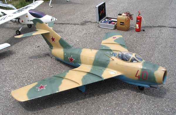

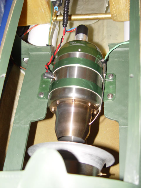

Its not super critical IMHO and would be fine as your diagram, that said as a rule I reckon closer the pump is to UAT/tanks the better as then quicker to draw fuel into pump and prime and start pumping fuel... By the way the Super Sport is a great turbine!!! been flying one in my 29 lb Fiber Classics Mig 15 all season and the power is simply amazing coming from this little beast

Very interested, and pleased! to hear your Supersport is flying your 29lb Mig well. What is your tank capacity and what sort of fuel burn are you getting on this airframe?

Hi John, I have 3 lt capacity between three tanks but plan on now using one of these for smoke as the SS will fly for about 8 1/2-9 min on 2 lt... Iam flying at very near full throttle for most of the flight with airspeed approx 120 mph and looking very scale, vertical is pretty good also and loop from level flight easily... I will have to get some flight video of it soon as it really amazes most when they here its flying on the little Wren
