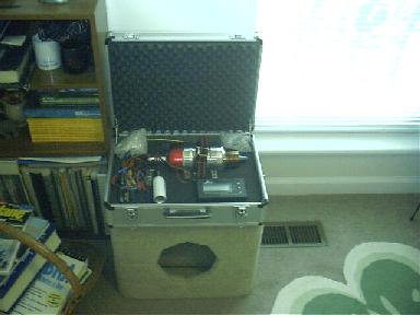

I just received the new TJT 3000 and I am very pleased the way
it was packed and shipped promptly from Australia. It arrives in
a nice aluminum carrying case that can be used for support
equipment and transmitters later on. The service has been
excellent , the best turbine purchasing experience I have seen
to date. Looking forward to test runs this weekend.
Happy TJT 3000 Owner

Here it is guy's

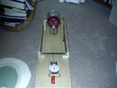

I have made a test stand for the new TjT 3000 that I can check the thrust of the turbine. I hope it will be all set-up Sunday afternoon, here are some pictures of the test stand and the turbine installed on it. This will be the future for new turbines.
TjT SETTING THE STANDARD!!!!!

After setting up the ECU, I proceded with the first start up and
the Turbine started perfectly, and it is performing to all manufacturing spec. as indicated. The support I have had from TJT is excellent. If you're in the market for a new turbine, take a real good look at the TJT 3000 Eagle. Web site - www.tjt.bz
TJT SETTING THE STANDARD

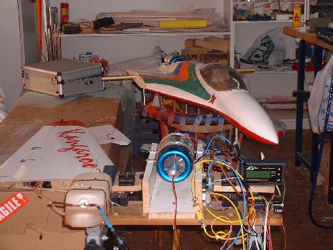

Here's a photo of the engine I received last Wednesday. It ran on first attempt and kept starting every time I pressed "allow start". Behind it, is my older TJT3000 with Auto FADEC by Gaspar Espiell sitting happily on my HS. Both engines are super runners, but the latest one with the TEMS ECU is really a gem.
Thanks Chris, you really made me happy with the last shipment.

I test ran the TjT 3000 Today 10 times, and each time it started perfect every time, at 126,000 rpm's I was getting over 27 pounds.This is a great turbine, and I hope to have it flying soon.
TjT Setting The standard

That's great WD40!!
If your set up is accurate to about 5%, then at 126k you are getting 27 lbs of thrust. Assuming the data given to us by Jetcat is correct, the P120 has 26 lbs at 120k. As a customer, I would like to see the thrust on the TJT be higher at 126k or a 27 lbs thrust at 120k. Physics laws dictate that under SAME CONDITIONS and design criteria, the lower rpm motor will last longer!!!
Please let us know the results when you fly it so we can collectively make some intelligent choices!!!

Hi WD40,
Where did you got the thrust measuring scale? My home made test bench uses a spring with a calibrated scale but it can run out once in a while, needing regular calibrations.

I am now getting 30 to 31 pounds out of the TjT 3000 The temp out side was 40 degrees fahrenheit, and scale came from Wal-Mart it is just a fish scale.

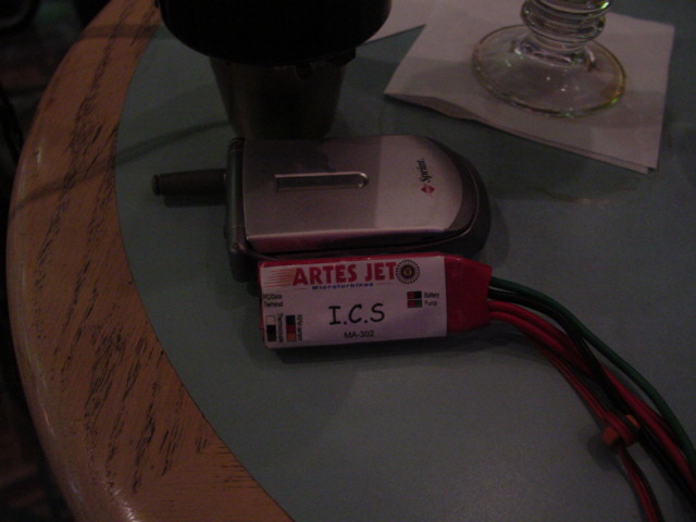

Hi, Would also like to let guys know the new 3D ics ecu is coming with all Artes Jets Eagles this is a very neat Ecu and has the latest auto programming and is micro small,The Eagle from Artes will be Ama Approved quite soon and yes those TJT are a separate deal.Glad to hear all the Guys with Artes Eagles are batting a 1000...

Hi Mike
I'm not knocking TJT here, but when your doing your thrust measurements, you have to take into account air temperature and adjust your numbers back to STP(Standard Temperature and Pressure: 15C at Sea Level).
Earlier you posted that you were getting 27lbs at 126K and I'd guess that the temperature was about 60F(15C). Your now getting 30-31lbs at 40F(5C). The colder the air charge, the denser the air, the better your combustion, the more thrust you get. For turbine engines, regardless of size)there is approximately a 1% change in thrust for every degree celcius difference above or below 15C(60F). If I use your 27lb measurement from earlier on and make the assumption that that was measured at 60F(15C). Your new measurements at 40F(4.5C) of 30-31lbs fall into the 1% thrust per degree celcius change formula within +/- .5 lb. If you extropolate that to say 75F(24C) you'll only get about 24.5-25 lbs thrust.
Again, this is not a knock on TJT . What I have stated above affects every turbine manufacturer, Big AND Small.
SimJet turbines are affected in the same way. For example we(GNM) rate the 3000AES at 28lbs at 25C(77F) or 31lb at 15C(60F). At the moment, they are putting out 33.5lbs at 5C(41F). All the thrust numbers are within +/- .5 lbs.
I hope I have added some insight into the different thrust levels you are seeing. If you have any questions, please contact me off line.
