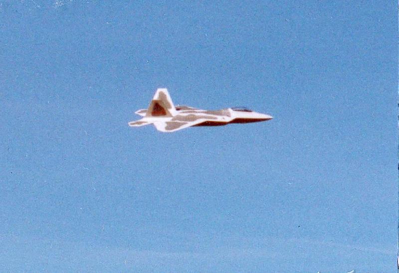

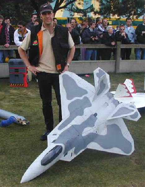

I had a bifurcated pipe in my plane. I agree that it looks "smoother" but the negative points where too much. More noise (horrible sound) lost power, more heat in the airframe, more weight in the back of the plane. So all the positive nice looking did not compensate the negative things. But what makes it useless was the lost of speed!
On the 5th flight the engine lost its tail cone which stucks in one side of the pipe and generated so much heat that the frame was clos to get burned in flight. This gave me the feeling that a single tube is the better solution. For "Stand of scale" i can attach the middel "boom" so that it looks nice on the ground but its removed before flight.

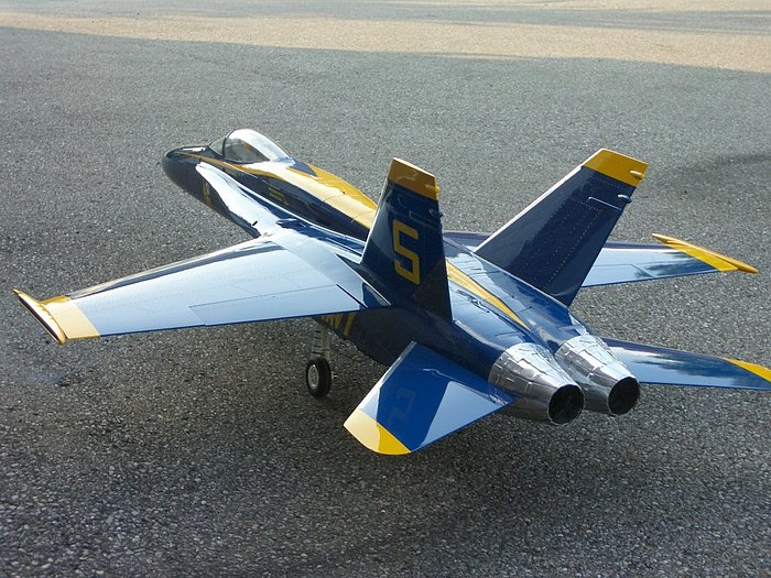

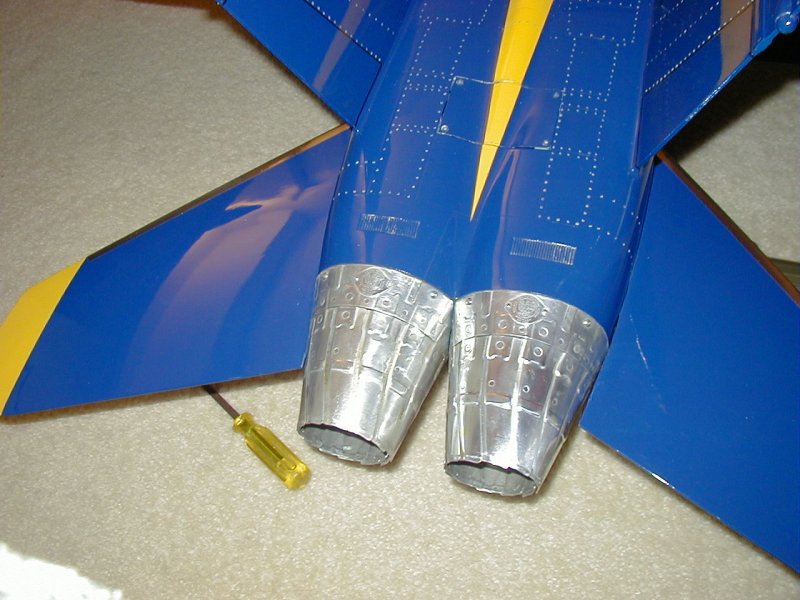

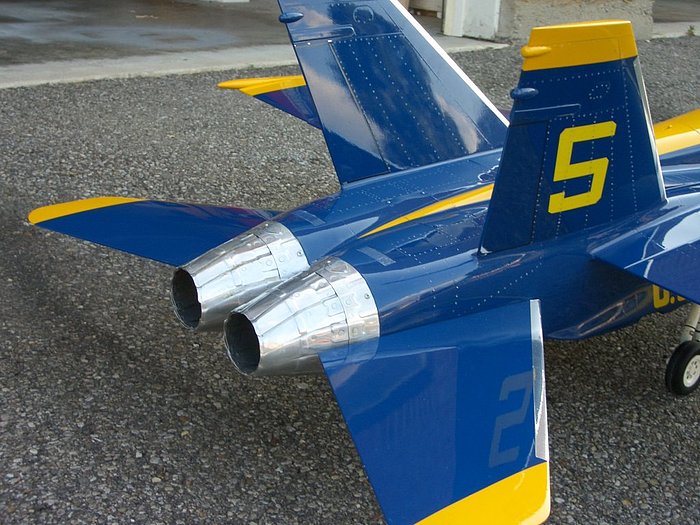

I had the Bob Fiorenze variable outlets on my YA F-18 single (which was orginally Bob's plane). They worked really cool, although it either required a mix in my radio to use or else just manual actuation for show. I'm not sure if they made much of a difference in real world performance on the plane. They definitely looked cool, and I don't see why a similar setup wouldn't work for a turbine jet if the material was changed to something that could withstand the heat. I've attached some pics.
