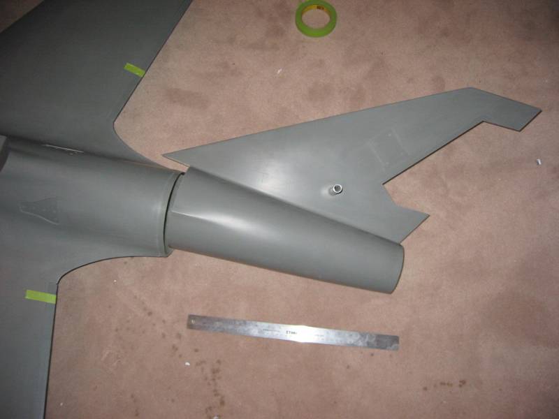

These are the intake ducts. Pretty typical to many planes .. the outer fuselage is scribed where to cut the openings out and these are epoxied in place and then reinforced with some fiberglass tape around the inner seams.

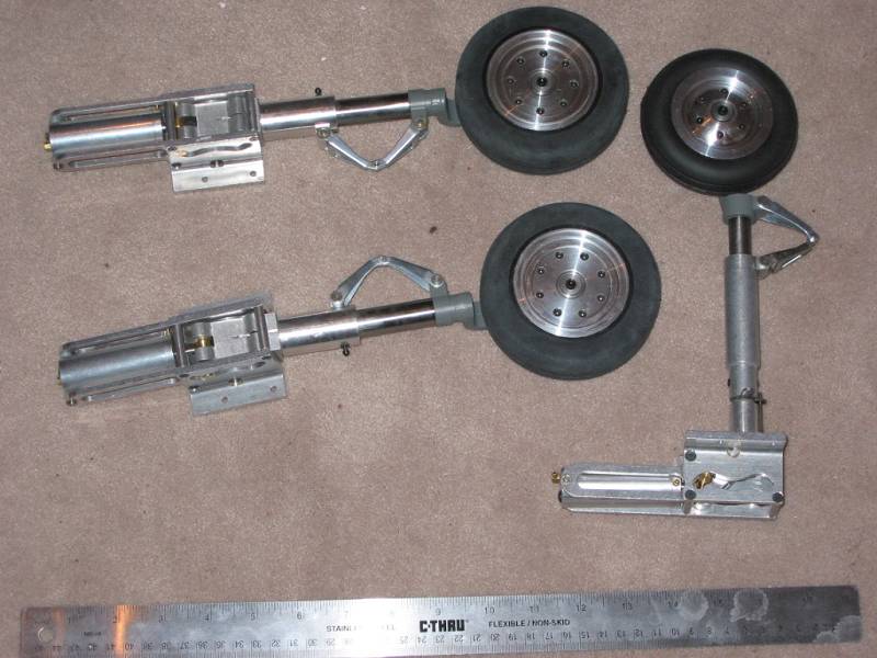

Now for the best part !!! THE LANDING GEAR !!! WOW !!! these are the nicest , toughest set of gear I have ever seen !! these even rival the gear on my BVM Rafale which are super tough as well … ( http://www.voy-tech.net/rafale.htm )
I also noticed that the rubber compound on the tires is nice too … the tires seem like they will have a lot of grip, yet do not seem like the type that will wear easily. The gear assembly feels solid enough to transport an elephant on !!
If you rip this set of gear up, then that means there is not much left of the plane [X(]

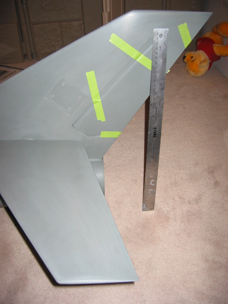

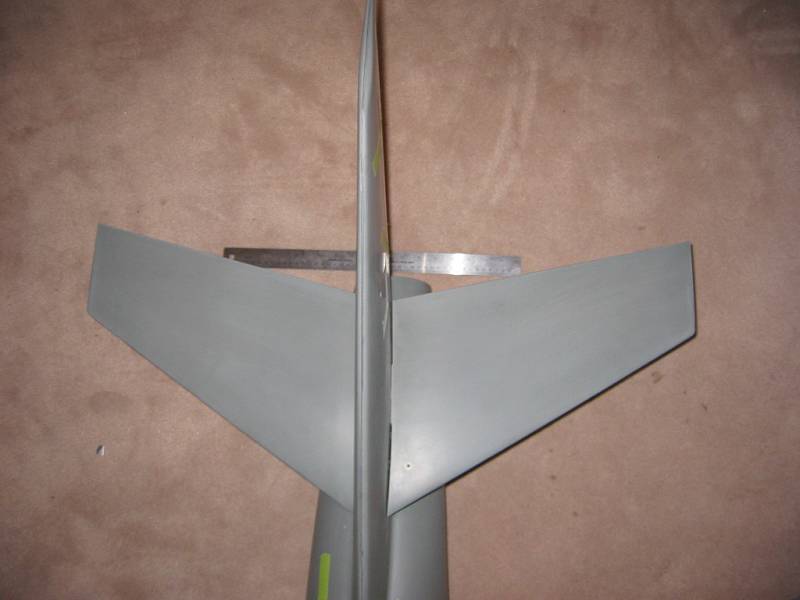

Here are the stabs. The pivot tube is already installed and aligned inside the vertical fin. The elevators have receptacles which rotate over the tube. Each elevator by this method has over 9” of distributed support on the joint !! sure beats thin rods, small bearings, etc .. and other methods with minimal support provided ..
Notice the elevator control arm locations scribed on the fuse, as well as the control rod receptacles on the elevators themselves. All is very well thought of, and built for perfect function.

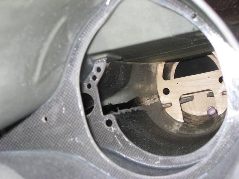

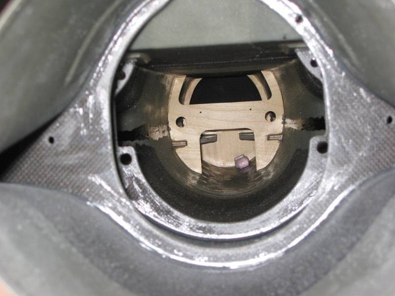

This ( besides the intakes ) is probably the most involved area in the build. The fit between the aft and forward fuselage is absolutely perfect, and should be no problem at all … I might laminate some carbon cloth over the inside of the joint just to overdo things like I always tend to , but I don’t think that that is really necessary anyway however …
