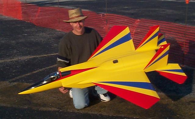

I went with the Bobcat XL for my first turbine. I had flown one, and knew it handled well, and was well within my skill level. Add the fact that I was able to do spins, tumbles, and other aerobatics not typical of Jets with ease (I like aerobatics as one could tell from my hangar), and I was hooked. Depending on the pilots skill level, the Bobcat XL is a good beginner jet as well.
If the F-16 is the bird you want, I agree that the Byron F-16 is a great one to start with. I uses the 6 inch pusher fan which is great for grass fields and having bottom end power. It is not the fasted D/F out their but some pilots are not looking for speed.
If you are open to a F-15 or Mig-29 then look at the TGA kits. They can use the 6 inch pusher fan unit with its pros or they can use the Dynamax 5 in tractor fan units with its pros. These TGA kits are geared to the first time entry level beginner pilot and builder and so is the company. They are some of the easiest to fly jet kits and they are also being flown by using the elevators only for pitch and roll if you so desire. The total ready to fly package of the TGA kits are also a great value. Check out their kits on their website at www.tgajets.com.
When you are ready for a turbine, you can sell your TGA kit for money toward your next purchase. There is always another beginner pilot looking to purchase an ARF Topgun F-15. They go like hot cakes in the classifieds.
Good Luck
Paul

I agree with Justin (Sandman), TGA F-15 is an excellent trainer jet, easier to fly than the Byron F16. Dont recommend the Byron F-15 as that is a twin engine bird and starting with a twin is not the route you want to go....
Todd
