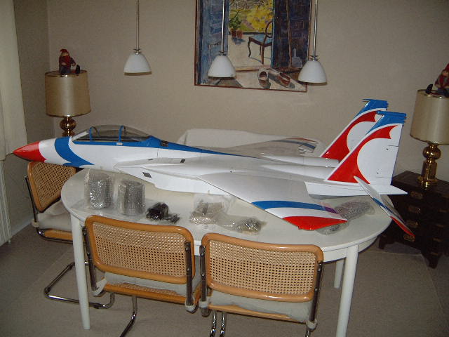

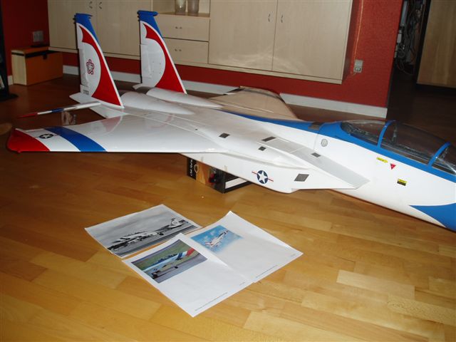

Here is my new jet from Skymaster F-15c.
more pictures will come as i start to assemble the jet.

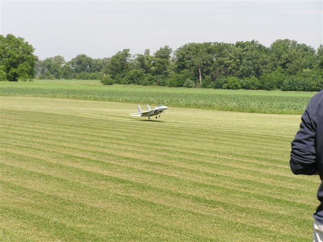

Anybody could tell me if sm struts for F-15 is to soft to use on grassfield.
Old 12-26-2005 | 11:40 PM
AirPac Models's Avatar
Joined: Aug 2003
Posts: 984
From: Honolulu, HI
Default RE: Skymaster F-15c
Should be no problem. We have a lot of customers use on grassfield.

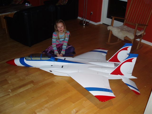

I received my SM F-15 ARF from Al's Hobbies today. It looks really good, and I'm sure I can finish the model in time before traveling to Florida Jets in March. All the parts go together real well. Only thing I could find is a slight mis-alignment of the canopy hook, but that can easily be fixed.
Daughter Johanne shows her daddy's new toy.

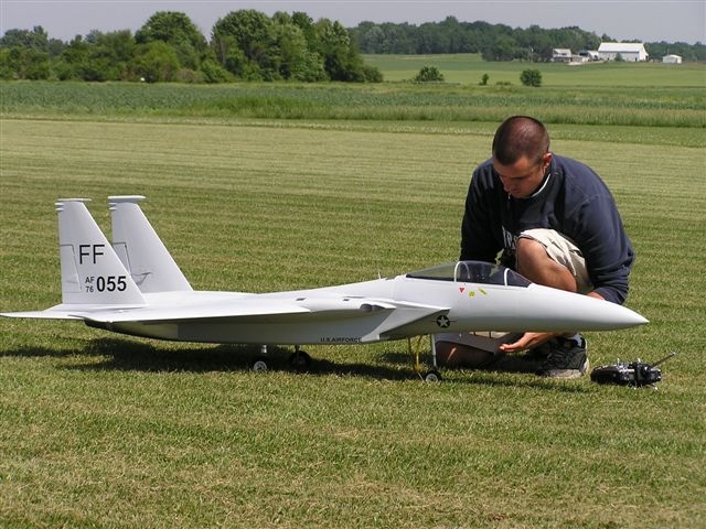

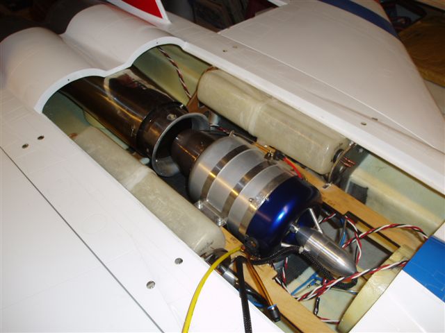

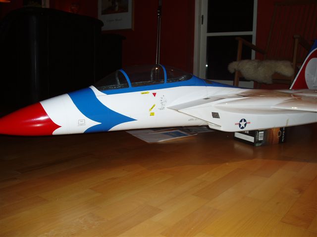

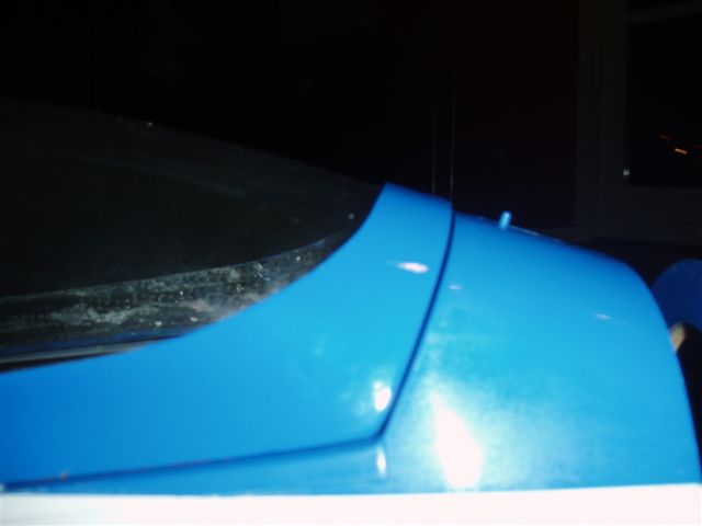

would like to add scale light on my F-15 nav light roatning beacon.
anybody could tell where to place it.

Some pictures of the F-15 Bicentennial color scheme for your reference

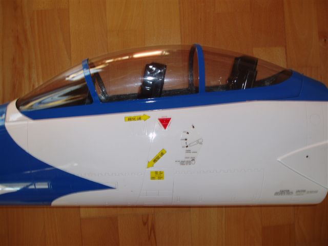

I added the decals to my SM F-15 yesterday. Here are some pics.

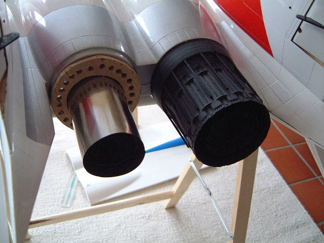

Hello you F15 Owners

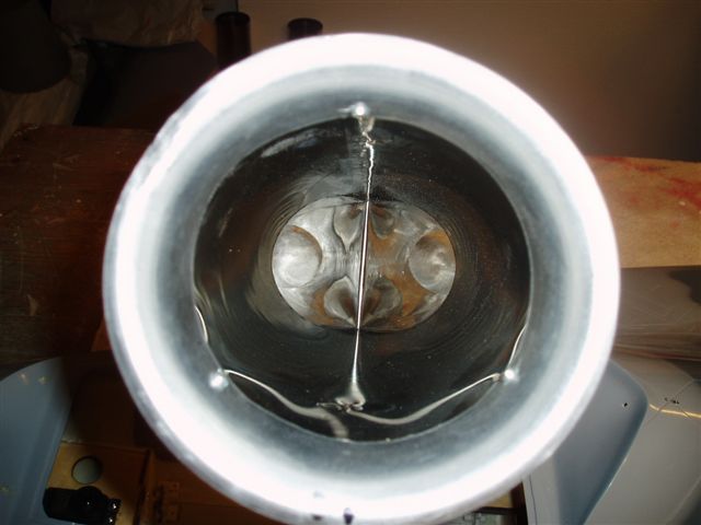

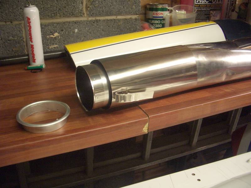

I have just taken delivery of the SM Tailpipe for the F15. And I noticed that the Bellmouth to the pipe is loose!!
Should this be spot welded in place or do I need to do something else to it??
I would have thought that this should not be loose.
Could someone shed some light on this.
Many thanks
Peter G

Hello Peter.
I drilled 3 holes though the belmouth and pipe, and tightened the belmouth with some 2,5 mm screws. I let some cyano run around the edge.

Hi Peter.
As Stig said, 2 or 3 screws are required to attach the bellmouth

I've used 1/8 " aluminum pop-rivets , don't have to worry about the screws coming loose .
Charlie

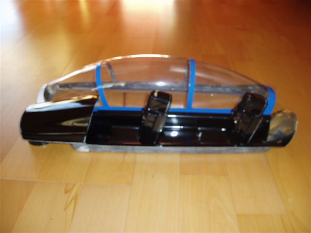

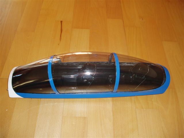

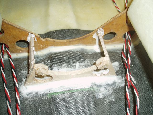

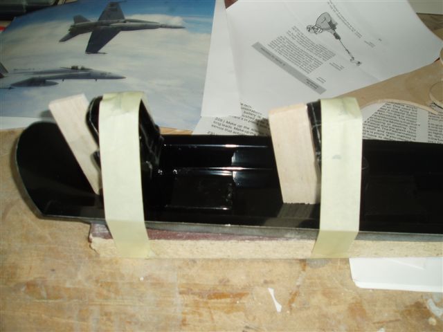

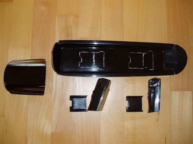

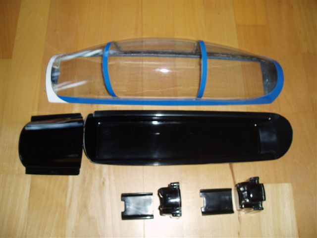

I did some basic work on the cockpit today.
#1: The parts supplied for the cockpit.
#2: The two seats were cut to lean a little backwards. The rear seat needs to be cut approx. 10 mm (3/8") shorter than the front seat in order not to go against the hood. I scratched off the paint of the cockpit floor where the seats were to be glued on.
#3: I mixed up some 30 minute epoxy with some carbon to make a black glue that will be less visible.
#4: I glued the seats to the cockpit floor using some scrap balsa as aid for the seats. The balsa was held on to the seats with dobble sided tape. The whole setup was taped down while the epoxy was curing.
#5,6&7: The finished cockpit ready for some scale detailing. I might just fit a pilot dummy to the front seat, and leave it at that. After all, it's an ARF..

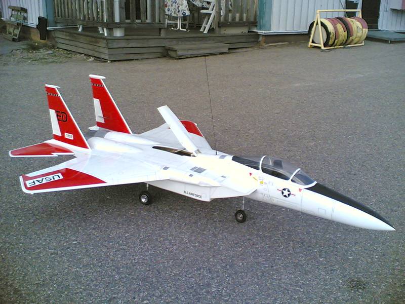

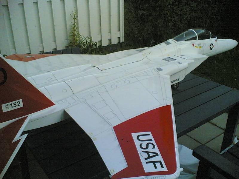

i just wanted to share some photos on my SM F15 [8D]

Thomas
Great looking F15. Can you tell me what you highlighted the panel lines with. I like the idea of doing that, but wasnt sure what to use.

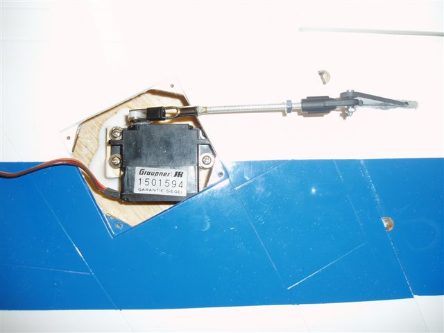

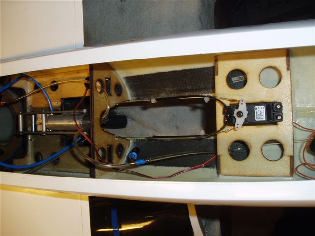

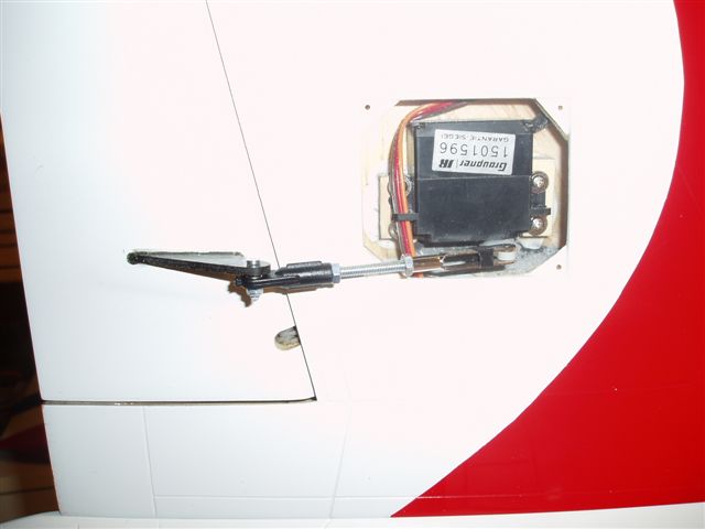

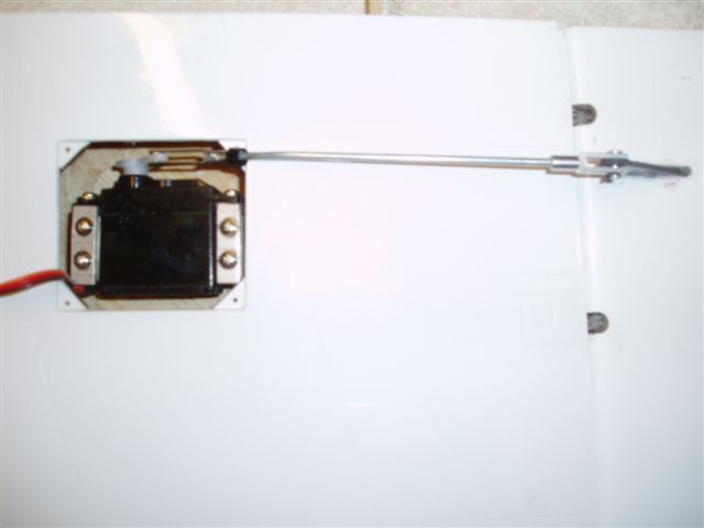

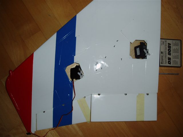

Morten and I finally got the servoes for our SM F-15's. On the rudder and anileron we're using the Graupner/JR DS3328 with 4 kg torque and 9 kg holding power. On the flaps we're trying the new DS8081 with carbon gear, 5,5 kg torque and 12 kg holding power.[8D]

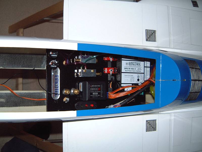

A few pictures

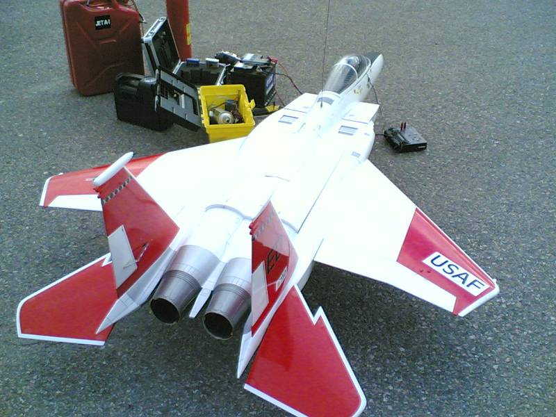

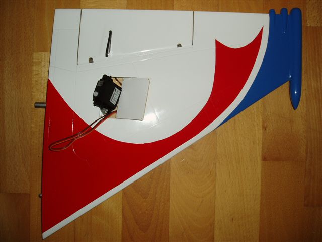

Hey, hey. Hold it now, Morten. Are you going to maiden your F-15 before me????

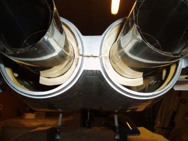

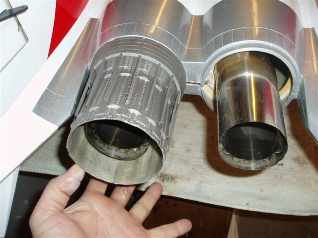

I have installed the servoes and the pipe is the one from my F-22, that has been retrofittet into the F-15. Not a perfect match, but it is OK.
