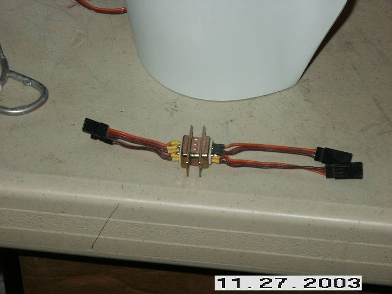

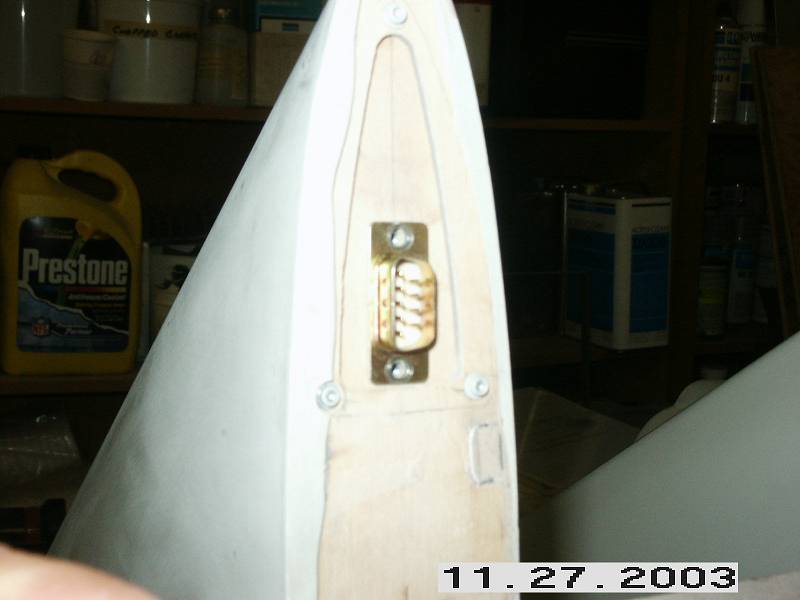

Here are some photos of how I did this on my Super Bandit.
Mount the "pin" side of the Sub D connector in the wing and the socket in the fuselage. No "hot" pins on the fuselage that way in case the switch is "on".
Costs about $10.00 per airplane.
after making the fuselage mounting plate, assemble the connectors and mount the wing panels, then glue the plate to the fuselage just like you did the E-Z Air set-up.

Thanks Harley, I saw you post that pic on another thread... the glue is drying on the second one as I type Looks really clean... I only have one servo in each wing, but this has got to be slick when you have multple servos, really makes things nice.
Only regret is that I should have done the EZ air and the 9 pin connector on one piece of wood for mounting inside the fuse...woulda been easier.... but still worked out well.
