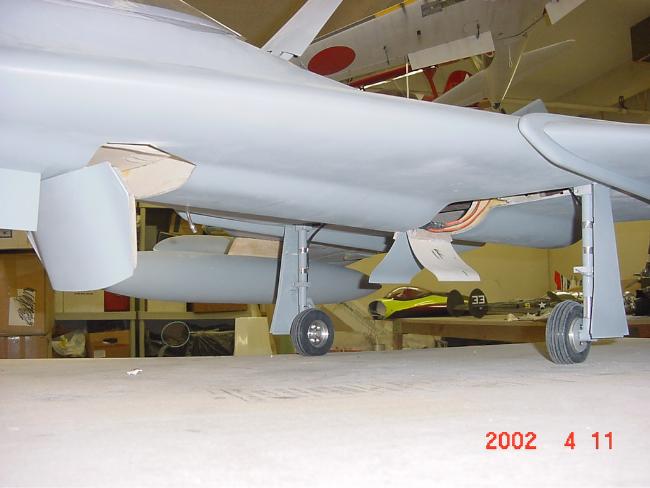

Old 01-12-2006 | 10:45 PM
Posts: 308
From: Lodi, CA
Default RE: HOTSPOT
I don't know who's HOTSPOT this is but it looks awesome. Does anyone know who's plane this is? Any pictures of it finished? I would take a clone of this one anyday.

Old 01-12-2006 | 11:08 PM
rhklenke's Avatar
My Feedback: (24)
Joined: Jun 2002
Posts: 6,005
Received 34 Likes on 21 Posts
From: Richmond, VA
Default RE: HOTSPOT
Don't know who's that is, but the tip tanks are from Tad at Golden West. I have a pair on my Kangaroo.
Bob
Old 01-12-2006 | 11:16 PM
Turbulence's Avatar
My Feedback: (76)
Posts: 1,325
Received 6 Likes on 5 Posts
From: Sahuarita , AZ
Default RE: HOTSPOT
I bought that Hot Spot from Sung right before we went to the World Jet masters, it was Henry's and he built it (HVN Models) I sold it to William Foster in order to get a RTF Skymaster/Airpac F-15

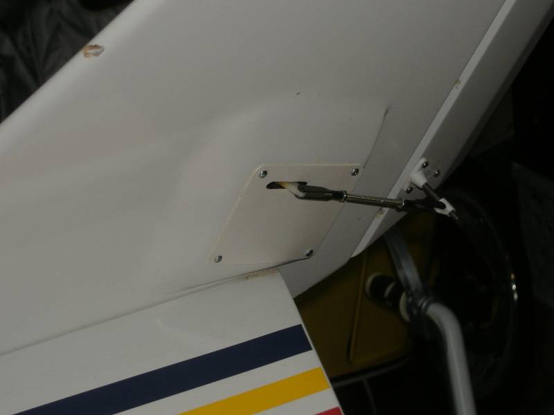

Old 02-14-2006 | 04:55 PM
My Feedback: (23)
Posts: 794
Received 23 Likes on 20 Posts
From: Miramar, FL
Default RE: HOTSPOT
Guys I have begun the work on the Hotspot and here are some of the pictures of the work done so far. A few modifications to the rudder to fit my digital servos. Enjoy

Old 02-14-2006 | 05:01 PM
Gazzer's Avatar
Joined: Apr 2004
Posts: 988
From: Southam, UNITED KINGDOM
Default RE: HOTSPOT
Ledd4u
Ooopss no pictures!!! Looking forward to seeing them, my Hotspot is well, um, ready for some work!! Despite being already finished, my friend Jason checked it over and there are quite a few things not right. Ghost Rider kindly sent me the Bob Willcox build instructions, and I would really reccomend you have a good look through these. I would be happy to send the file to you if you PM me your email address, and Kelly W also sent me some really good stuff that I think would be useful too.
There is a lot of help and experience around regarding the Hotspot, I hope you enjoy yours as much as I intend to enjoy mine!!!
All the best,
Gazzer
