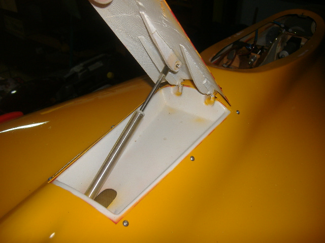

One more question guys, I am trying to set up the speed brake. I planed to use a futaba 136g which has about 90 oz/in of torque. it travels 180 degs, but I am not getting a full deployment even with longer arms so I was trying to use a aircylinder. I have seen several posts from years ago about servo vs air cylinders, any comments would be appreciated.
If you were to use the air cylinder, which way would you install it, a) the tail end of air cylinder toward the speed brake hinge or b) tail end toward the fuse end

Mine runs of a Hitec 645 MG. Its got adequate torque to deploy while on final. The speed brake won't go all the way to 90 degrees. I think mine goes somewhere around 70 or so. If you use the linkage to its limit, you'll have trouble getting the brake to lay flat without binding the servo arm. I'd run out and check for you, but I've got it packed up and ready to roll off to the High River jet rally tomorrow. [8D]
Kelly

Would you use cylinders in place of servo? I am thinking that would be less weight and less power usage.
Old 07-24-2007 | 07:21 PM
  #70
My Feedback: (38)
Posts: 1,452
From: Nashville, TN,
Default RE: HOTSPOT
Not really any lighter but it was pretty easy to set up.

In order to be safe, it should not be chained up to any of the critical air systems... (Gear or brakes) This kinda demands an entire new set of pneumatics, and driven by a servo... If that's the case, you're likely to gain weight, and certainly complexity with the pneumatic version. The servo option is variable and only pulls significant levels of current when applied, if its not set up to bind when retracted. I haven't noticed any specific Rx voltage drop when I apply the air brake brake. I use an eagle tree data logger that records data in 1/8 second increments...
Personally, I'd stick with the servo. I actuate mine about 1/2 way as I'm coming off the down wind leg, then full once I'm in line with the runway and want to start bleeding off speed more aggressively. Its a functional brake when the nose is level or down, nose up, the drag induced by the delta wing is going to be WAY more than your air brake.

My old HotSpot (rest its soul) used a MPX Mc/V2 programmable digital servo on the speed brake programmed for 180 degrees of throw. Worked perfectly. Never an issue with plenty of power. I would use one of those or a modern Hitec digital and program for more throw.

P.S. I had it set up so that the servo arm was in-line with the pushrod at full brake deployment so there was effectively zero servo load. It was easy to do. I'd skip the air cylinder and use a servo.

Thankyou for all inputs. I was fooling with the ~3/4 " diameter cylinder that I planned to use, I may have to change to a slimer one if I go the numatic route. I may just end up using the Futaba 136G retract servo. I think I can get about 60 degree lift off of it.

I finally resolved the speed brake problem that I had. I dropped the box frame floor where the cylinder was mounted to by 1/8" and machined a aluminum adaptor to fit the horn that was installed. It is operating like a dream, it sounds pretty coooooollllllll. I guess I will hook it up to the brake line air supply....any comments or suggestions would be appreciated.
