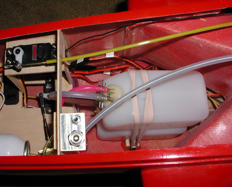

I was wondering if you could post a photo of your fuel tank setup. I haven't figured out a way to mount the tanks and yet have access to the front of the fan to start the engine. A photo of your setup would be appreciated.

I sold the plane. Don't have a photo of mine.
However I did the same as the attached photo. The starter wand angle was awkward, but it does work.

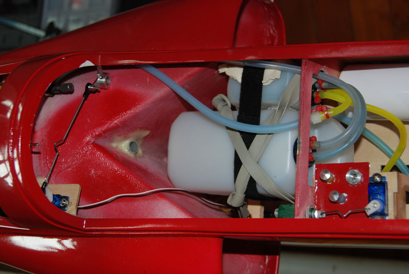

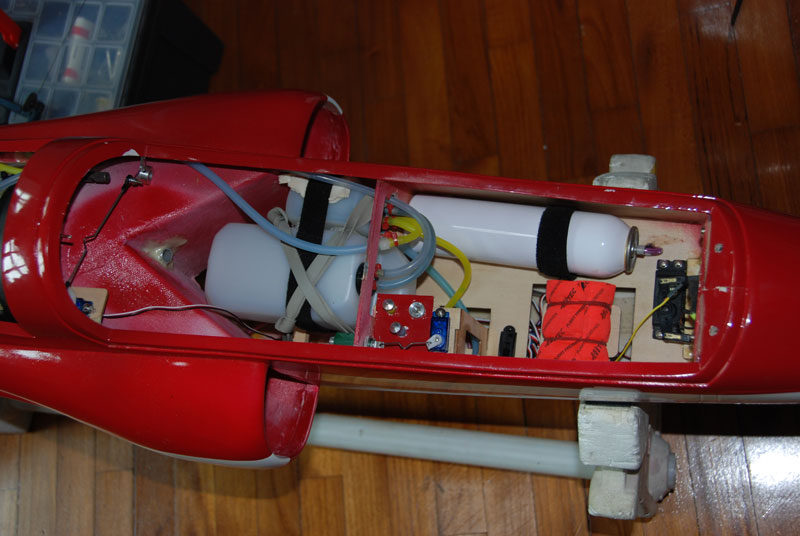

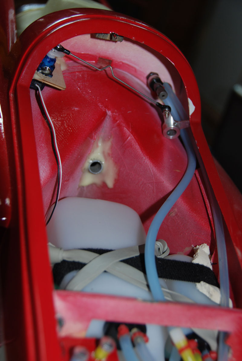

dw_crash,
I did something very similar to the attached photos. This is not mine but it should help.

Mike,
Thanks for the pics. They are very helpful.

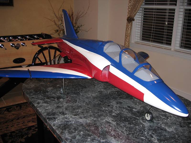

I saw this on ebay, Item number: 150231947484
I think this the one from Will Hobby. Is this the same one that you guys are building?
thanks,
Charles

cpierre82,
Yes, they have the same specs and probably same manufactuering facility. Mine is red white and blue. I have another one new in box that is all red.
