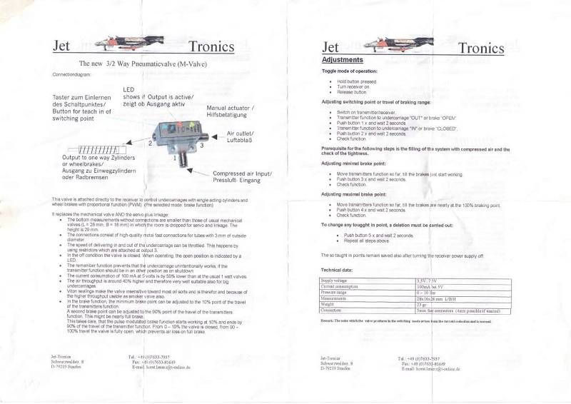

hi i have a jet-tronics brake valve i can get it set up for on - off brakes but i cant get it to be proportional - when i push down elevator i get full brakes - i know i will flat spot my tires at this setting - any help would be great

follow Toggle instruction to switch to proportional mode....

i have these instructions and i have followed them but it does not work
may be i am not doing some thing correct - do you set the valve up as
on off then set it up as proportional or do you go straight to the proportional
setup

I'm a little confused Six?
The instruction indicate how to switch between proportional and on/off mode. You then need to program the end points into the valve (ie: stick neutral and full down elevator, if this is what you are looking to do) The brakes will be proportional anywhere between the two points but at stick neutral, brakes are off. Stick full deflection, brakes full on.
Does this help?
