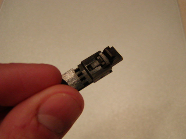

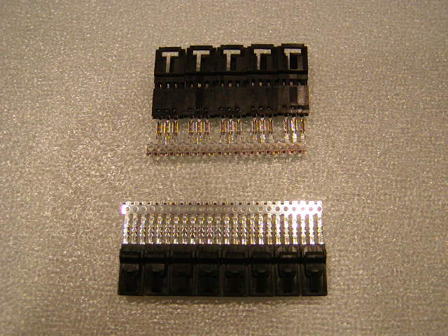

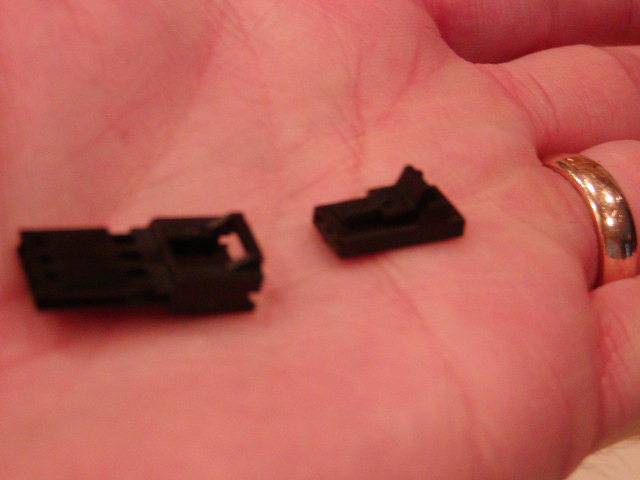

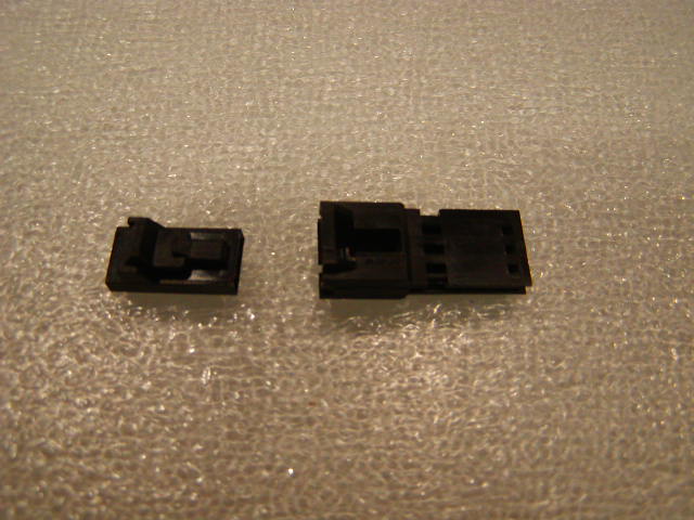

Folks,
Thought I would share some connectors I have used for a number of years and they work AWESOME. AMP makes a line of connectors called MTE. They come in different pin counts. I use the 3-pin version (obviously).
The nice thing about the connectors is they have a locking tab on them, so you don't need to use any type of extra clamp to make sure they don't pull free. They also are the EXACT same size as the original Servo Ends (see pics)

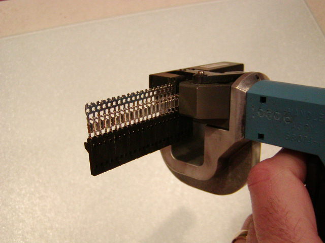

The connectors come in a variety of !QUOT!crimp!QUOT! styles. I use both the Speed Crimp style, shown here, and the style where you crimp each pin individually.
I show in the pics the crimper you use. It works really slick as you don't have to strip the wire, just insert in into the connector and squeeze.
The single crimp style requires you to strip the wire.
Another good thing is the connectors also come without the locking tab so it will plug right into your receiver as well.
Just my thoughts, hope it helps.
Kevin

Default RE: making your own servo ends
Kevin, can you post specific website and specific part numbers and description of each part number so that I can order some of that?
I would like the crimper as well, sounds like that would be a lot easier than the single wire strip and crimp method.

Kevin,
I third that request, please post the details if you have them. I found the connectors at Newark (www.newark.com), but its a bit confusing to figure out what is needed to make a connection. Perhaps your source has it laid out better?
Bob
Mr. Mikes post has the info I think your all looking for (Thanks Mike). I have never used the crimper he shows, only the one from AMP, but be warned that the AMP crimper may be $$$$$.
I am sure it will work to crimp individual pins/sockets.
