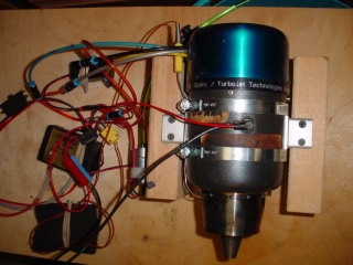

Guys & Gals,
Check out the new turbine pictures on my web site:
http://terry_holston.tripod.com/holstonsjethanger/
They were sent to me by Chris Mounkley from Australia, the engine is a collabration between him and Tom Cook of Jet Model Products.
Uses an ECU Tom designed, Chris says is the easyest to use ever!
Click the "New jet engine" page.

Davidr,
We will have to see what Tom sets the ECU for. You might remember the test stand at Superman at Tom's trailer? That was the TJT. We had 22 pounds of lead on the cable attached to the "slider" and the engine would snap it right up. I'd guess somewhere in the 22 to 28 pound range. It's been run a lot harder than that.

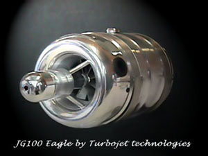

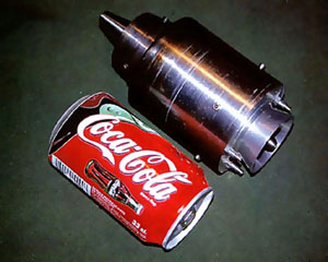

More pics of the new TJT/ARTES/JMP engines the JG 100 'Eagle' and JF 50 'Bee'
Both engines are designed, produced and distributed through
TJT/ARTES/JMP
Pricing is being finalised, but! expect a plesent surprise....
Cheers - Marty TJT Canada

The JG-100 (JMP-3000) picture above shows the configuration that I have, with the aluminum can. According to Chris, it is stiffer than the steel can and he can annodize it to many different colors. I have a bunch of Hot Spot flights on it and it has been wonderful. If I remember correctly, it was supposed to be 27 lbs at 126k RPM, but wait for the TJT web site to be sure and Tom may change that with his ECU (which, by the way, is supposed to be really nice!).

Hi Marty,
I think you might got incorect information on the JF50 BEE
The JF50 BEE was not designed and is not been produced by TJT.
Contact Jesus Artes at www.artesjet.com for compleat information.
Regards
Felipe Nieto
co-designer and co-producer
