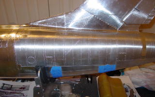

Default A Riviting F100 experience!!
1
http://home.swbell.net/walnutgs/DSC00064.JPG
http://home.swbell.net/walnutgs/DSC00063.JPG
http://home.swbell.net/walnutgs/DSC00062.JPG
http://home.swbell.net/walnutgs/DSC00061.JPG
http://home.swbell.net/walnutgs/DSC00060.JPG
http://home.swbell.net/walnutgs/DSC00059.JPG

Old 11-28-2002 | 05:29 AM
Posts: 4,586
From:
Scott,
That is a nice job.
Your smoke system is ready. Call me early friday so I can mail it out to you.
Brg,
Tam

Thanks alot for the positive feedback. It feels good to be pat on back after alot of hard work. This is my first REAL effort at a scale finish. This took about a week of evenings. All the research has been paying off. I still have other side and wings and stabs. I would estimate about 5,000 rivits so far. I am an amatuer at scale finish, but I feel I'm getting some professional results. Thank God for Flite Metal because I can't paint and these rivits look great on it. The more I work on this the more I really want to scale it out. This might end up taking another couple of months If I decide to do everything I've been thinking about.
Kevin,
I might be able to fly SAT. I'll talk to you before then.
Tam,
Call you tomorrow.
Bob,
Get one of those Top Flight scale templates. It helps alot for rivits. Give it a shot. Im actually using a brass T fitting for the majority of the rivits. It seems to give the right effect and its easy to hold.
Mike,
Get that F16 built. Im ready to do some formation flying with you. Whats for power on the Avonds?
Scott Marr

Damn I'm jealous! What technique did you use for the rivets and panel lines?
Regards,
Mike

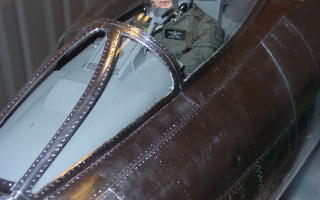

does anyone know why metalcoat shows up as a gold color when you take a digital pic of it. the same thing happened to me
Old 11-30-2002 | 02:50 AM
Kevin Greene's Avatar
My Feedback: (85)
Posts: 3,037
From: Jackson, TN
Default Digital Pics
Jetmaven,
It's all in the lighting. Notice in Scott's pics that where the flash bounced back into the camera the reflection of the surrounding Metal Coat is silver. The flash is a very white light. His overall ambient light is probably incandescent. Fluorescent bulbs come in cool white, daylight, soft white, and etc. Cool white fluorescents usually show up as a greenish light. The remainder of the fluorescents that I listed will show up as amber. The pros will use a very white light in conjunction with silver or white backed reflectors. The auxilary flash units used to spread the flash out to a larger area are also reflected by silver or white reflectors. The walls in a photo studio are also colored to give off a certain color of reflection. If you want it to show up as silver then move the model to an all white room and use the whitest light that you can find easily. (Halogen) This should help.
I'm not a pro but an amature photographer. The real pros could probably add more to this....Kevin
PS---Scott, your airplane is becoming a work of art!!! I can't wait to see it in person. Kevin

Default Lighting
Kevin,
Actually halogen lamps are very orange ( most around 3200 kelvin). Daylight is actually blue (about 5,000 kelvin), most flashbulbs are daylight balanced.
Jetmaven,
The other Kevin is mostly correct though, the "gold" reflections you are seeing are more than likely caused by the metalcote reflecting the household lights which are tungsten (orange), most of the foreground in the picture is iluminated by the flashbulb on the camera which is more blue.
Video cameras (and digital still cameras) have to be "white balanced", which simply stated is an adjustment so that the camera corrects the color of the light to show as "white" (or no color at all). Most digital still cameras do this automatically, but some can be set to manual white balance.
If you were to set one of these cameras to manual, do the color balance in daylight, then move indoors (without changing the white balnce) and take all of your pictures under tungsten lighting they will all come out looking very orange. Vice-versa if you were to color balnce indoors under tungsten and then shoot pictures outdoors, all of your shots will be very blue.
The automatic white balance systems work quite well on these cameras most of the time, but as you noticed they cannot compensate when there are two light sources that are widely seperated in the color spectrum.
This is also a problem with film cameras, except instead of white balancing you simply choose film that is balanced for daylight or tungsten. The problem of different colored light sources still exists though.
In the motion picture business (in which I worked for over 16 years) we spend a lot of money and time to make sure that all of the lights that are illuminating a shot are all the correct color.
I can suggest some movies to rent if you would like to see some examples of poor color correction. Although, none that I have worked on of course.

Your Flite-Metal application is looking better and better. Glad you took my advice and laid off it for a week or so. Flite-Metal can in some ways become too much of a good thing:^) Customers get a little carried away sometimes...literally!
Your rivet detail is looking nice. You're beginning to give Joe Grice a run on the title for my most excessive compulsive customer. Are you ready to announce which of the schemes you are going to replicate?
As for the goldish tone. That's two things...digital abarations from a white balance that's being driven nuts by the blue white of the camera's flash unit and a red shift source in the room...probably a regular incidescent light in the room.
Looking forward to adding your F-100 images to the Flite-Metal customer aircraft section when its finished. I still think you could have converted it to an F model easily... :^) The El Paso F-100 is one heck of a scheme!
