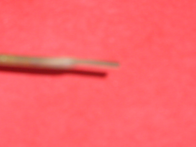

You can use perfectly gas-oil (diesel) fuel. See the smoke tail on my ex-Viperjet (
) at full speed on the below picture.And as per the sprayers.....insert a flat piece of aluminum from a Coke's can at the sprayer tip and using a wise, compress the tip in order to reduce the gauge....do it with the last 1 inch of the tip....then remove the piece of aluminum.
This way you will increase the pressure when pumping, you'll get a more eficiency spraying action and you will reduce the amount of liquid necessary to produce the same smoke tail with more liquid.
Also is important that the flat face of the sprayers tips are oriented facing the turbine rear cone.
I have not try this with electric pumps....just with air....But is the asuming your pump can raise the preasure the ~40 psi as Jetcat's fuel pumps does....then you have a good chance. My suggestion is that the made a test using first a piece os 1/8 inch brass tube...

See the above re-post picture of the sprayer tip.....Install your sprayers so the turbine trust & heat hit the fat face..You want the spraying action to be like bellow picture....specially in a King Cat where you don't have a trust tube.....

The sprayer works great that way, but keep in mind I use air pressure (60psi) instead of a electric pump. Anyway and as I said before in this thread, assuming your pump can build up at least 40psi (??) my guess is it will work.
Anyway, take a piece of 1/8" brass tube and do some testing before making any mods to the SS sprayers you have, and instead of spending money in smoke oil, go with diesel. For the testing you don't need the turbine....When I tested mine, I got an spray action of about 15 feel long and sounded almost like a spray can. I was able to empty a 8.5oz tank in less than a minute at 80 PSI,,,,that's why I reduce the pressure to 60psi.
If you don't get similar results, then play with the sprayer nozzle....you can reduce the length of the flat tip or you can increase the gage.....etc, etc.
