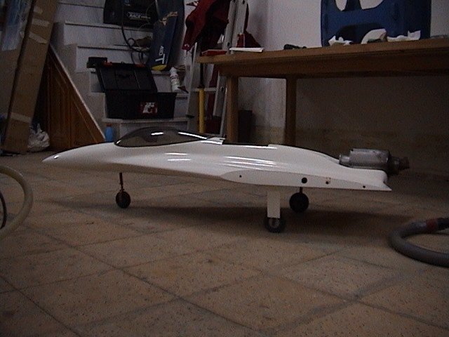

that is my hotspot,
and homebuilt kj66

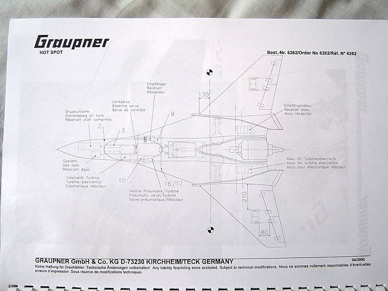

I PM'ed all the guys here, and the guys who responded, didn't have the instructions. (It's an old thread) But, after searching the web for an hour... I found the original Gaupner instructions... and a very nice "Un-Official" set of instructions. I'm not sure if they are Bob's or not... but they are very professional.
They are attached, a few posts below.

George: I've always like the looks of them... and I tried to buy a Rookie. BUT... CARF has been out of stock since last year. After I get it flying... I'm going to add a vector thrust unit.
Mike: I'll see what I can do to up-load them. (never tried to put a file on here)
JT: Thanks. I thought they were out of production for a long time. http://www.air-tech.info/html/frame.html
File Type: pdf
File Type: pdf
