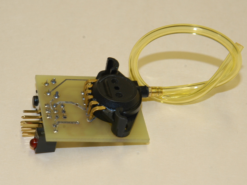

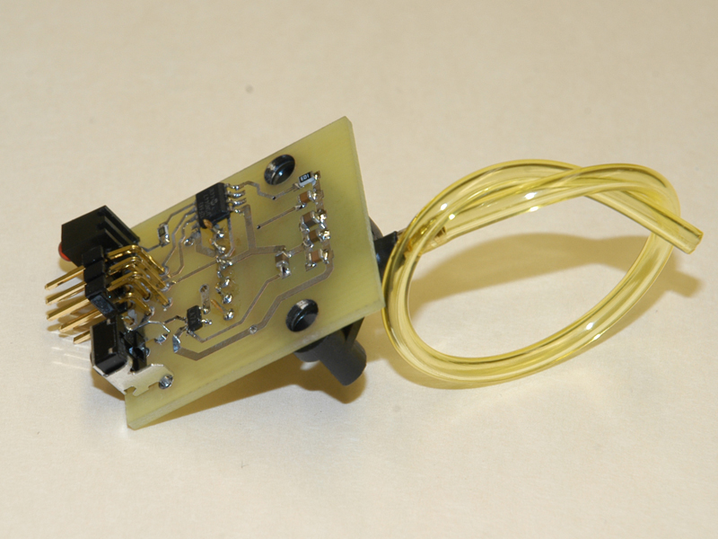

Posts: 4,586
From:
Default RE: emergency gear extension
Bob,
I have been working on a fail safe system for some time now, and I have been flying it in one of my demo Super Hornets. This system is all electronic programable, and T's into the air system. The unit is pre-set to your desired minimum air pressure level, and hooked into your retract servo line. When the air pressure drops to the level that you have pre-set, the gear switch is triggered and your gear come down before its too late. Here is a picture of the prototype unit, look for an announcememt on my website soon.
The only problem with the testing so far is that my Super Hornet holds great air pressure..........but when testing on the ground and slowly bleeding out the air, it works flawless! Another feature of this unit is that it prevents your gear from colapsing if you turn your radio on with the gear switch in the "UP" position.......a feature that I found to be much in need around my demo team![:'(]
