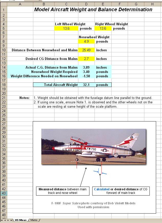

Simple is good. After an email exchange with pilott28 from a
[link=http://www.rcuniverse.com/forum/m_5267614/anchors_5267614/mpage_1/key_/anchor/tm.htm#5267614]similar thread[/link] and digging up the article, I came up with a simplified version in both US and metric flavors. A page sample appears below. I think Dreamworks will have a copy of the (newer) spreadsheet in their Tips Section.

For those of you using the 'scales' method to find the CofG, can you confirm if anything different needs to be done for trailing link u/c setups?
There are 2 data entry values of "Distance Between Nosewheel and Mains" and "Desired CG Distance from Mains". Are these distances taken from where the wheels contact the ground rather than from, for example, the centre line of the oleos etc?
Just wanting to be sure!

and last check before I do this tonight.....
The value "Desired CG Distance from Mains" - if the CofG is infront of the main axles, this number is positive and if behind them the number entered is negative???
Mark
Mark
#36
Yes. Sometimes people do taildraggers. All that is going on here is to find the point where the moment ahead equals the moment behind and that point is the current Cg location.
The first time thru this will take maybe 30 min to hour to get the airplane level and get the measurements. The more accurate the leveling and measurements, the more accuate the location of the Cg is determined. Subsequent setups could be done in as little as 15 to 20 mins. This really isn't very hard. Couple of drafting squares, yardsticks and a surface to draw lines on. Probably harder to get the airplane level more than anything else.
What airplane are you doing?

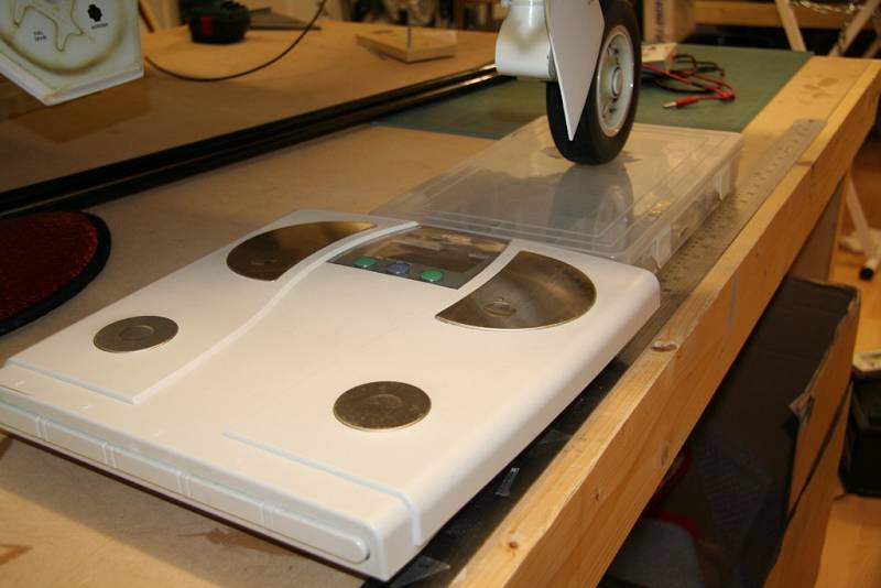

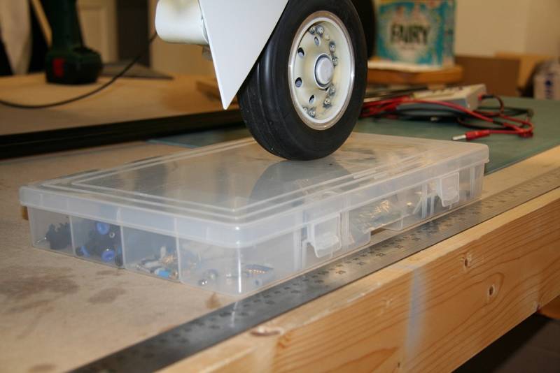

#38
Posts: 5,193
Received 1 Like
1 Post
From: SevenoaksKent, UNITED KINGDOM
Thud Driver,
It's a Skygate Hawk.
I have it up on my flat building board. Using a set of pretty accurate digital bathroom scales and placing the model up on boxes the same height as the scales.
Rgds,
Mark
Rgds,
Mark
#39
Nice!
Just a note. With oleo's, nosegears that raise/lower the nose slightly, and such, raising the mains to the level of the scale usually doesn't make the fuselage level. Yours looks pretty good in that respect, but I try to find a place on the fuselage where I can use a level to verify it.
