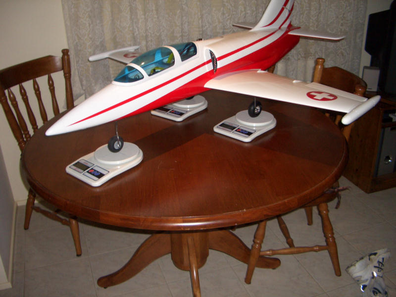

While I was in Hong Kong last week, I found some cheap digital scales (A$12 each).
I decided to try the method used in light aircraft to find the Centre of Gravity.
I put the model on the scales as shown and measured the distance between the main and nose wheels. A simple Excel spreadsheet gives the CG as a distance from the Main wheels or any other point such as the leading edge. Works for a taildragger but the model needs to be level.
It is a simple matter to add or subtract weight from the nose to get the correct cg.
Ok I know it is a bit of overkill, but I found it interesting.
These scales have a max of 5 Kg, so the model weight would be limited to just over 10Kg. Big enought for all my stuff.
Regards
Regards

Can you also use this setup to balance the laterally ? You would therefore add weight on a wingtip until you have the exact same readings on both left and right leg scales...
Would that be at least as sensitif as the fingertip method ?

I guess so, the left and right main weights are never the same. I think however the distance the wheels are from the centre will make it difficult to get an accurate measurement. I think the suspende upside down is probably more accurate.
This method of CG depends a lot on the accuracy of the scales and also the accuracy of the placement of the wheels.
And as I said it is probably overkill for our purposes, but fun to do, and makes CG corrections easier.

I agree with you about the relative accuracy of wheel position.
Your idea is still great since you don't have to use the wheels if you don't want to.
You can have the scales under nose tip and wing tips more more accuracy.
I really want to give this idea a try.

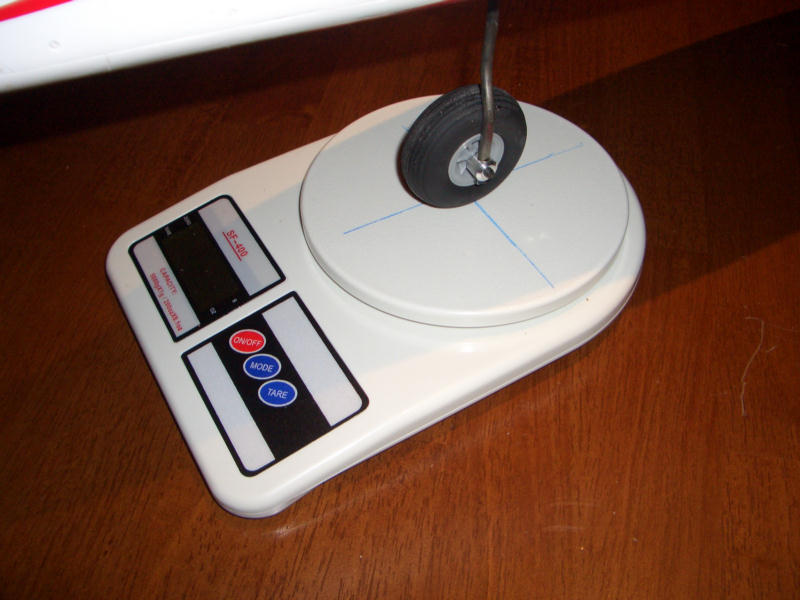

I place the model on the scales and THEN turn them on. They will show zero. When you lift the model off they will show a negative number equal to the weight. Makes placement easier.

As Long as you put the wheels as close to center of the scale, scale accuracy should be fine. There will always be a small amount of hysteresis (repeatability). I moved my batteries slightly off center to improve lateral balance based on what I read off the scales.

Re MrMike's spreadsheet - I believe that the calculation can be carried out just by measuring the distance between the mainwheels and the nosewheel. Using his data:
----------------------------------0---------------------------0
........................................262.4<-------------25------------>
.................................................2 70.4<---------x----------->
Moment about the CG = moment about the mains
270.4x = 262.4*25
x = 264.4*25/270.4
CG = 24.26
So CG is 24.26inches behind nosewheel or as given by MrMike 44.26 from nose of the aircraft

I can't believe this was so easy and accurate. I'll never try balancing 28 lb models on my fingertips again.
One difficulty I found was accurately converting measurements on the table top (between wheel contact points), up to the fuse. I ended up using a plumb line which worked well. Seeing the more recent posts I'm now going to make all measurements from the nose, using a square to align the nose with marks on the table.
This is the first time I have had enough confidence in the measurements to start pulling lead out of the nose.
Very valuable thread. Thanks TommyWatson.

I like the overkill of MrMike's spreadsheet, however, I think we can simplify this down if I did my algebra right.
Cg (forward of the main gear axle) = Gear separation (NG axle to MG axle) X Weight on NG / Total airplane weight
Think that tells you where the actual Cg is in front of the main gear. Additional arithmetic to use other reference points.
What you really want to do is set the Cg to the correct location. So if you change the above around you can figure the weight required on the nose gear to set the Cg. Take the plans and measure the Cg location relative to the main gear axles. Weigh the entire airplane accurately (any method). Then level the plane with the nose gear on the scale. Adjust objects in aircraft until weight on nose gear is:
Weight on NG = Cg distance x total airplane weight / Gear separation
