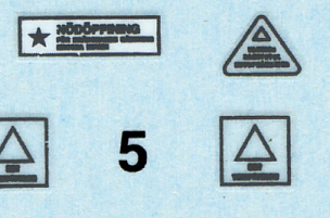

Hi,
I need swedish help. Is anybody able to read or know that letters/writings/markings?
I would also need pics in better resolution...
it is for a JAS 39 Gripen
Thank you very much...

The small square one says "HUGG HÄR" (chop here) The rectangular says "NÖDÖPPNING FÖR BRÅDSKANDE RÄDDNING KROSSA HUVEN" (emergency opening, for quick escape destroy the canopy) The triangular says "VARNING RAKETSTOL HUVSPRÄNGNING" (Warning ejection seat, explosive canopy charges)
Regards
Lars

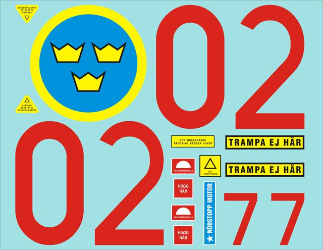

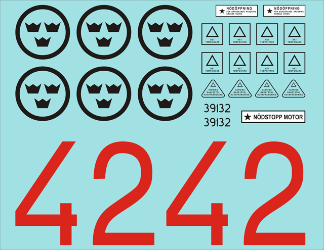

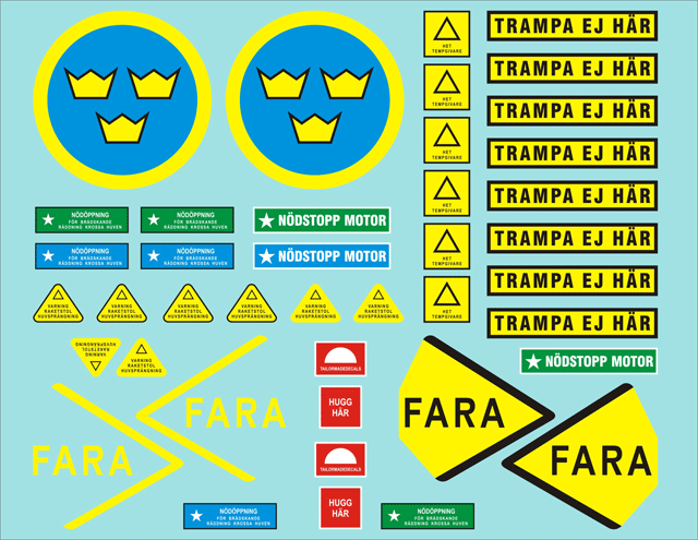

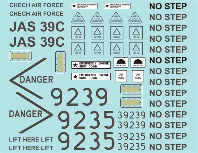

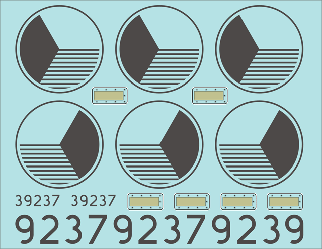

finished the work..
http://tailormadedecals.com/xtc/inde...h=2_24_107_108
