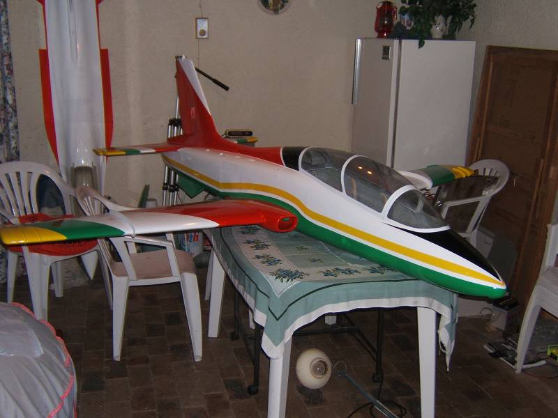

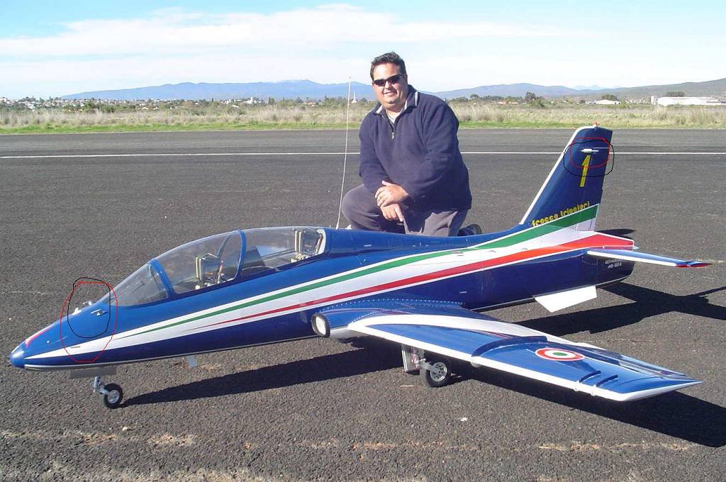

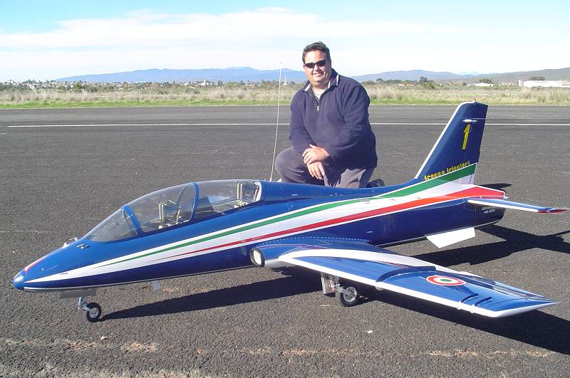

Hi guys
I`m ready to spray paint this model of mine. I will apply a gloss white colour,to the whole model and then this project comes to a halt. It will be going up for sale as a complete model. Just add a transmitter and go fly. Anybody who is interessted may send me a PM.
Regards
Craig
Regards
Craig
#54
Joined: Jan 2004
Posts: 258
From: Cape TownN/A, SOUTH AFRICA

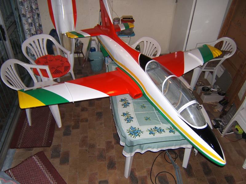

Hi Guys
I`ve just applied the first coat of white paint onto the front fuselage section. It will be rubbed down and then a second coat will be applied.
Regards
Craig
Regards
Craig

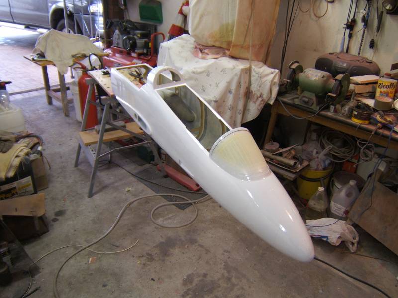

Hi Guys
I will upload pics of the radio installation etc., as I progress to the completion of the model. I shouldn`t take long now,before its ready for the maiden flight.
Regards
Craig
Regards
Craig

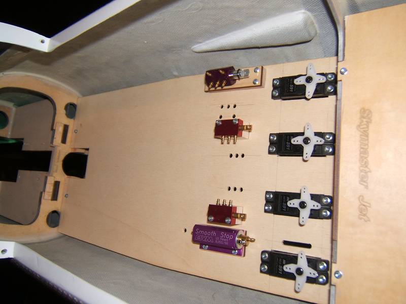

#59
Joined: Jan 2004
Posts: 258
The front equipment tray has to be lowered,when using servos and air valves,for the brakes,retracts etc. The reason for this is because there is not enough clearance between the cockpit floor and the equipment tray. I made a new plywood tray and remounted it,30mm lower than what it was. Now there will be enough room for the servos and valves.
Regards
Craig
Regards
Craig

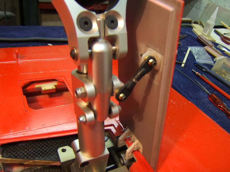

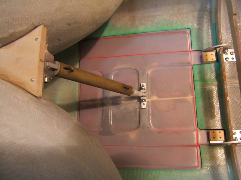

#61
Joined: Jan 2004
Posts: 258
The inner wheel doors,for the main wheels,have to be connected to the oleo legs. I made an aluminium bracket and fitted a ball joint onto it. Then it was mounted onto the oleo leg and connected to the wheel door,via a ball link assembly.
Regards
Craig
Regards
Craig

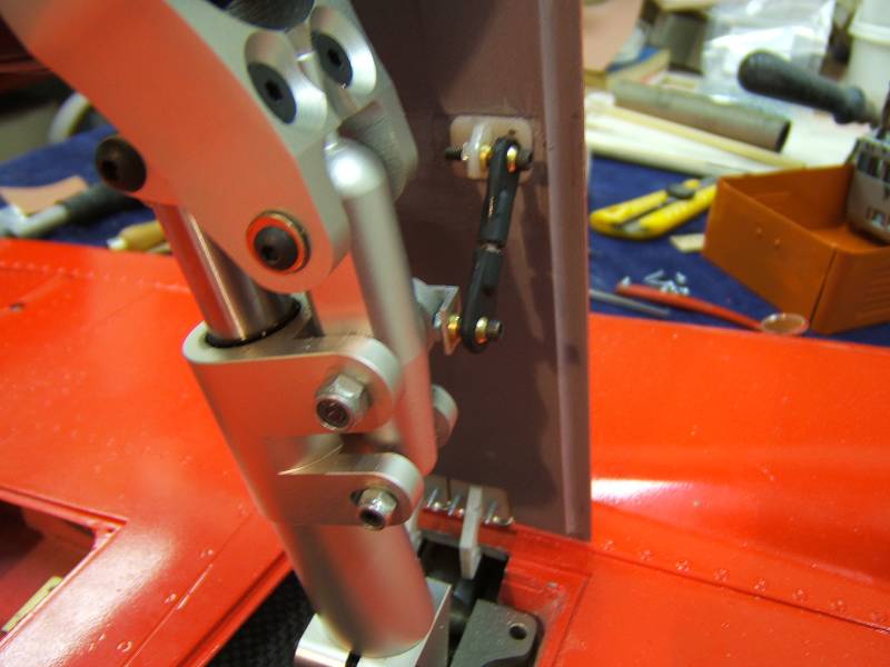

#62
Joined: Jan 2004
Posts: 258
Just completed the connecting of the main wheel door and it works very well. You have to make your own mounting brackets for this task.
Regards
Craig
Regards
Craig
