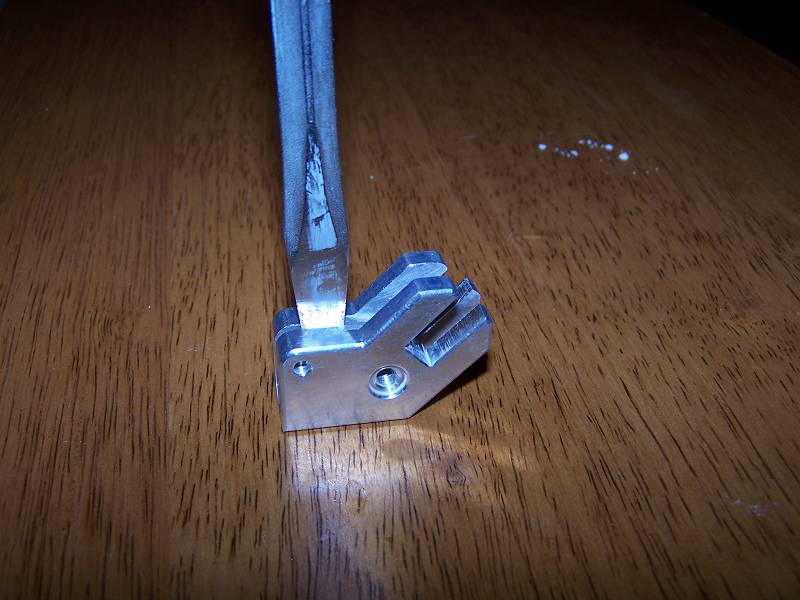

Default RE: Help with Structs-Trunion
Just take the bolt off the trunion, get yourself a wide flat screwdriver, insert it into the incision on the trunion, and gently tap it with a hammer to widen it.
You do not have to sand the strut.
Try it, it works every time. If you can put it in using above prescribed method, you can also take it off when need using the same methodology. Just make sure you do not over tighten the bolt on the trunion and put indentation or deform the strut.
To make sure you're pickin' up what the Ghost is puttin' down here's a pic.....
Kevin
ghost,
I tried that, but was afraid to damage the trunion... Maybe I should just put some more muscle to it...

Wanted to post my solution for the record...
Couldn't get the struct hole opened enough with a screwdriver. Ended putting back the bolt in the trunion, screwing it completely. Once 'closed', I used a drill press with a 1/2 inch drilling bit. This resulted in just taking out enough material. After taking out the bolt, I used the screwdriver method and opened the hole, inserted the struct and screw the bolt in. Perfect.
Tried with several structs, all fine.
Thanks for the suggestions.
