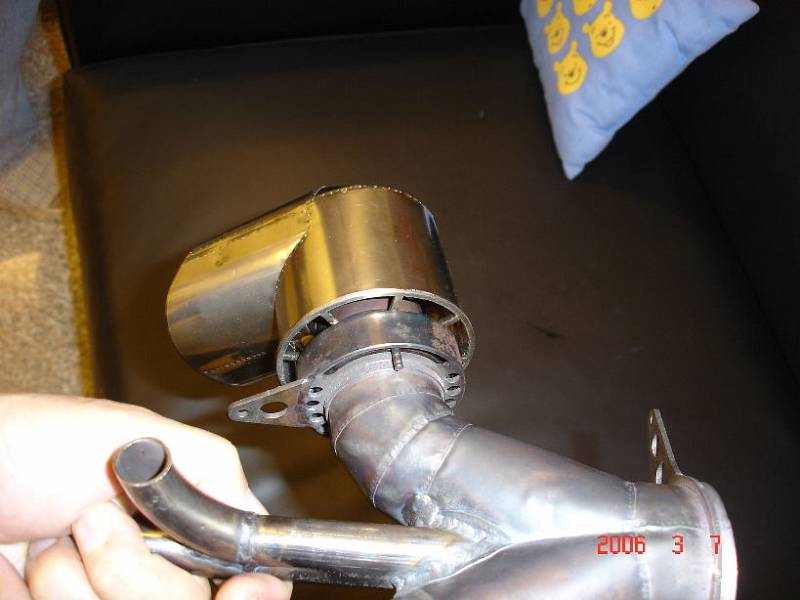

Why are pic 3 and 4 different parts... ?

you find him...and ask him :-)
I think it is the same part..... but pic 3 looks like the inner hot part, and pic 4 is the outer "dual wall"

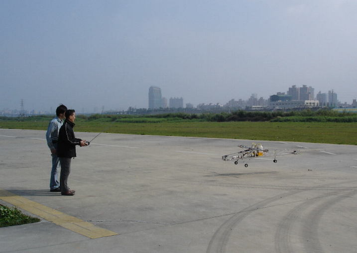

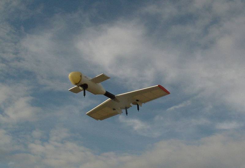

Doesnt look like the one that is flying is using the same thrust tubes as the parts he is holding. Also looks to be something on the ends of the booms-cant tell what it is-might be small props like the rig. It is not diverted thrust to the booms as I cant see any ducting. Need clearer pics.Scott

I think the dark line out to each wing tip is exactly that: duct work for reaction control jets.

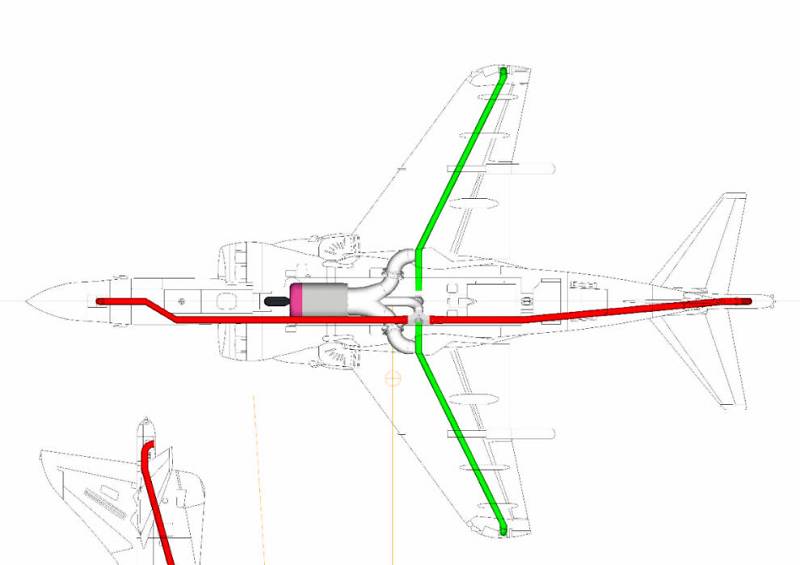

This is a prototype of VTOL power by an Artes Rhino.
At the first 2 photo, the thrust provide by a turbine mounted vertically.
4 ducted fans mounted at the tips of the plane.
The stability is provided by 3 gyros.
The last 2 photo is the thrust transform system which will be mounted on the plane in the future.

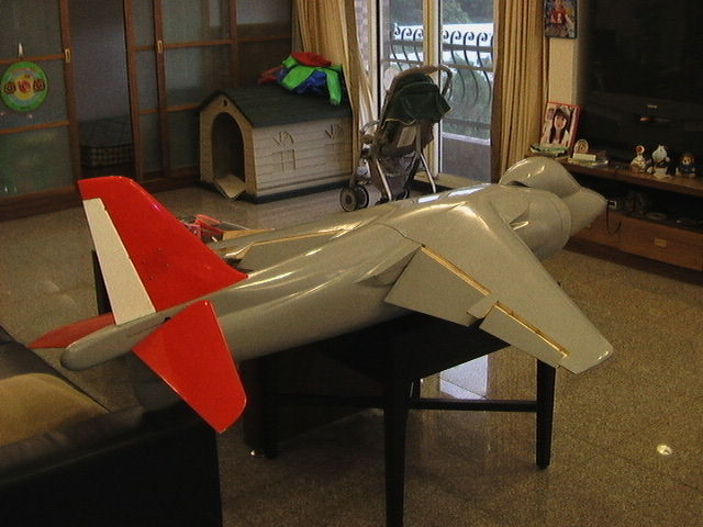

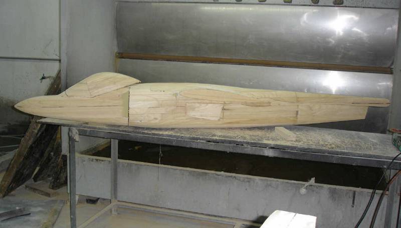

Li Kai is a modeler in Taiwan. He designed the mechanism and structure for this Harrier. It took him a few years from concept to the phototype skeleton test flight. It was quite a successful test in 2006 winter. Near one year after, he even improved some design of exhaust and balance and successfully flew the phototype skeleton version 2. He contacted Skymaster to make a shell for his Harrier.
The last picture you see was the phototype shell and fuselage that Skymaster did for him. This one will be unable to vertically take off. It is going to be set up as a normal plane. He will be using this to find out the correct CG and to also make sure that the wing folio is correct. If everything goes smoothly he will have a second phototype with his design that will be doing vertical take off. Best wishes for Li Kai.
