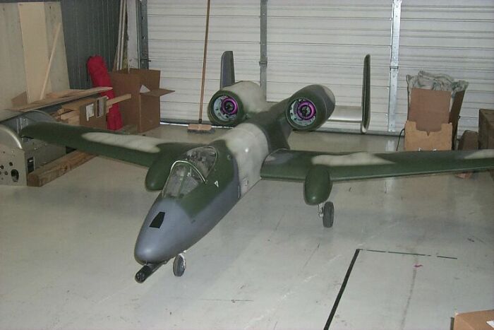

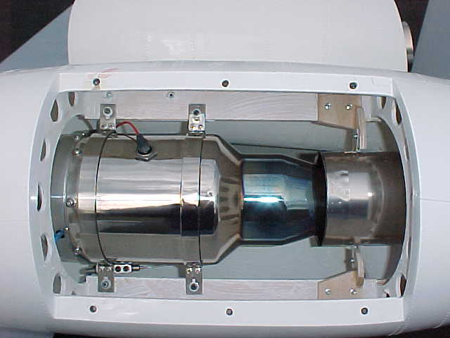

Here's a few shots of my newest baby, its the A10 sold by Roger Shipley (jetadic) ,
I have 2 JetCat P120s, JR 8411s on all surfaces including fowler flaps, twin recievers, etc etc etc.
I havent flown her yet because of brake and landing gear issues, but they have been resolved and now I'm waiting on the weather.
Turbines are setup for simultaneous spool up, port and starboard engines are setup on pots instead of 3 position switches.
I'm using a JR10X..

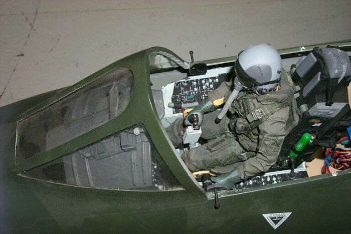

Tams Pipes, gattling gun done by Dan Gill, super detailed cockpit, and lots of engineering such as a side hatch with door for all charge jacks and 3 position switches for either turbine run or charge, also military spec mini amphenol connections for charging ECU batteries.
Done in Snow Camo scheme with PPG basecoat and satin clear.
what a beast, its really hard to hold her back at full throttle.
Its about 99% complete, I have a little detail work to do and will be adding graphics and nomenclature soon..

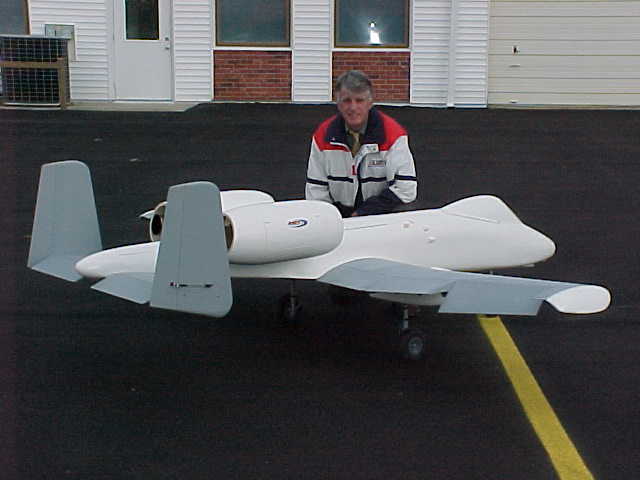

Dont mind the dust on the cockpit shot

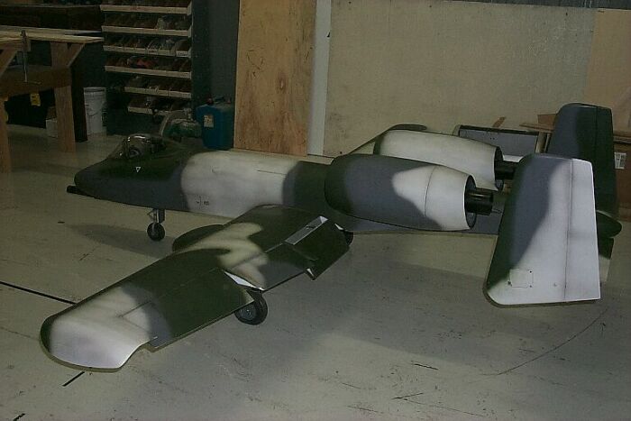

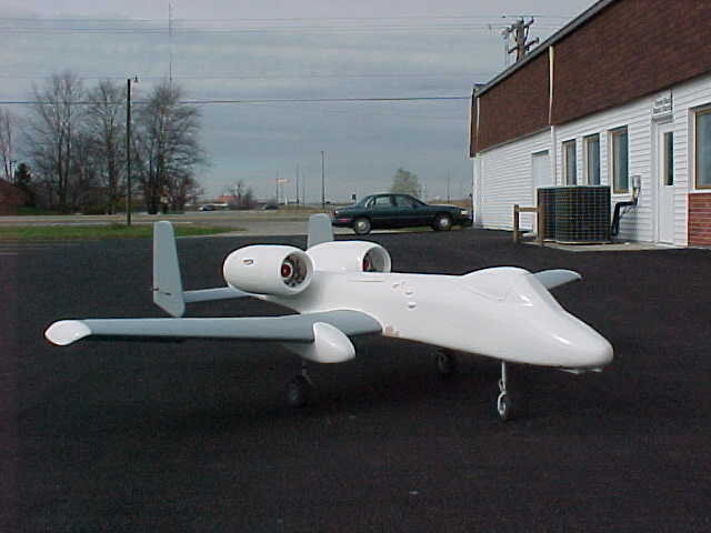

Hey Rick, I am ready for the big one....waiting on a 50+weather and a south or southwest wind.
No detailing done......just what it takes to get this monster in the air before subzero weather.
I had a wheel retainer nut to come off inhigh speed taxi in the parking lot........drilled and installed a set screw in the retaining nut.
