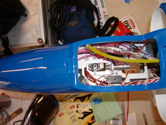

Hello, im have a problem getting a proper range check with my radio system. I have a Futaba 9c (dont say it im not switching brands after 20 years, I do like their sevos though lol) the receiver is a 9 channel brand new less than 6 months old. receiver is at least 12!QUOT! away from fuel pump, solenoids and ecu. The antenna is run on the opposite side of all the servos leads and goes out the bottom of the fuse then run along a wing leading edge. With the Tx antenna collapsed I get about 45 paces with the turbine not running. Just a side note if I get a little too far away from the model with the tx annt collapsed and deflect the elevators, ( they are on separate channels 2 and 8) the one on channel 2 will deflect before the ch 8 one deflects. I dont know why this is happening. Some one told me channel 2 and 5 only for a two servo set up.
Back to the main problem, when I run the turbine up and do a range check I can only get about 10 paces away before I have absolutely no radio contact. One step in it works, one step out it doesnt. Im going to try a base loaded anntenna now. any suggestions thanks in advance John

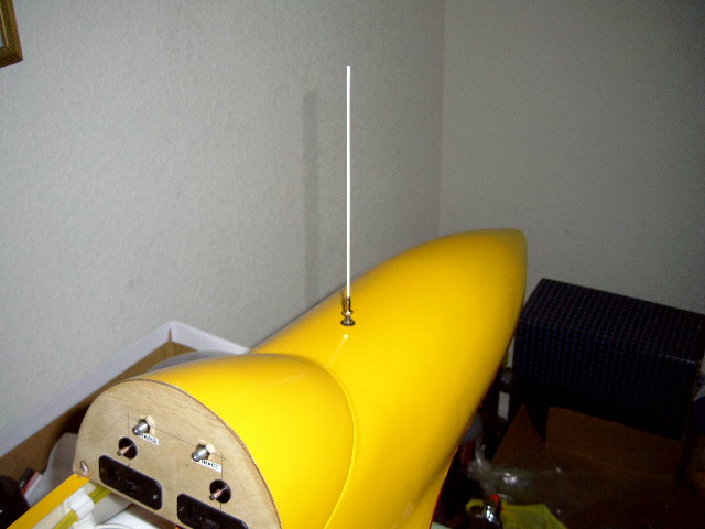

Try to do a range check with the antenna out of the fuse and pulled up like a base loaded antenna to see if you get a better range check.
I run Futaba and I'm also not changing, I also like the JR servos, my radio is a 9C and have the same receiver. I haven't had that problem before, just yesterday I did a range check on my new Viperjet and end up with the turbine off, at 100 + paces ( I quit walking away ) with the the engine running, at 105 paces before the fail safe went on and stopped the engine, I'm running the base loaded antenna made by Dean's, this is the second time I get to use it on a jet with very good success and both install.

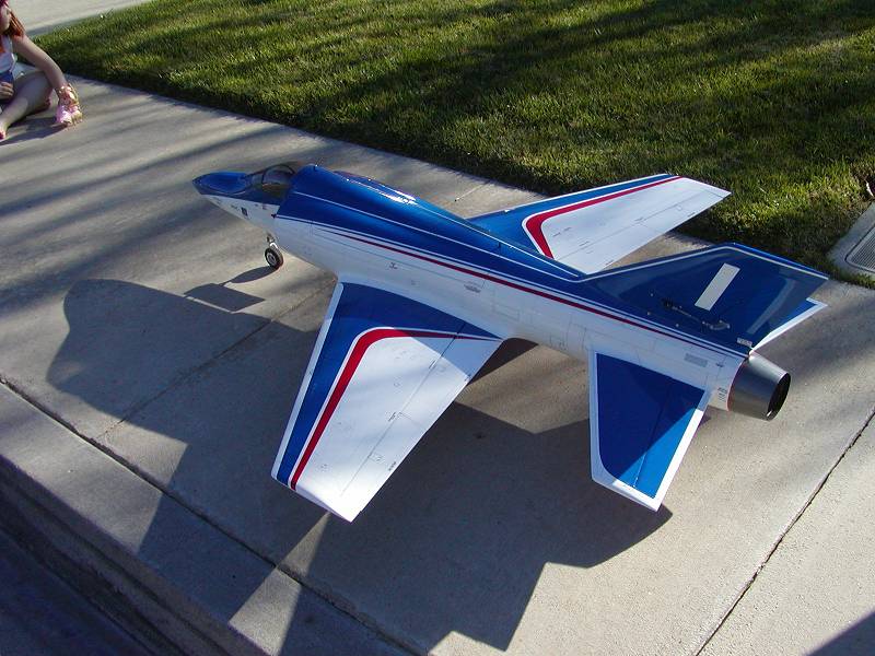

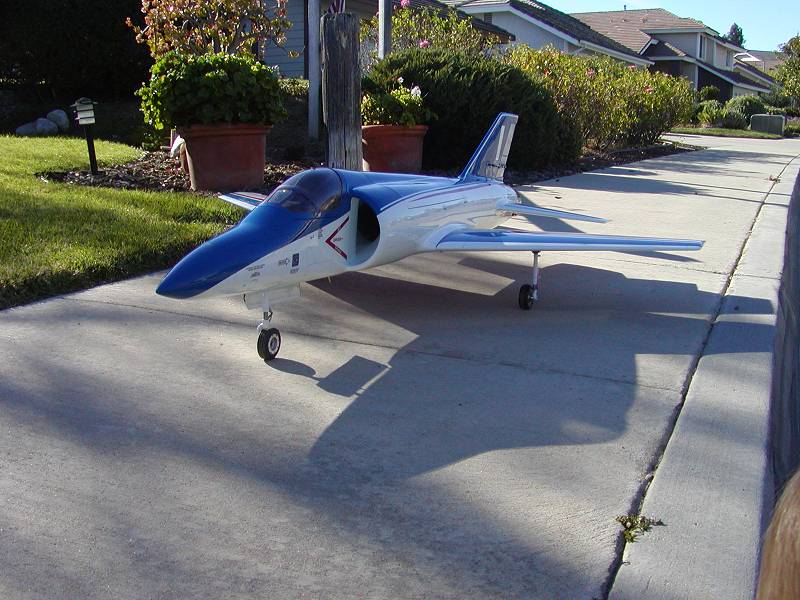

HUmmmmmmmmmmmmmmmmmm. This is a head scratcher for sure. The turbine is an artes 50 bee. the battery lead for the ecu does run parallel to a section of the antenna, but I shielded it with aluminum tape ( I think) It may just be the location where im performing my range check, (street 4 lanes plus median in an industrial park area), do you have the one piece deans or the two peice. I have a deans 2 piece and a revolution one piece in my posseion that I can try tonight. Yes when I pull up the first extension of the Tx antenna the problem go away, but I did not try a range check with it up. I will try that just for kicks. Thank you guys for the ideas. I will try and post a pic of what I have going on in the fuse. DelGato my bird is too pretty to put a toy looking whip on it, so that option is out, ive thought about that though. John

Very nice looking jet!

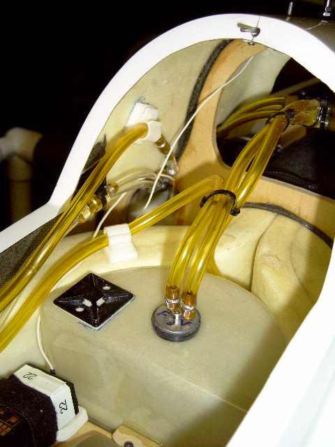

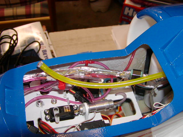

Thanks I will try that. here are some pics of my intsall, its not the best but.........not much room.

I have the two piece Dean's antenna, at the joining pin I put a piece of shrinking tube to stop it from separating in case I pull the cables by mistake and I hold the antenna cable against the airplane skin by gluing a piece of fuel tubing cut in half with ca, you can see it in the previous pictures.
