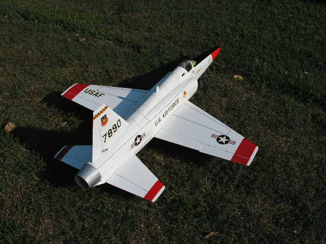

Can anyone tell me the cg position for a BVM Aggressor.

Which one?

I think this is the first Aggressor. How can i tell? It has one large hatch on top for access to the engine and the radio equipment is accesed through the nose wheel well.

Sounds like an Agressor II which I can help with. Is the TE of the wing basically straight and it has seperate flaps and ailerons?

It looks just like your picture. The wing trailing edge is almost straight and it does have seperate ailerons and flaps. Do you have a manual for it?

CG 2.75" behind the front edge of the bellypan - gear up and tanks empty!
Aileron 1/2" up, 5/16" down
Elevator 1/2" up and down
Flaps 30 degrees down

Are you building it? The CG and throws are not in the manual, they are on the plan. PM me you address and I"ll send you a copy of the manual...
