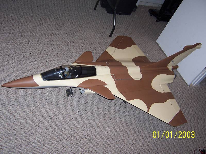

After a long wait and some problems I finally went out to test fly my Rafale. I could not ask for a better day clear blue skies and a nice head wind, but a very narrow runway here in Palm Bay, FL. Here is a little video that my buddy Bruce captured.
My first take off attempt was not pretty at all as I scraped the bottom of the wings.[>:]
The second one was much better even though it took about 1000ft to take off as I was fighting her the whole flight due to lack of elevator throw.
Landing was not the best but I take it any day on a test fight with not enough elevator.
Power Ram 500
Throws per the manual not enough.
Wow, you're persistant! That's about three and times as long as my flying field [X(]
Anyway, hope your next outing goes better.

I was about to abort the takeoff when I saw the it broke ground, so I had to put full throttle to maintian it flying.
I was commited there was no turning back at that point.

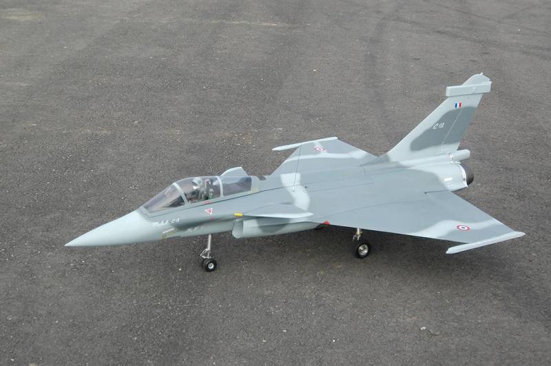

Congratulation! I am also enjoying my small AD Rafale recently.She fly great,not only aerobatic,especially she can fly stable slowly.It is very important when landing.The elevator need more(4.5 to 5.5cm individually from trailing edge) and the aliron travel need less(1.5 to 2.5cm from the trailing edge).The canad just need little,esp. when landing.C.G is 10.5cm from the leading edge of the connecting site of wing and fuselage.My Rafale weight about 6.4 kg(dry) ,how about yours?

My Rafale came in at about 17lbs with ram 500 and my elevator travel was nowhere close to yours, I will increase quickly before the next flight. Due to the fact that my elevator travel was not enough I ended up giving about 45 degrees on the carnards to be able to land her. How much fuel you have on board. I have 74oz plus hopper.

A friend of mine has one of these that flies very sweetly. It is powered by a Wren 54 mk3 and weighs only 13 lbs.
I think 17lbs is a lot for this model. Any way you can reduce the weight?

Hey John
I wish that I could reduce the weight by at leat three pounds and I would be very happy, but I bought this jet used and beside changing the batteries to lithium I dont know what else to do. I already cut the inlet almost completely of to save weight. I am open to any Ideas if you have any.
