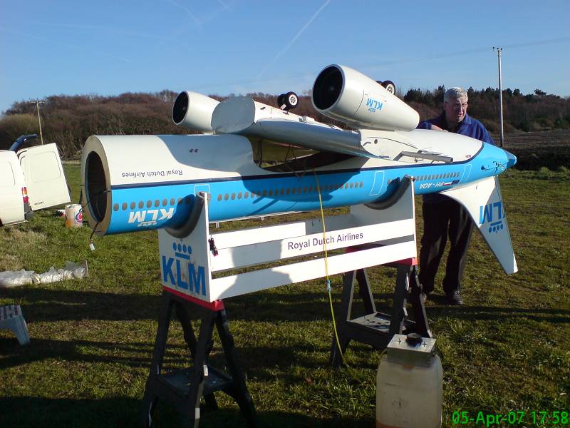

Yes, interesting comparing your fuel economy with that of the big Vulcan, your average throttle % for each flight must be far higher showing a striking comparison between the two different airframe designs.
Pics attached.

Indeed. This is why it is quite pointless comparing fuel burns of jet engines when the airframes are different. Mine is nearly twice that of Dave Johnson's big Vulcan because he is, on average, using lower power settings reverting to full power for those big climbing turns and gliding at low power thereafter.
Remember, too, that wing-loading is a factor; I have 45 sqft, Dave has something like 70sqft. Take-off weight of the Hunter is 170 lb i.e. ~3.7 lb/sqft, the Vulcan is 150lb i.e. ~2.2lb/sqft - a significant difference.
Being a good Lancashire lad you know '--- tha get's nowt for nowt ---!'

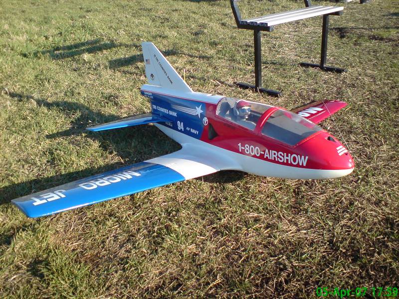

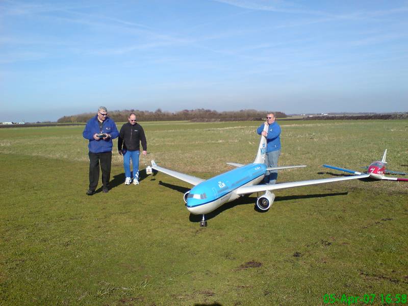

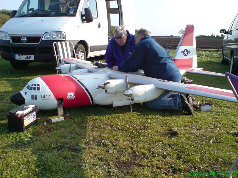

Interesting info., next time you fly the Hunter Keith plug in your Data terminal and check the last run time on one of the engines, I'll bet you will be surprised at the amout of time between startup and shutdown, I'll bet it surprises you and is a lot longer than the 6.5 min flight time
I generally time 8-9min flights with my Rookie but total run time is in the region of 12mins+
We were out flying with Dave at Halsall these past 2 weekends with the big Airbus and his C130, both fly like on rails.
