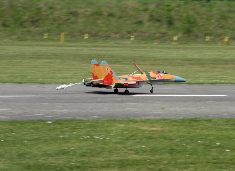

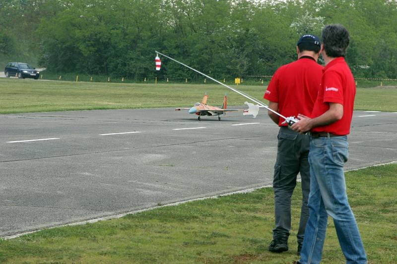

Old 05-11-2006 | 02:42 AM
Joined: Sep 2005
Posts: 74
From: Siena, ITALY
Default RE: Drag Chute
We do a system like you say.
One serve release the chute and one servo is for safety. If the chute open in fly , we release.
It' s working very good !!
