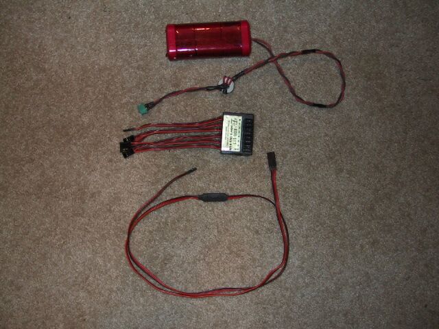

Hi Mark:
I answered you on the Jet List before I saw your post here. I am building a Boomer and, have used in the past, and will use Andy's Opto-Isolator with his 60 strand/22 gauge wire with his excellent connectors.
I have used and continue to use Andy's in-lead chokes as well, and ferrites. They all work, but the Isolator makes a clean install on the Boomer.
To be absolutely safe, Andy recommends some sort of RF suppression on any lead over 36" long.

Here's the photo Mark.....
I still like the isolator. This Boomerang problem is faced every day by the 40% Giant Scalers with their long leads and (10) or more 8411's all going at the same time on large surfaces, and lot's of them swear by it. I have one in a big F-15 that I have. Works flawlessly. You can make up your own leads, or have Andy make any length you want.
Actuall the battery backer is icing on the cake. You can have almost perfect redundacy with two packs and switches thru a Y-connector--I know some guys will claim it can't be done, but Giant Scalers do it all the time. Lots of post on this subject on Giant Scale on RCU and on the Battery and Charger section as well. The backer just balances the current draw-done more evenly between the cells, and protects one pack in case there is a dead-short in the other pack or switch.

The power wires are via 22 gauge high flex wires.
Have current issues with short range checks on 27% Extra. I tried five new RX (different brands) and three major TX all with similar results. Long metal push rod in tube to throttle replaced with nylon tube in tube increased range check by a couple of feet.
Now trying different forms of chokes etc.
Information found =
RF Noise in Audio, Video & R/C Systems - chokes.
http://www.vantec.com/noisein.htm
RF Noise - Solving the Servo Jitters
http://www.charlesriverrc.org/articl...rvojitters.htm
Jamara Snap Shut Ferrite Choke RF choke. For stopping interference along long servo lead runs. 3 sizes available hole diameter 3.6mm, 5mm, or 7.5mm
http://www.sussex-model-centre.co.uk...Choke-1989.htm
Multiplex : http://www.multiplex-rc.de/ - click the English flag, then on search panel, go to products and then to MISCELLANEOUS and scroll down list to =
Ferrite ring for separation filter 5pcs. #85131
Separation filter lead (UNI) #85035 (choke already fitted)
MPX instructions for Ferrite Choke for long servo leads =
ID 8.7mm OD 14.3mm Wall thickness 3mm Number of turns 11. Fit a 100 ohm 1/8 watt resistor (black/brown/red/gold) between signal lead and pin on plug to rx and a n33 capacitor between negative (earth) lead and signal lead at the plug. jpeg copy of instruction drawings and of instalation in my large 3 & 4m gliders available in need.
regards
Alan T.
Alan's Hobby, Model & RC Web Links
http://homepages.ihug.co.nz/~atong/
