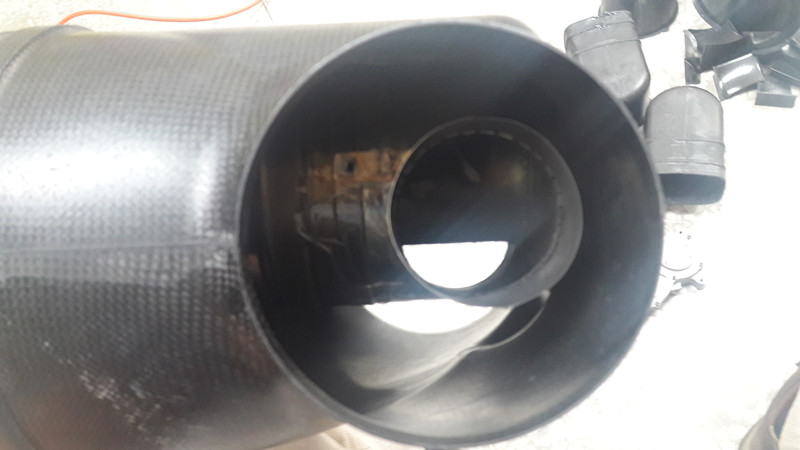

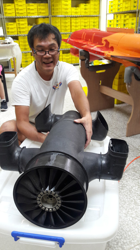

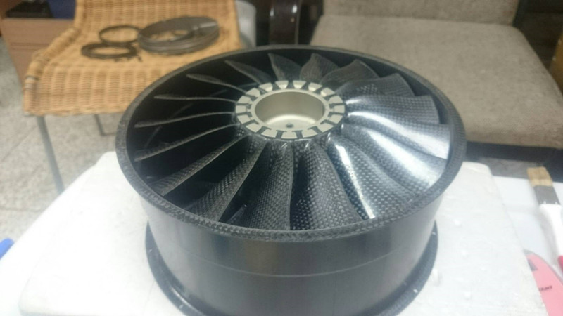

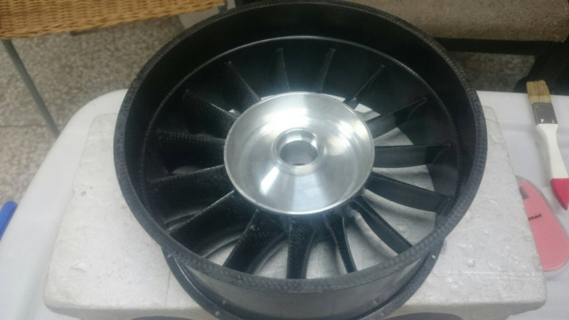

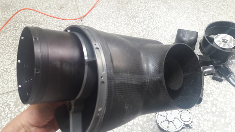

1/5 Pagasus Turbofan engine.,
what is the diameter of the fan?
diameter is 230mm

So it is going to be kind of like a turboprop? The turbine will spin the fan? Where does the heat from the turbine exhaust?

The hot gas is inside the thin wall stainless pipes which are placed in the rear carbon nozzles and high speed cold fan air in the gap will prevent heat damage of carbon parts.

Finally, the Likai got all parts of the prototype Pegasus turbofan engine casing put together. Now waiting for core engin from KingTech to make it alive.

So the fan will be spun from the front part of the turbine ? Via a planetary reduction gear ? Where is the starter of the turbine be ?

The fan is driven by a secondary power turbine, not front part of the core turbine. Basically, the power plant is a two spool turbo-shaft engine similar to kingTech K-100 TP or JetCat SPT-15 but with different gearbox and powered by a K-210 core turbine, so the starter is located in the same place as usual.

Whats the metal assembly behind the rear nozzles?

That is reduction gear box between power turbine and fan.
