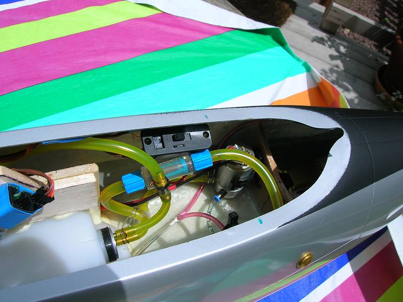

The most common cause of flame out on acceleration down the runway is air in the fuel lines. Are you using a UAT??
Set the deceleration delay the same way...decrease a tick at a time . Be careful not to get the setting to low or the motor will quit if you decelerate to fast.

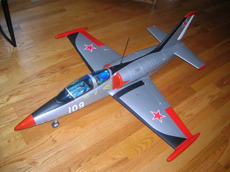

I also have problems. I have a Wren 44 gold ,on board start version in a Savex L-39, I just maidened it about a month ago, and I now have 8 flights on it. From the very begining on a test stand , Brand new, the Engine was unsteady at idle I would accellerate fine but after running it up and returning to idle the rpms were 65K at idle. I e-mailed wren and Sara had me Set the stability delay to 10 and then run the engine up and down several times slowly, then shut it down and set the stability back to the standard 30 setting. This seemed to work and the next run was fine. After installing it in the plane the first flight was good and the idle after landing was 62-63k .I thought it to be a little high, Sara said it thakes the Ecu time to learn the idle. I have just put 4 flights on it on monday night,the first flight it flamed out on the first fast pass, it made a loud swoshing noise, I thought the tailpipe came out. I dead stick landed it fine and, rechecked it, everything was fine. I then refueled and flew it 3 more flights, each flight the rpms at Idle were getting higher and higher, the last flight the rpms were 91,000, This is way too high . I need to try and get this fixed or send the complete engine back to Wren, I only have flown it 8 total flights, I am hoping this can be rectified without sending it back, Thanks Jack George.

Looks like the acceleration delay may have been my problem. I set the acceleration delay to 40 and it started and ran okay. I will try and come down one click at a time. My idle is a little unstable though. The stability delay is currently at 50. Should I go down on it?

a well knows issue is for you guys who have flame outs on the runway:
most of the time when you start the engine, some fuel could get trapped in the back lower end of the turbine.
now as you nose up with the plane , or accelerate the fuel could get sucked thru the turbine wheel causing it to flame out.
so when you started the engine it would maybe a good thing to go for full thottle first tilt the nose a bit up to let the resident fuel out.
