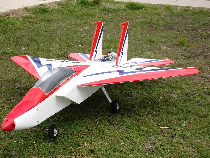

if it interests anybody here are some pictures of a Protech F15 converted to turbine
it had its maiden flight this afternoon, then 4more[
weight 3lb 14oz dry
span 880mm
turbine Kolibri T-32

Very nice!
I have one of the planes myselve and was thinking the same thing,
Can you post some pics of the installation?
Thanks!

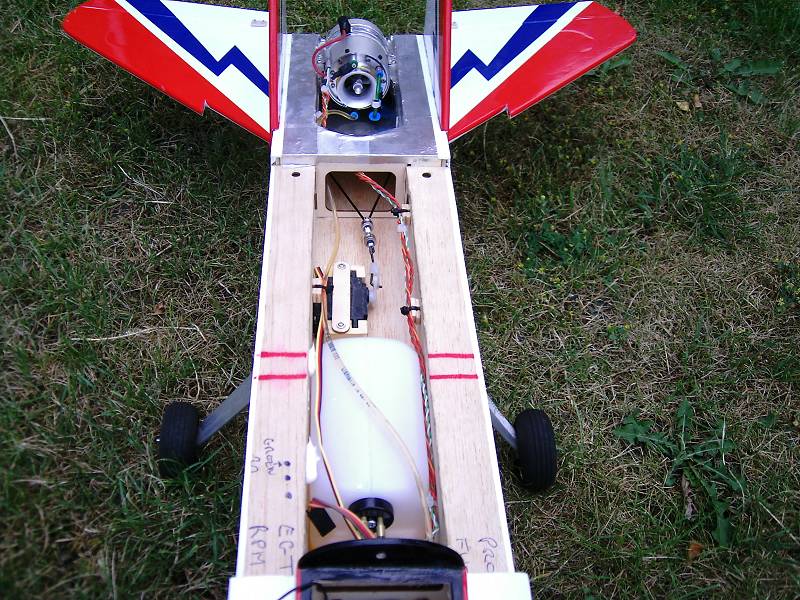

Here are a few more pictures
i sat the turbine rails on the elevator plywood plates to give correct thrust line.
cut the front hatch out and fitted both battery packsto a ply plate on the nose
no lead was required as the balance was spot on
Dubro 12oz tank on cg

I did forget to ask what did you put the C/G at?
180 mm?
Old 07-09-2006 | 09:50 AM
Joined: Nov 2003
Posts: 29
From: yorkshire, UNITED KINGDOM
Default RE: PROTECH F15
CG is at 225mm as instruction sheet , i think the Kolibri is pushing about 3.5lbs thrust
