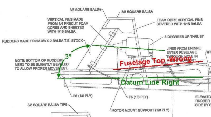

Here's a section of the plan showing correct thrust line…
Dennis

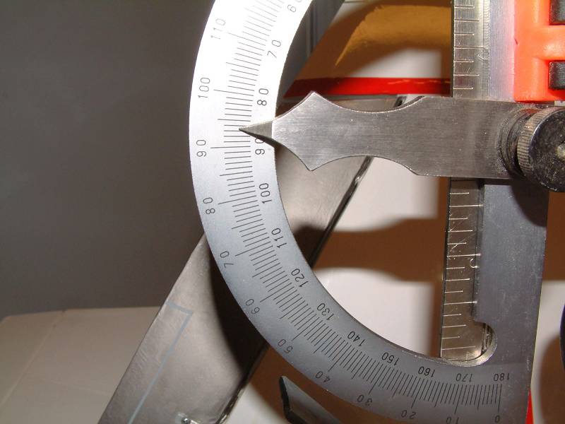

DP , i just check the old mount against the pic you sent and i'm getting 8 degrees of "what they call " up thrust when it should only be 3 degrees. i wonder if that could be driving my nose into the ground when i'm tring to take -off , warbird

The 3º angle is measured from the fuselage datum line. Perhaps you are measuring from the fuselage top? The AV8R has no take off problems (or flight problems) with the designed thrust angle. 15º flaps for take off shortens the run.

i'm using the elevator surface as the datum line . it should be the same . i know better than use the top hehehe

Sorry about that! The angle to the top looked about right for 8º. Out of interest, I measured the angle on my AV8R, and the precut engine pylon results in 3¼º.

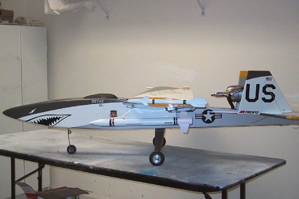

dp , would you happen to know how much positive incidence the fuse calls for on the plans?when it's on it's gear . i'm using the hoz. stab for my measure ment. many thanks ,warbird p.s. i found the first setup was at minus 1/2 to 1 degree of negitive incidence

The plan says "Slightly nose down" - looks like about 1º or so.
Dennis

Here's how mine sits…
Dennis
