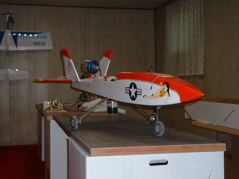

Well i'm finsihed putting the AV8R back together. i changed out the front retract with a robart unit and a robostrut. the robostrut was longer than the first wire gear i had in it so now it sits nose high. it's about 2 degrees nose up on the fuse. i was wondering if any else has flown thier AV8R with a nose high attitude? thanks ,warbird

You are fine with nose up, also make sure you have up thrust on the engine (i.e. engine pointing down since it is in the tail) to assist in the take off. The plane will fly when it is ready even if you push your elevator.
Apart from that, follow the throws guidelines as per PCM and go have some fun. The AV8R is a great trainer and very forgiving.
On landing, idle early and stay high, keep the nose slighly down and come in on final and flare just before touchdown. If the wings begin to wiggle, you are starting a stall, apply a bit of power, not much, just a touch and get it out of this mode.

i have to agree with shok. i flew it today and i did cartwheel it twice landing . both times it was caused from bouncing. the first time i greased it on the runway and hit a small bumb and it threw me back in the air . i did raise the nose and found i couldn't keep it from recoiling back in the air after hitting a small bumb in the runway. i'm very disappointed in this plane. too much screwing around to go fly. it's a total turn off for me and jets . i'm rethinking weather to go ahead or bail out and just fly my big warbirds

The first few landings I made with my AV8R it would bounce too, even landings that were 'fairly' smooth. The way I fixed the 'problem' was to raise the main gear a little. I removed it from the fuse and pulled the wheels off. Then clamped it in a vise near the upper bends and pulled down and smacked it near the bend with a rubber mallot a couple times to put more bend in it. If you do this be careful, it doesn't need much! I went a little overboard because now on takeoff the thing shoots down the runway and won't even think about flying until I give it a heavy dose of up elevator, then it leaps into the air. I make sure I let it build up plenty of speed first! And on landing, as soon as the nose gear touches down the wing is at a negative angle of attack and it's "Glued" to the runway, even when I land it a little too fast which I'm still trying to stop doing.
I'll try getting a picture of the fuselage posted and you can see it now looks like the back end of a VW beetle with the wheels angled inward at the bottom. Other than this little annoyance the plane flies just great.

Here are a few shots of the landing gear after I put a little more bend in it. You could also try shortening the nose gear and/or put a smaller wheel up there, but this plane would be happier with larger wheels not smaller, particularly when flown off grass.
Hope this helps.
