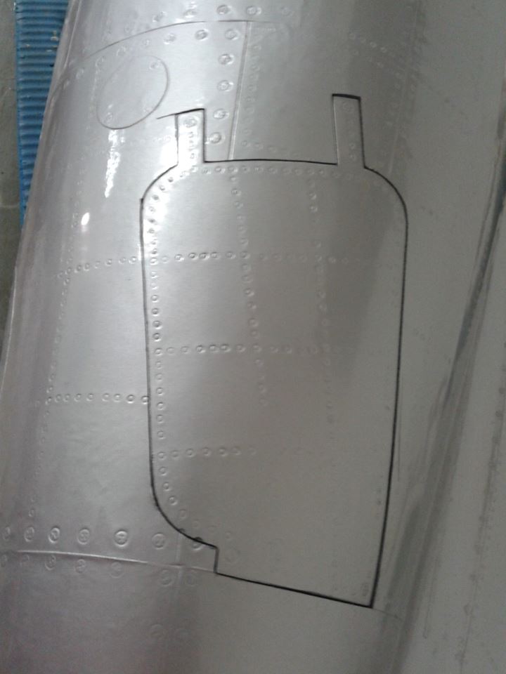

just started one for a client here in Brazil...so far so good.

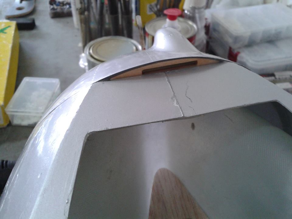

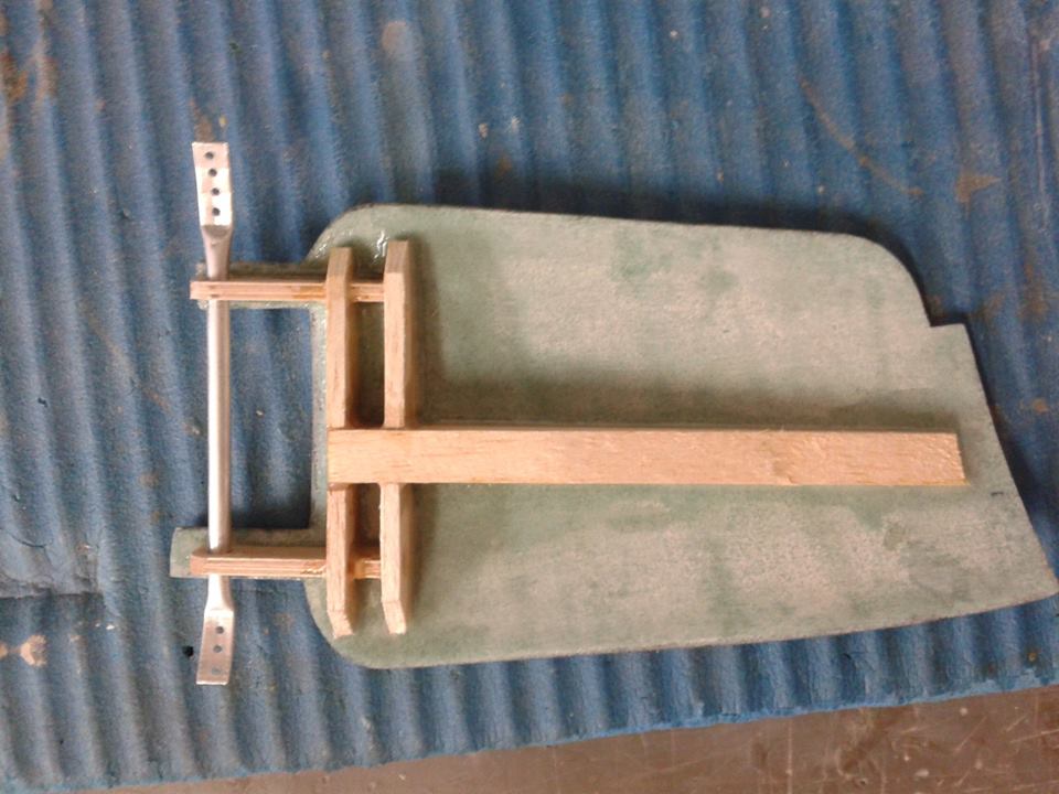

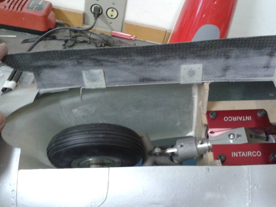

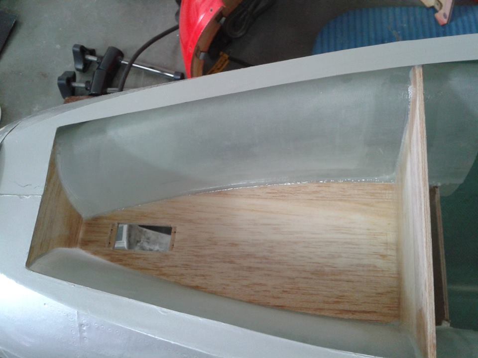

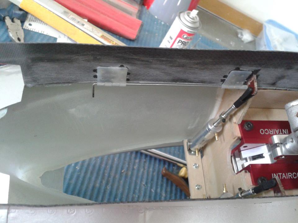

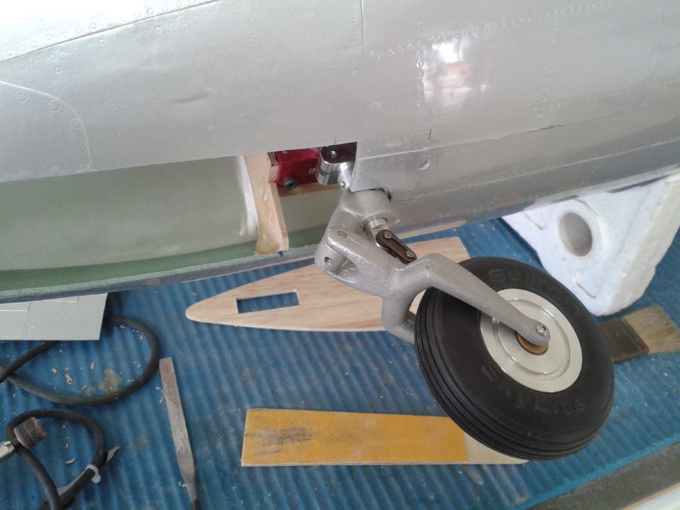

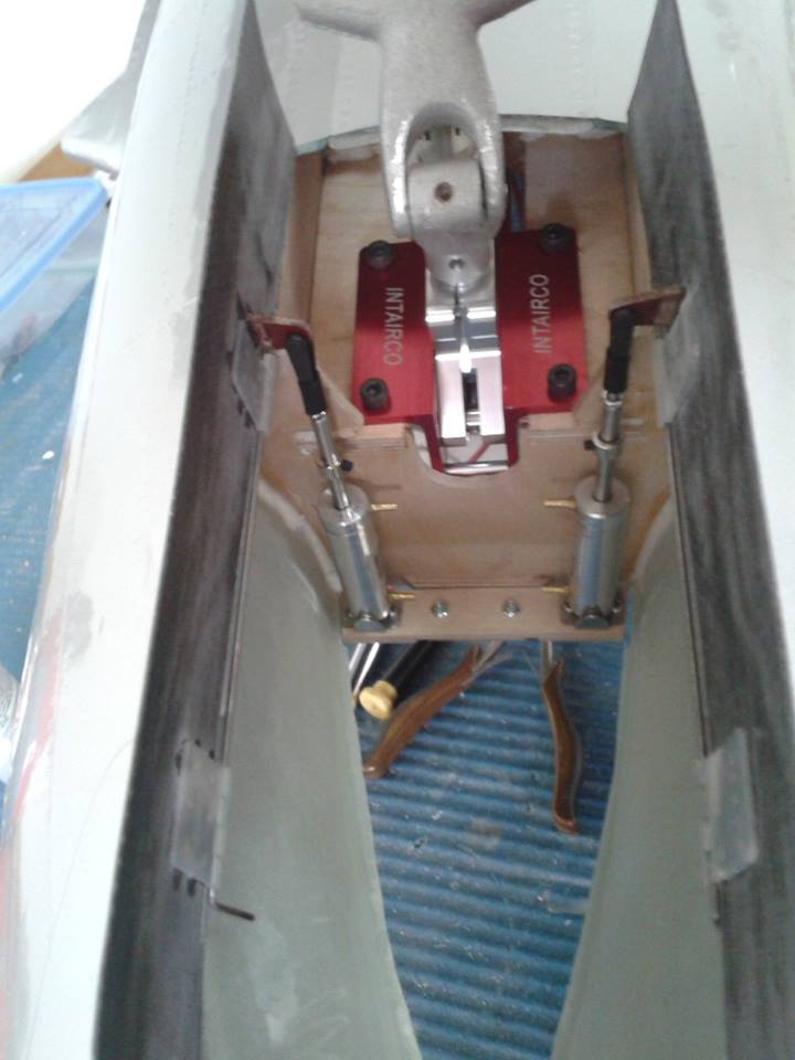

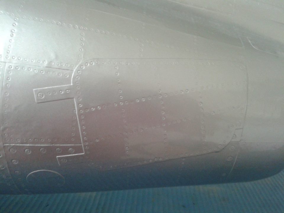

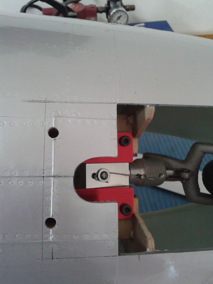

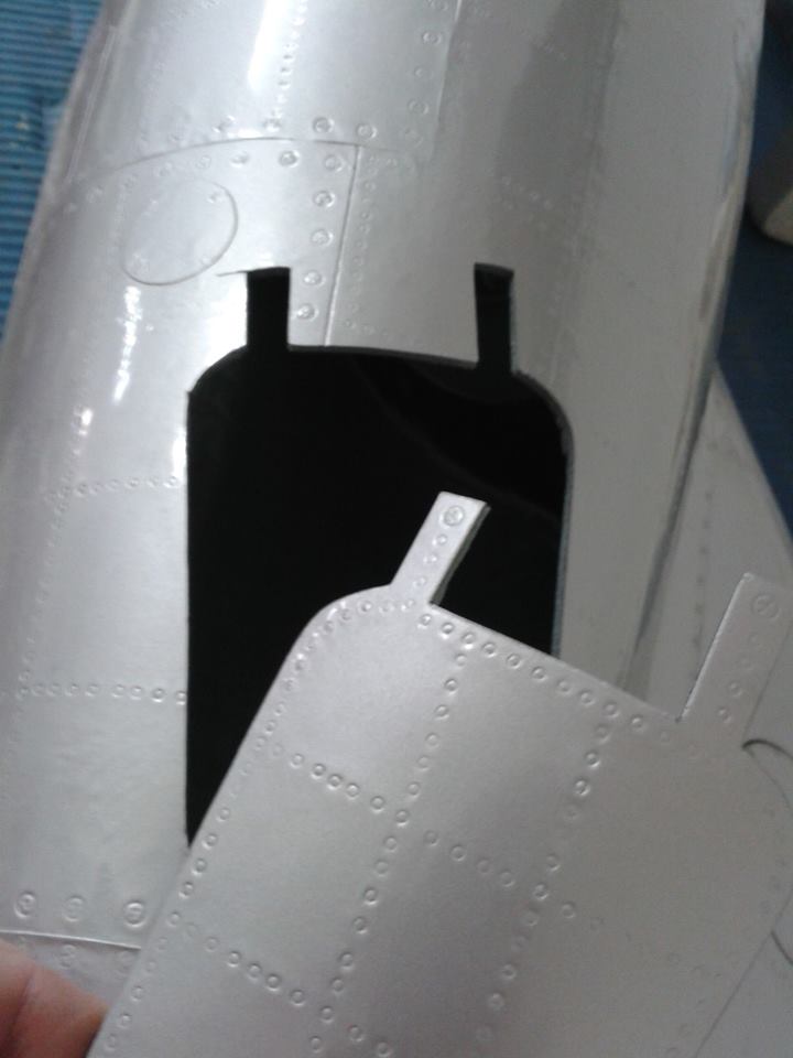

Airbrakes started, nose gear doors done, with a small mod (cut the doors longer to avoit the ugly round cut for the gear)
since the plane will be sport, looks better and neaty
changed air rams installation too, now they can easily be unninstalled

Fred, is this the new version of the kit?
Old 08-13-2013 | 05:48 PM
  #31
Posts: 401
From: sao paulosao paulo, BRAZIL
yes, the new version, and i did some mods, like using Du bro flat hinges for the doors instead of the robart hinge pint supplied and used a bigger door to hide the gear whole as well.
more to come on the next days (i am working twice a week on this plane)

I have a new kit with the new version of the intairco gear sitting on the shelf as well waiting for the build. I am not sure how to cut the speedbrake and rudder servo covers. What knife did you use? The material is a lot stronger than the previous version I think. Thanks for letting me know. Also, we have a video of a friend's Mig online with Behotec electric retracts. They are a quite good fit and work flawlessly.
http://youtu.be/OJiW2gKtRRQ
Old 08-14-2013 | 03:12 AM
  #33
Posts: 401
i used a sawing blade on the straight lines and x-acto knives on the rounded corners, several passes would do the job, just needs a steady hand and lotsa patience!

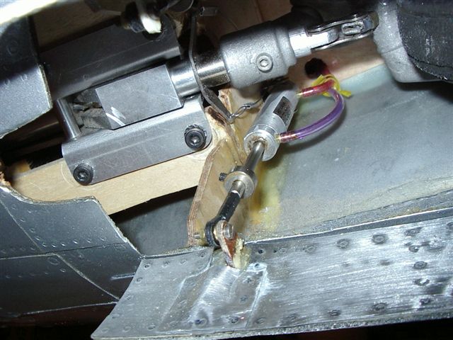

Here is my FeiBao MIG-15. Seems like all of them fly fantastic. Mine is plagued with the gears not going up once in the air. I recently added air rams at the strut to assist them. Seems to work but have not flown her since the mod.
