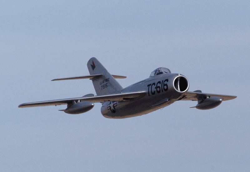

Ditto what Kevin, said..... I really love the way this bird flys, very scale like and looks awesome in the air. Iam currently flying my one with a Wren Super Sport and she flys great with amazing fuel economy of course. AUW 27 lb with the Wren for power. Go with the Intairco undercarrage and wheels, or as I did BVM mains work well and look good also.... down side is no scale cockpit, so have to scratch or mod one, BVM or CJ may work?

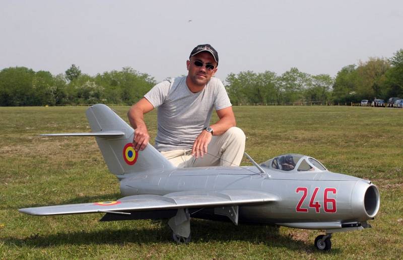

Old 08-04-2006 | 02:24 AM
Joined: Mar 2004
Posts: 1,567
From: ferrara, ITALY
Default RE: Comp-ARF Mig 15
you can visit this site
http://www.webalice.it/jetflydemoteam/MIG-15.html
and write me a mail
regard's
Christian Guidi

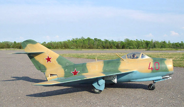

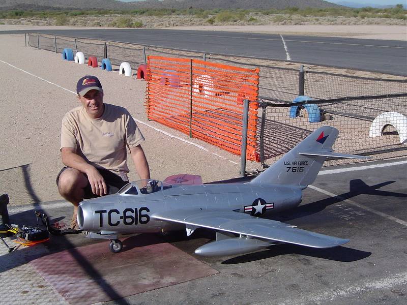

Old 08-04-2006 | 11:02 AM
Vincent's Avatar
My Feedback: (61)
Posts: 5,031
Received 29 Likes on 20 Posts
From: Arizona
Hi Hal,
I hear that intairco has templates for the wing fences. I love this jet but there are a few areas that need attention. The main gear mounts need beefing up and i found out (almost the hard way) that the elev linkage setup is not so durable. I ended up moving the servos out into the stabs and have a direct linkage to the surfaces.Interairco gear and struts have held up well with over 50 flights to date. The most predictable and easy landing jet i have owned. The outer skin finish on this jet is very realistic and makes the BVM Mig look like a toy imo. V..
ID:	501589   Click image for larger version

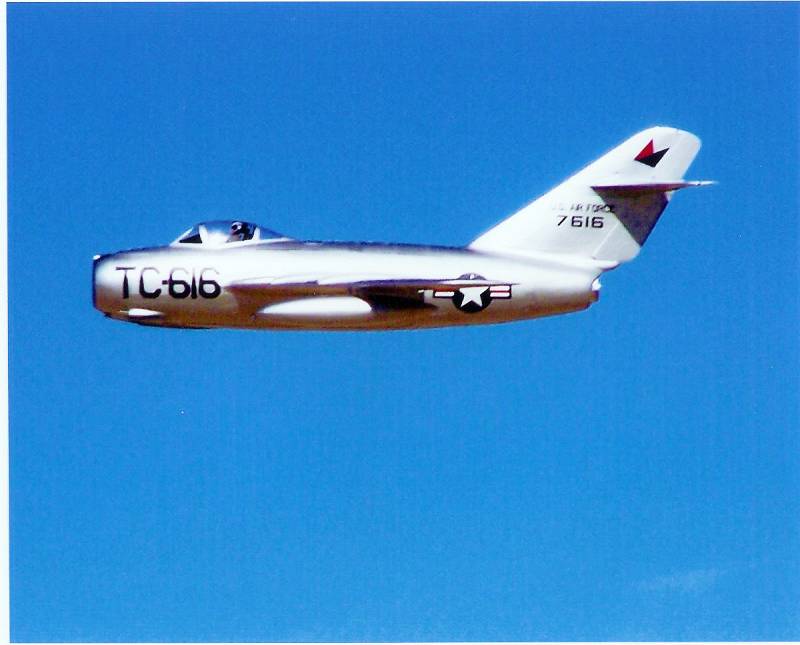

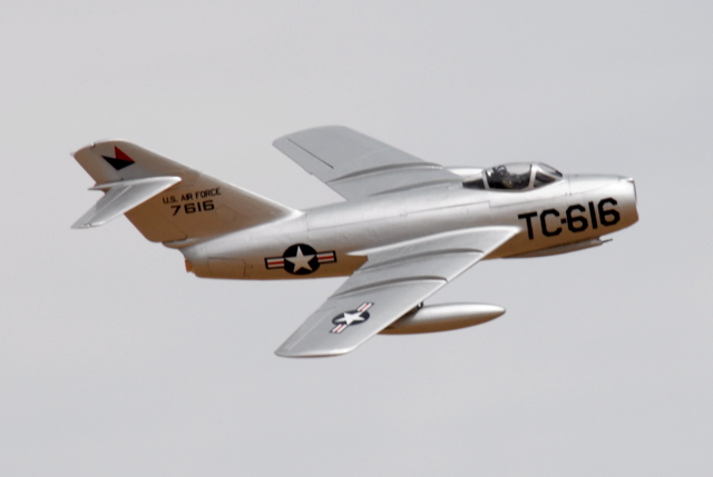

Old 08-04-2006 | 05:38 PM
Vincent's Avatar
My Feedback: (61)
Posts: 5,031
From: Arizona
Thanks Jack, my Mig is 29-30lbs dry with the wing tanks and has a Titan in it. I don`t recommend using full power on this jet with the Titan other than takeoff and climb out. The rest of the flight is about 60% stick. V..
ID:	501719   Click image for larger version

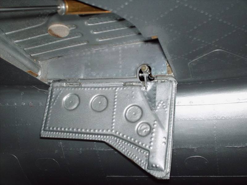

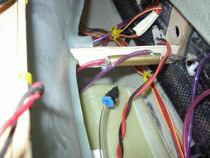

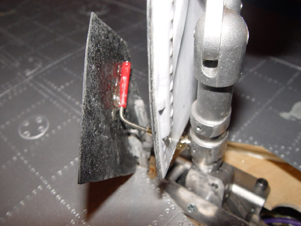

I reckon the biggest PIA with this one has been the outer gear door linkage...... I would be curious to checkout what some of you guys came up with as this linkage really has been my biggest gripe with whole model, forget average instruction manual etc its all pretty easy and straight forward for anyone whos got some experience but those bloody outer doors really tested my patience big time[:@]
I would be keen to see also what sliding canopy arrangements might be worth considering for the Mig also, probbly would need to by another top hatch assembly though to cut frame from...
Cheers-

My little outer doors are screwed down and have a slot cut in them so the struts clear. My wing tanks hide the door anyway so its not even noticeable when my gear are down. V..

Vin you cheat that sounds way too sensible... maybe I should add the tanks to my one it would save a lot of headaches as my set up aint ideal and has come loose on a couple of harder landings, I agree that you would not even notice the outer doors then with tanks fitted as you did, do you have any pics of your door set up?..... I wonder if anyone has done the smaller slipper style wing tanks for this Mig (see pic below) as they do appeal to me, sort of unique to Migs also, I might just make some I think

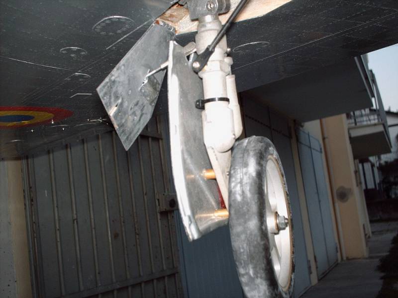

Old 08-06-2006 | 06:34 AM
Joined: Mar 2004
Posts: 1,567
here my mig
ID:	502340   Click image for larger version
ID:	502341   Click image for larger version
Old 08-06-2006 | 06:38 AM
Joined: Mar 2004
Posts: 1,567

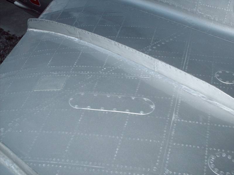

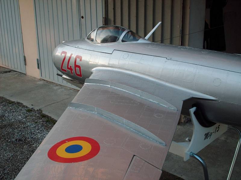

fences
playwood + aluminium 0.2mm each side
ID:	502343   Click image for larger version
