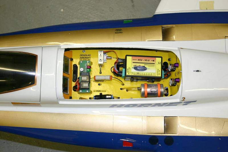

I just bought a used Yellow Aircraft F-18 Single. I want to overhaul the plane before fly it, I dont like the way the avionics where installed so I will apreciate if you can post pictures of yours interior. Also if anyone have a copy of the building manual would be great.

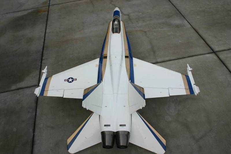

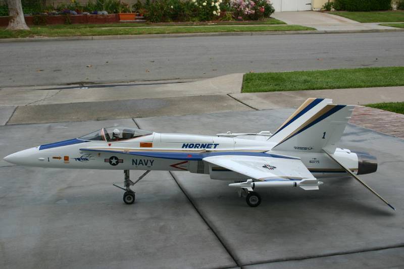

Hope this is what you need!!!! Now all I need is time!!!!!!!![:@]

ORIGINAL: Hornet 1
Hornet 1
Thank for the pics Hornet 1
Could you post a picture where the rudders servos are installed?
Also could you post your servo throws and CG?

Here is what the instructions say.....
Ailerons...........5/8 Up and Down
Elevator.........High rate....1 1/4" Up and Down
Low rate.....3/4" Up and Down
Flaps..............Landing.....50 degrees
Take off.....20 degrees
Rudder...........3/4" Left and Right
CG is located at 12 1/2" forward of the Trailing Edge of the wing at the root. the elevator servo is the first one from right to left in the picture and the rudder servo is installed right behind.
Hornet 1

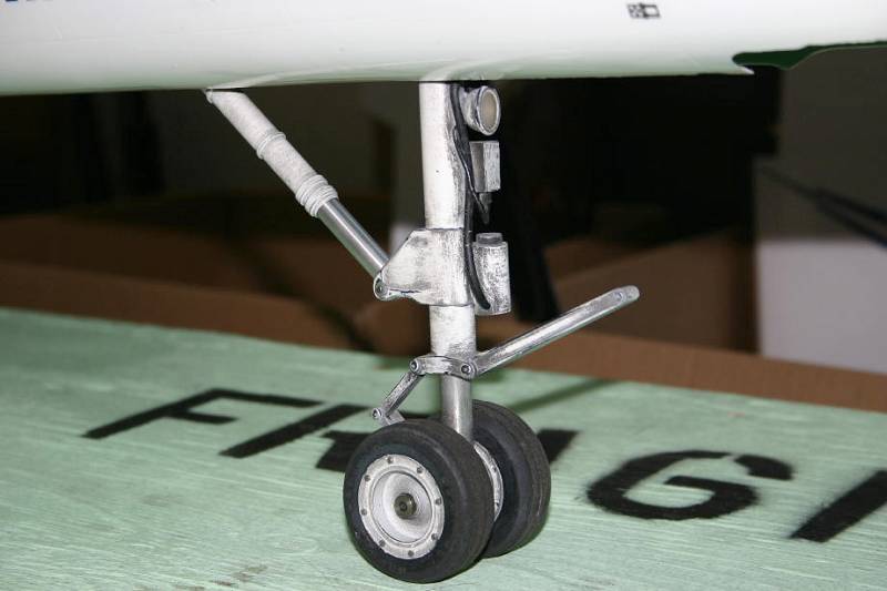

Thats a sweet looking bug! any way you could post some close ups of the landing gear struts. Did you just modify the "scale" sturts YA sells for the single? Thanks
Rich

Would like to know where you got that front strut, also or like to see some close ups of your mod. Looks great. How does she fly?

Guys,
this is a Custom RC Crafters Nose strut. Unfortunately I dont have any contact info for them..........
and the mains are YA with BVM wheels and brakes. I have not flown it yet because I dont have a waiver yet but, I just finished my boomer and I am going to try and get it as soon as I find the time.
Hornet 1
