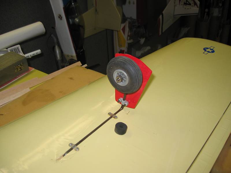

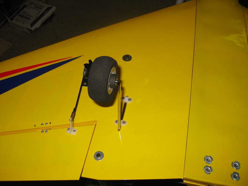

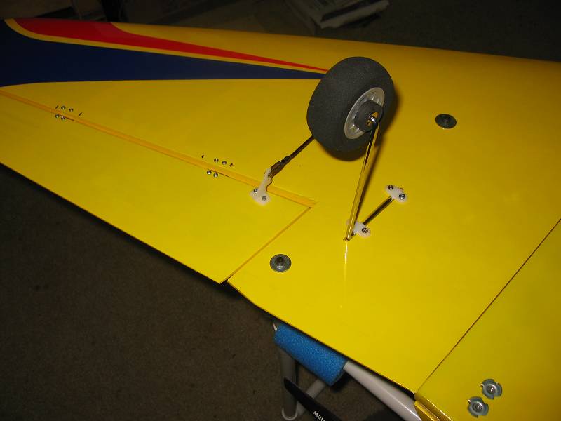

Unfortunately I did not observe the landing and don't remember brakes on the retracts. However scratches under nose and numerous breaks in the nose gear former indicate the landing roll continued into the high grass.
The pictures below show a fixed brake solution to long roll outs. The Bob Cat has not been flown but the brake solution is being used on 4 other airplanes.
Bill

BillS,,,,that looks like a good fix, but I don't think it will work with retracts...The wheel well isn't deep enough to accomadate the rubber...Other than that, it look good.
I only use rubber on one side of the wheel, sometimes on the outside collar and sometimes on the inside collar. Never tried a flat washer but it would probably work also. There is nothing precision about the brake and the slightest amount of drag is all that is necessary.

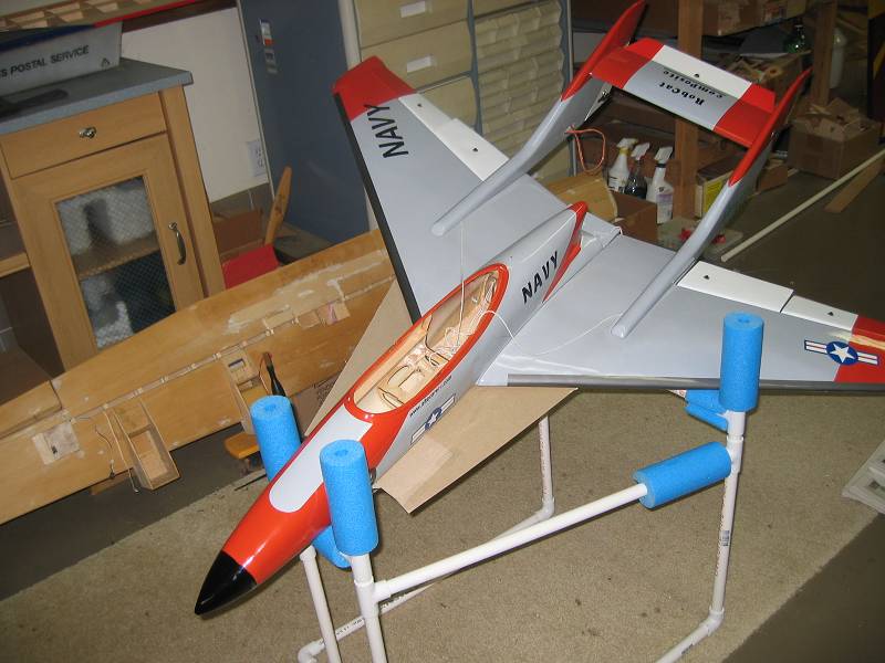

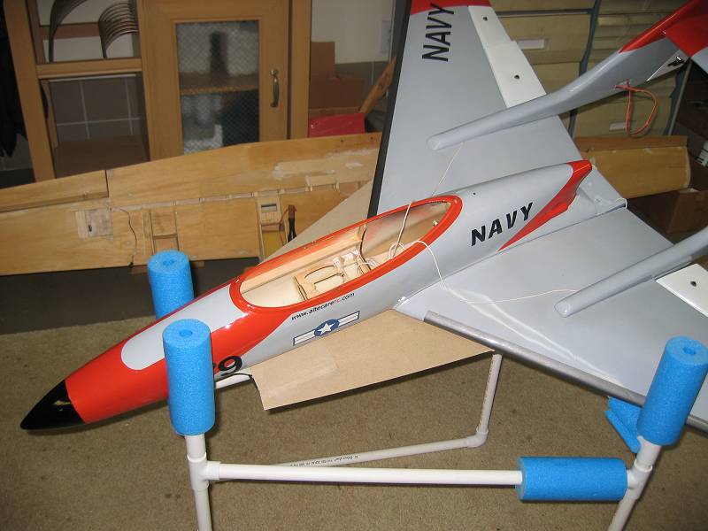

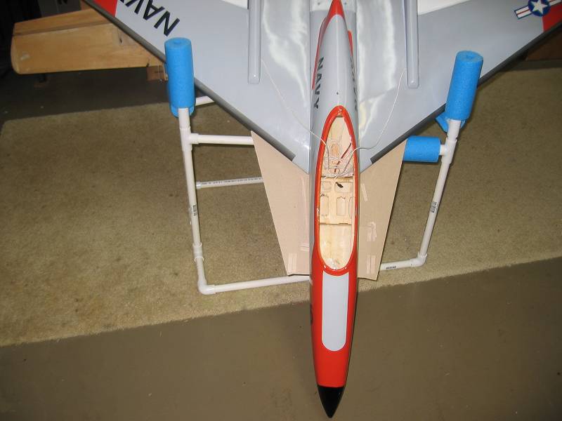

Might be a good candidate for doing away with the tail feathers completely and fly it with elevons. I don't recall anyone trying this but yours seems well suited due to the excess tail weight. It's basically a delta wing and it should work considering how pitch sensitive the airframe is to spoilerons and flaperons. In it's present state it sounds like you're gonna need more power than a glow engine can produce as prop size is limited.
Yes, power will be a problem.
I have an older ST 90 (removable front housing and hope it will run backwards) and a 12 x 8 three blade prop laying on the bench for consideration. It will probably fly with the .90 but minimum flying speed is likely to be in the mid 30's.
Your delta suggestion is interesting. The tail section weights 1 pound 7 oz or so with servos. Maybe the delta suggestion can be tested with the skinny Bob Cat first since I have zero delta experience.
What is really needed is more wing area. All recent military aircraft have supplemental wing area in front of the main delta wing. The cardboard mockup below of additional wing area might be easy to try. It also might not work. This type of conversation often results in serious breakage.
The heavy airplane is simply too pretty to retire.
As long as the plane balances at 10.3" with the tail section removed (engine mounted and ready to fly of course) I see no reason why it wouldn't fly. Elevons are just a matter of radio programming. With any experimental test there's always a risk but your "GlassCat" is already going to be an experiment with a glow engine simply due to the weight. On the maiden flight of mine I had about 1/4" of spoilerons programmed in for landing and the test deployment at low speed (with altitude of course) nearly put the plane vertical and probably would have completed a loop if I hadn't clicked them off. There's no doubt in my mind this plane would fly without the elevator.
